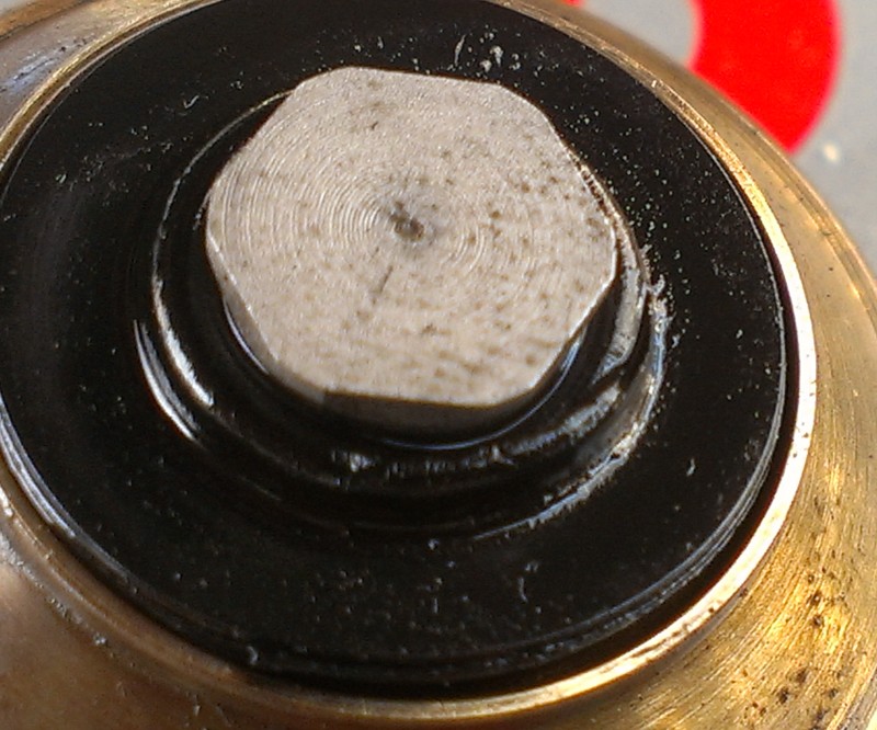

Finally got around to dealing with this - took the rad out and got the old diaphragm out. Not quite the catastrophic split I was expecting but definately split:
Still a fiddly job but not really difficult - I ended up removing the oil cooler hoses too just don't drop the little cap headed screws down there!

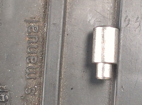

mmm... found a big gotcha...
don't attempt this job with a magnetic pickup tool and mirror!
after putting most of it back together I found this: nestling in the crap around the oil cooler:
Managed to fish it out with a magnetic thing and double checked with my spare pump in case it had fallen out which of course it had! Due to the angle of the pump on the car this little plunger will drop very easily so beware!
In the end I've put it on hold as my spare diaphragm, while not split, has what looks like the signs of the rubber starting to crack so I think I'll stump up the cash for the correct new unit... Lucas 9100-633

Every one I've seen that hs failed looks EXACTLY like that. Shiny new one looks a bit different and I'm told they dont fail.. At least, of the many I've changed so far, not one has come back yet!

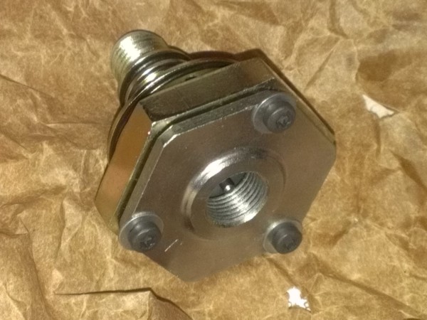

OK - got the new shiny boost kit for the lucas pump:
Got it all back together, pipes on, rad in, coolant bleed...
Car starts and appears to run ok - apart from clouds of grey / blue smoke on boost.. Doesn't seem to smoke badly on idle at all after it's started though.
Next I wound the boost compensator adjuster all the way in, then out 3 turns and this made it a little more sluggish but the smoke's still there. So at the moment I suspect it's either the turbo seals or the head gasket (again!!!) Although I don't seem to get any cooling system pressurising after a couple of minutes running from stop which I did when the HG went several years ago.
No nasty bearing noises on boost that I can hear..
The oil filter's pretty oily and there has always been some oil in the pipes so maybe the big overrun blew what were already marginal seals on the turbo to begin with.
Really ###cked off with this BX at the moment, although I do have a spare garret turbo off a bx although this one will need reconditioning I think - I've seen rebuild kits available - is this worth trying DIY and then get it balanced by a turbo builder? - Changing them doesn't look easy though

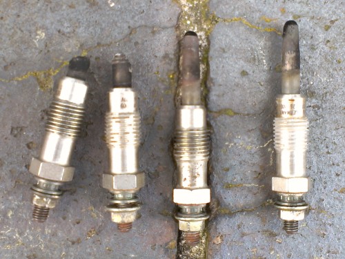

Removed all the glowplugs - this is what they looked like and hadn't been in more than 18 months and they were Beru ones too:
Is this burning out caused by dodgy injectors or the heat generated in the run away? Doesn't really matter now as I did a compression check and even with my nasty, cheap eBay tester it seems pretty conclusive.
No.1 (nearest the cambelt) barely made 100psi, all the others made about 380psi.
Think I'm looking at new engine and turbo or do a 1.9TD engine conversion or look for another TD estate...
