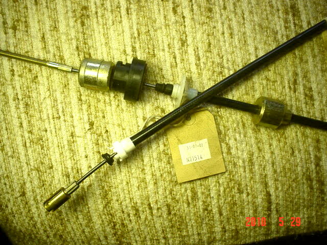

the earlyer cable just has a one piece end at the bulkhead which you just conect both ends, line the bulkhead end up to the mounting braket eye then press the pedel to the floor, this engages the end into the eye in the braket
the weight in the video is not a genuine one, it is possibly an after market version, as it is longer than the OE one which is held onto the cable end by a 10mm nut

quite so, I have infact retained the end off the original cable on the TD, whenever I change th clutch cable I remove the press end and swop it over to the new cable!

Also, the manual talks about removing the weight while fitting. As Citronut points out the currently available ones have them permanently fixed so leaving the pedal end attached and rethreading the 33mm+ other end could be difficult...

Sorry Citronut. I put 2+2 together and maybe got 5!. Both the cables I've seen inc my old one had a fixed weight. Citroen dealer told me they didnt supply them anymore, so I assumed the OE ones you mentioned were the proper citroen ones, with a removable weight, referred to in the manual, but no longer obtainable.

The removable weight cable is used on stuff like N/A diesels and the like, entirely different setup. The weight is ont he very end of the cable secured with a 10mm nut.

no Brian,it's different. Here's a picture of my old one
http://i951.photobucket.com/albums/ad35 ... dcable.jpg
I'm afraid I can't think of any reason why there should be a weight added to the cable at all...
