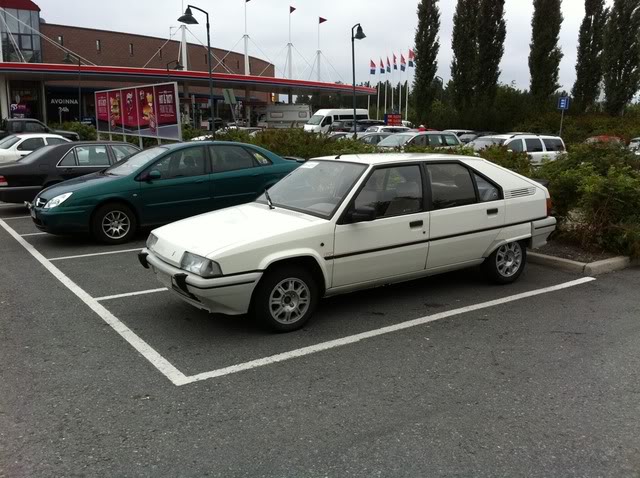

Heres my current BX project
Originally it was 1.4l carb with 4 speed gearbox and no fancy electronics anywhere :)
Spec list:
16V D6C engine
2,5" exhaust
One layer of Dynamat from roof to floor
16V interior
Front lowered about 10cm from original now with 2cm ground clearance in lowest position :)
Fondmetal 4000 rims in 15x7 size
Re: Jeths lowering project
Not really my cup of tea at all but looks very nicely done. There are some right lash-ups about but that certainly has something about it. How does it ride?

Dollywobbler wrote:Not really my cup of tea at all but looks very nicely done. There are some right lash-ups about but that certainly has something about it. How does it ride?
Well i've mde front end quite stiff so it wont rub all the time, still alot better than people with "normal" suspension :P

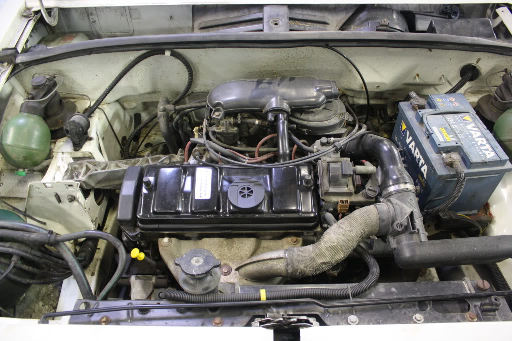

There's original engine.

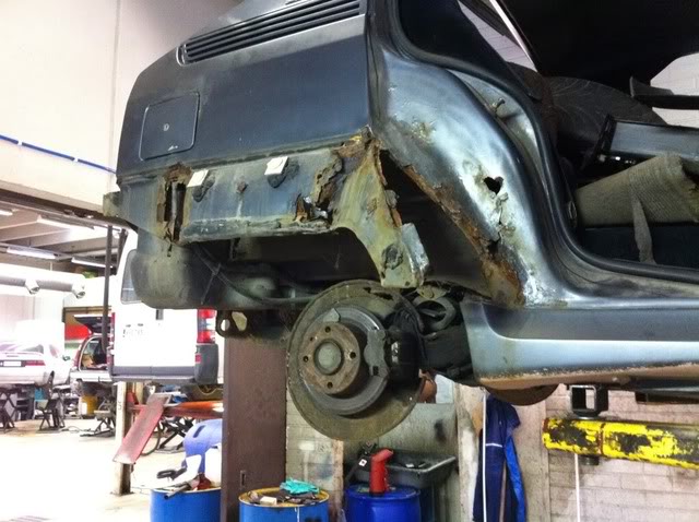

Pic of the parts car:
and the reason why i didnt repair that one

On the picture above, did you manage to remove the bodykit from the rear arch without damaging it or did you have to sacrifice the bodykit by destroying it to save the inner metal wing underneath?

Mike P wrote:On the picture above, did you manage to remove the bodykit from the rear arch without damaging it or did you have to sacrifice the bodykit by destroying it to save the inner metal wing underneath?
Mike P
Heat blower works really well, so yes, without damaging anything.

I guess on the back of the metal arch, so that the heat goes into the mastik and does not damage the bodykit?
I've managed to remove the bodykit sections from the sills before but never a rear arch.

Mike P wrote:I guess on the back of the metal arch, so that the heat goes into the mastik and does not damage the bodykit?
Yeah, heat it until it starts to smoke, then carefully try to strip it off.
