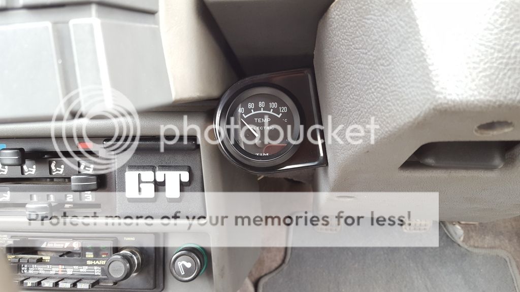

Mount and fit temperature gauge, with customised mounting pod so hopefully blends in with the dash - Ruch even put a green LED in there!

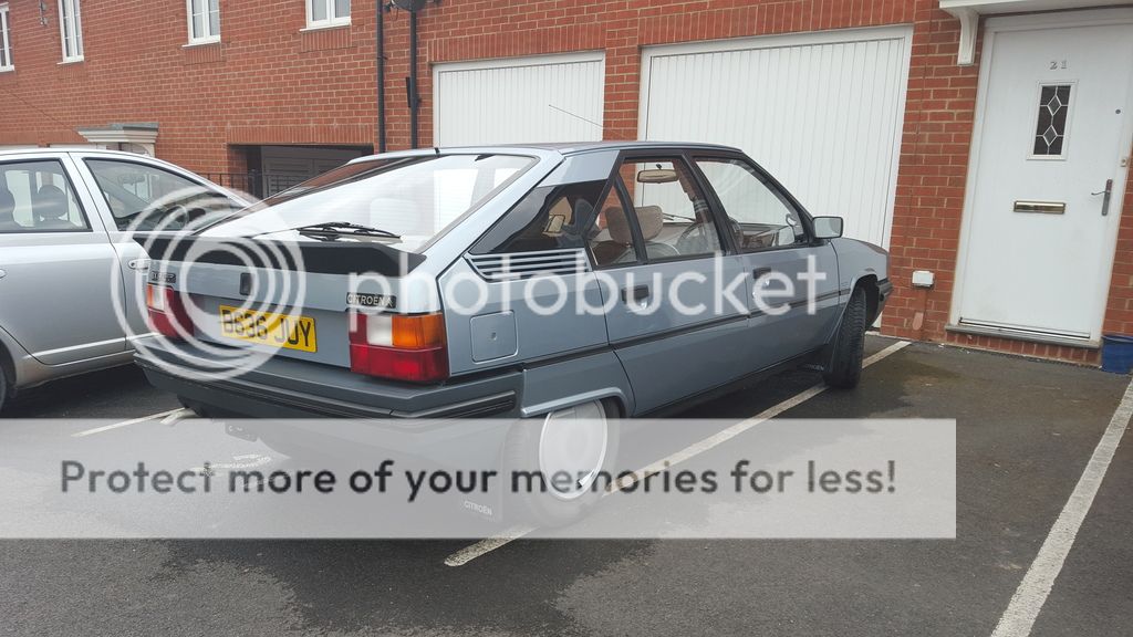

I've done around 100 miles in the GT since yesterday morning, 90 odd on the way home from Southways Automotive and 10 odd last night (or this morning rather...) dropping drunk people home after the ball. The GT is really quite a different car to drive now! It's much, much quieter, now the exhaust is properly sealed, even at full noise, it's quite quiet and also there is no more CV joint/bearing grinding noises and the suspension is much less crashy.
The ride is now magic-carpet like, rather than just wallowy, lolloping and crashy - it's not perfect yet but so much improved. The struts could do with a refurb and the tyres need replacing, the rubber is quite hard and they are an aspect ratio too big for a BX which doesn't help. This means it's a little bit fidgety over small road imperfections and bumps, anything else though and it's great!

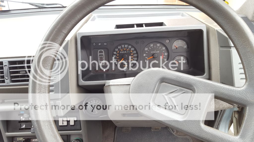

Having a working speedo is amazing, this one's never worked! I think it's ended up with a MK1 lower (longer compared to the MK2 lower) and a MK2 upper (longer than a MK1 upper!) so there is some curvature to it, and initially the speedo wobble below 40 was quite comical! But driving it last night/this morning that had virtually disappeared, so im hoping with use it'll go altogether.
It's also great to know the engine temperature, I chose the 'TIM' guage because it looked unobtrusive and wasn't as expensive as some of the really nice ones. However, the needle travel is less than 90 degrees, so less than a right angle from cold to nuclear (120deg) which when the engine is on the hot side means that there is very little travel from fans kicking in to potentially overheating, even stuck in traffic yesterday (was quite warm down here) it never went above what I guess is 98 or so degrees, just below the 100 degree line. I know the yellow light of doom doesn't work but the red does - only just discovered the MK1 dash light check button!). Running temp seems to sit at about 85 degrees, maybe slightly less.
Gearchange is improved, but still quite notchy and 2nd can be difficult to get, you have to be quite firm with it and push the gearstick as far to the left as it'll go before trying to get 2nd. But it won't be popping off anymore thank goodness!
Here her GTness is at home, just had her pre-ball clean.
The gauge, Rich put a green LED in too, so it matches the dash! Forgot to take night time pictures with it lit up.
