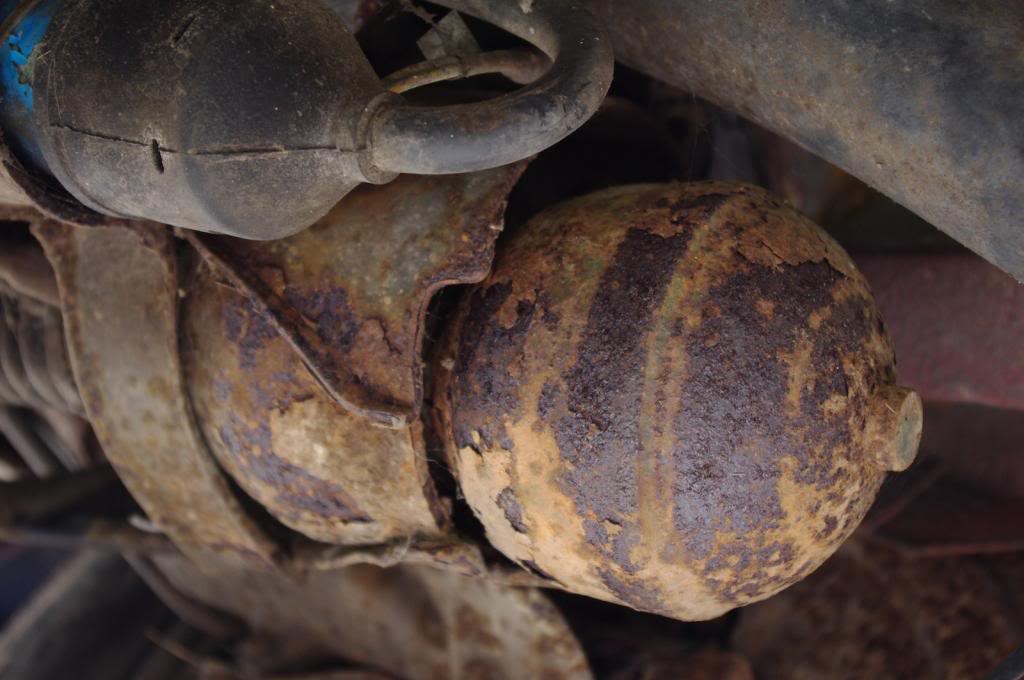

So with the red one in the air, the NS rear corner is extremely hard. Am I right in thinking that this means the gas in the sphere has probably leaked away? The sphere does look like this...
Image[/URL]
Doesn't bode well really. There are two spare spheres which came with the car, in the dim distant past, and they look like this...

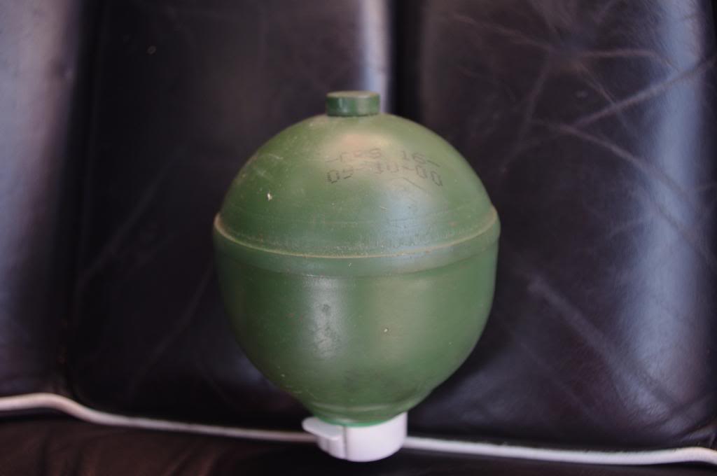

Much better. Only how do I tell which end of the car they're for, or even if they are for a 16v at all? Are all BX spheres the same, apart from the internal pressure? Answers sought please!

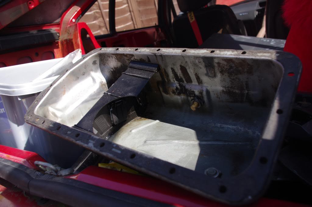

A baffled tin sump. Hurrah!
So the next step with the red one is to get the alloy panel into the roof; then (yes Tim!) clean it; and then it will be starting work on one end of the engine or the other. Either the top end (rocker cover gasket, exhaust cam oil seal) or the bottom (exhaust off, modify a downpipe, stainless system on, sump off, baffled sump on). Either of those means immobilising the car for a bit, so I'm trying to find some time in the diary, of which there is none at the moment...

Any part numbers on the spheres? This tablemay help...
If flat it will feel tight all the way to the end of the thread - like as if it's been cross-threaded. Then will spurt LHM in your face.

The only numbers I could see were the one shown, "CRS-16", and what I assume is the date code. I'll have a closer look later on. Thanks for the tip, a face full of LHM sounds fun.
So are all spheres the same apart from pressure? Particularly, I'm guessing there must be a membrane with holes in it inside the sphere, for the LHM to pass through, with the size of hole equating to the dampers in a standard car...? The reason I ask is that I have a full set of GTi spheres, which I guess I could have re-gassed for the 16v. Ideally I'd like to try Luke's setup of 16v rear spheres on the front (30 bar) and XM rear spheres, re-gassed to 35 bar, on the rear.
Edit - just had a look and there are no useful part numbers on these spheres. I think I'll probably put them on the silver one to get it through the MOT, and see how they perform. That will be road only, so it doesn't matter if it's a bit more floaty.

As you will see from Mat's link, spheres vary according to gas volume, pressure, and bore!

Oh yes. Thanks. </moron> Think first, post later... well, I'll just have to try the ones I have available and then work from there. By the looks of things, the random pair I have here are 1mm bore, which would make them rears from a 17RD. Seems a bit obscure to me, but then a hole that small is very difficult to measure and I'm only doing it by eye with a ruler!...

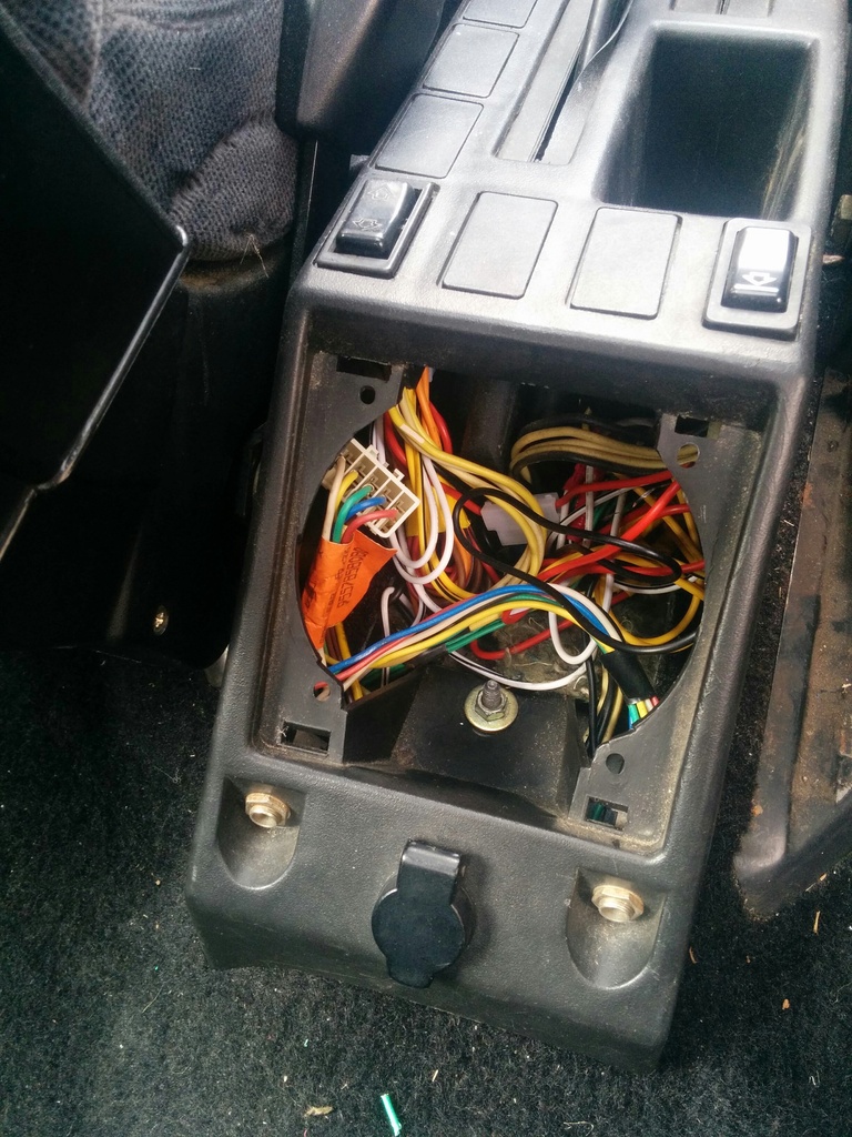

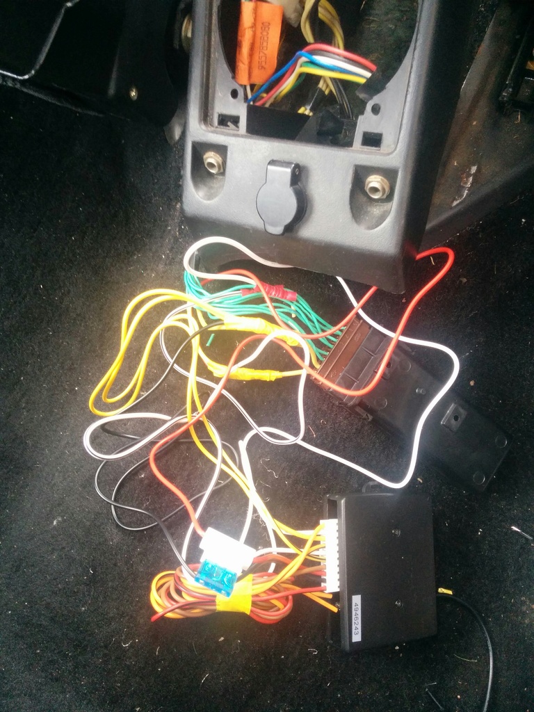

Amazingly I have actually made a bit of progress today. Nothing major but I'm trying to make progress little and often with this one. Therefore, it now has remote central locking (and it doesn't require you to hold the plip right next to the window of the car).
Following this excellent guide it was done in about half an hour.
Mid wiring, what a mess.
Never mind, stuff it all back in there...
I would have put an "after" picture, but it just looks normal

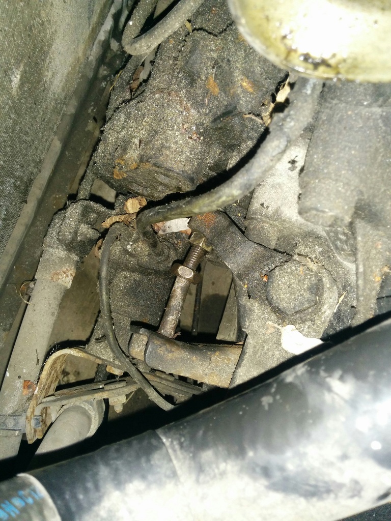

On to the clutch issues. Getting the car off the delivery trailer revealed that it had almost no clutch travel - the pedal would almost to the floor before you felt any clutch movement, then there was about half an inch of travel before the pedal was in the floor.
Access was fiddly so the airbox has to come out. Once there, I found that the rocker arm/pusher pin arrangement was just misadjusted. The cup-ended bolt was miles too far back in the arm and the lock nut was on the wrong side. Now rearranged and it feels like it has a clutch again - I haven't tested it yet as I want to sort out the squeaky belts.

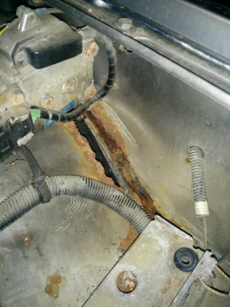

Just in case this post was in danger of getting positive, here's a picture of the inner wing... oh dear...

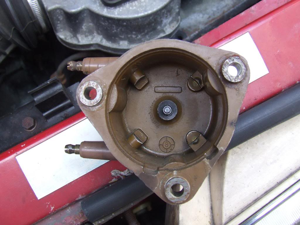

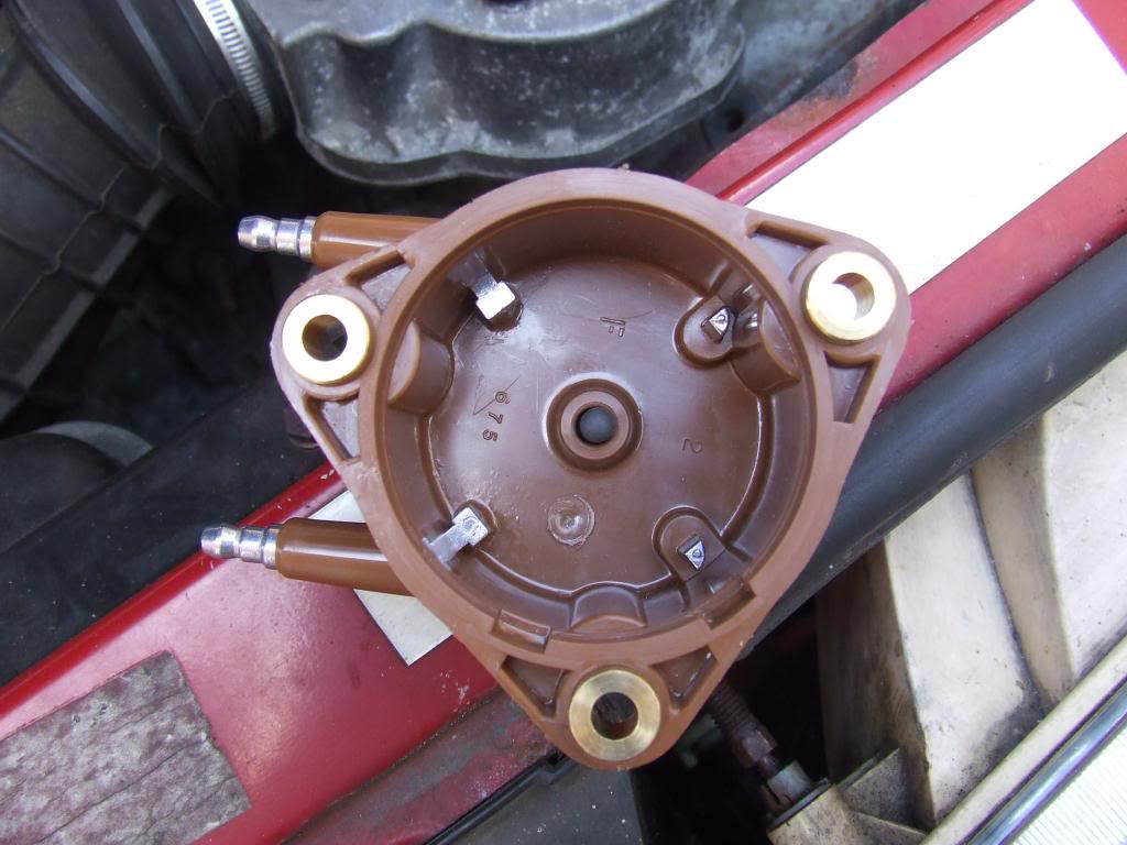

Dizzy cap and rotor arm are OK. HT leads are (I think) OK, though I've ordered another cheapy set just to make sure. Spark plugs replaced - old ones grotty:
However, the new ones made no difference. Battery is good. Your advice appreciated, BXers. I wonder if the mixture is too rich - presumably this would mean the AFM needs attention?
