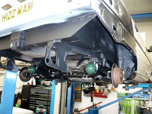

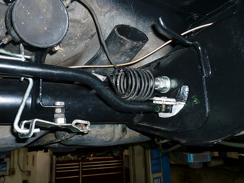

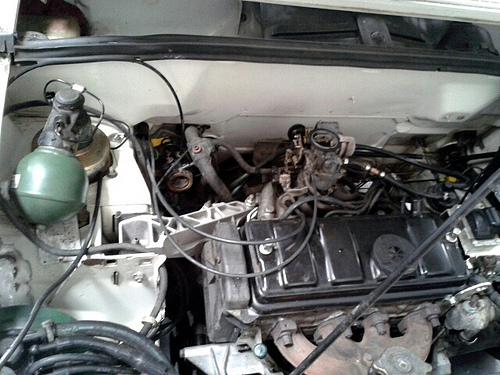

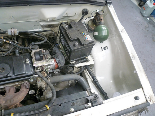

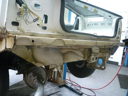

More pics to post up. I've been a little busy and only just got round to uploading these latest photos to Flickr. More porn for Mr Leech! Calm down Tim, it's only a car...
OS rear view of rear cross member and subframe
NS bumpstop and rear sphere
Rear subframe hydraulics
Front NS wheel arch
Engine compartment
Well done to Barry for spotting the non-OE bumpstop, but Mr Moss says it's correct, and I'm happy with that. You can see that the engine compartment is looking quite clean and tidy and although it won't be a concours finish, it'll being good enough for me.

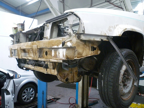

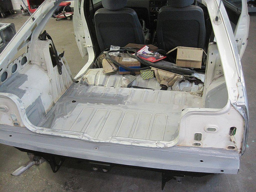

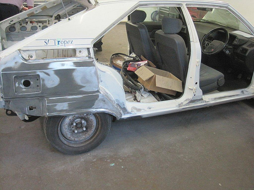

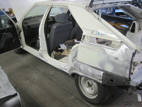

Back to the St Tropez for a change! The paintshop have prepped it for the respray. I'm not clear how 'old' these pics are, but she is due back at Chevronic on Monday, presumably after a quick bake. It's not a full respray, but obviously all the 'new' panels will be done and they will blend in with the old paint. Spraying the roof was going to be a pain, because the sunroof needed to come out, and as it never leaked in the rain, Rob wasn't keen to disturb the seal - I was 100% with him on that.
A full respray would have been £££'s more and under the circumstances, it's just as well I ducked out. I'd rather have a rebuilt gearbox for my money. Happily, the white should be an easy colour to blend new to old and once the original paintwork is polished up, there shouldn't be an obvious difference. I'm not trying to jump the gun, but I reckon she should be close to finished by the end of next week. :D :D :D
Prepped for respray the boot area
Prepped for respray OS view
Prepped for respray NS view

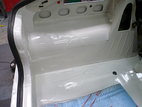

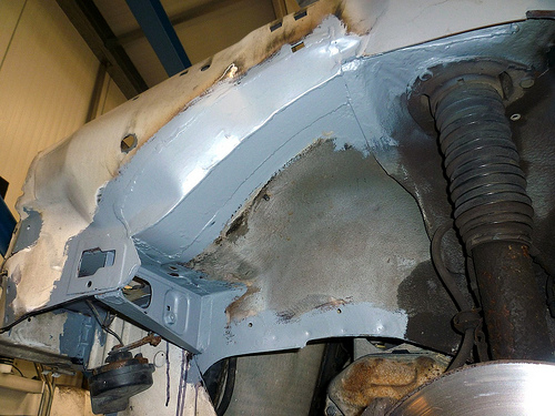

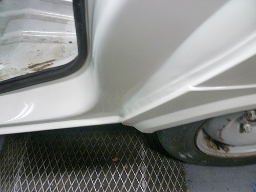

Rob emailed me yesterday to say the St Tropez was back from the paintshop and this morning he has sent over photos of the work in progress. The new paint looks amazing, but the problem is now about getting the original paintwork up to the same standard!

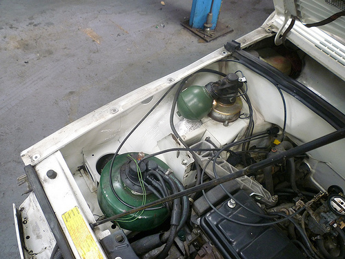

NS boot interior resprayed
NS engine compartment and inner wing
OS engine compartment and inner wing

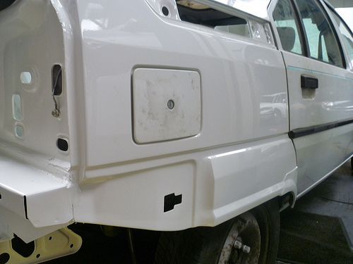

OS rear wing resprayed... is that the reflection of a white DS in the paintwork?
NS C pillar and door shut. So nice you want to lick it!
Waxing the back end
Waxing the front end
They are now cracking on with the waxing and re-assembly, so it shouldn't be too long before the job is done. Having said that, the front wings have a bit of rust and will need replacing at some stage and apparently Rob tells me the welding done on the car before I bought it had damaged the wheel arch liners, so while I'll have the car to show at the CCC rally this month, it'll need to go back for some more work in the autumn.

[-X That filler flap is a real let down :wink:
