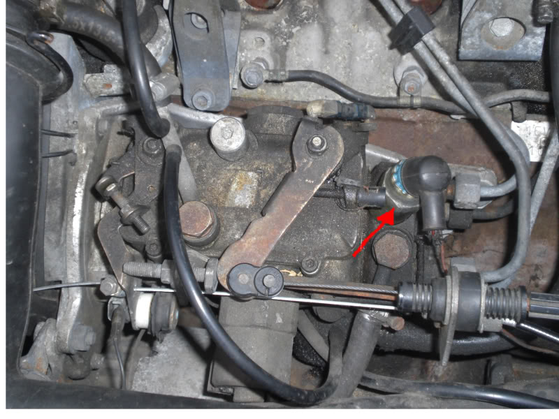

).I'm reliably informed by The Doc,that my stop solenoid is FUBAR.Could somebody please point me to where it is please.If you could add a photo,so much the better.Thanks and regards,Dean

I cant do a picture right now, but if no-one else has by tonight I'll bung one on.
It's easy to find though, assuming you have a Lucas CAV pump, which I think you have!
If you open the bonnet, look at the engine, the alternator is on your left, at the front of the engine, above it and slightley rearward of it is the inj. pump. At the right hand end (again, as you look at it) of the pump are four metal pipes that go to the injectors.
Above these pipes, where they leave the pump, is the stop solonoid, easy to locate as it has a wire going to it attached to the solonoid with an 8mm nut.
Happily with the Lucas pump it's a simple task of unscrewing old solonoid, and screwing in a new one.
The Bosch pump is a tad more difficult to get at.
Hope that helps, and great to have you back!
