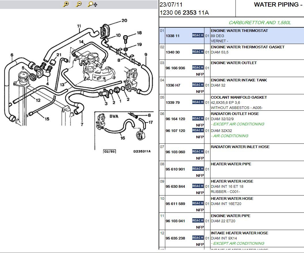

Radiator bottom (and other) hoses
A search on your VIN brings up...
BX 1.6L (XU52C) carburettor
RPO 5139 (= 4 Dec 1990)
BVM5 4x2
Single A/C
"Image" special spec
Coolant hoses for the 1580 carburettor engine...
. Two shown, cars w/ and w/o A/C.
Both NFP.
Couldn't find either on Pieces de Rechange, Mister Auto, or Metalcaucho.
The hose internal diameters are at least shown, so mighty be possible to use general-purpose straights and bends.

many thanks for this.
No, I don't have AC, nor was it ever fitted
I am not sure I am reading this diagram correctly. - part 6 looks possible.though I dont believe it has a T piece with a another pipe attached - part 12. could be wrong.
The hose I need comes out of the bottom of the radiator - drivers side, stays below the crank and comes in behind the engine - I can't see where.
You can see a small section of the pipe from the lower wheel arch - this is the section of pipe that rubs against something ( one sort of arm, it was explained to me but I forget). apparently not an unknown issue.

No, VIN number was right, and that's the diagram that comes up, both via the VIN, and via a BX 1580cc search.
Factory spec definitely says A/C, but likely just an arror - not unknown on the system.
Hopefully someone else can help identify the hose.

Seems I was mistaken ( not unusual according to Mrs me ) part 6 does look correct, as you mentioned - I can’t find stock anywhere
