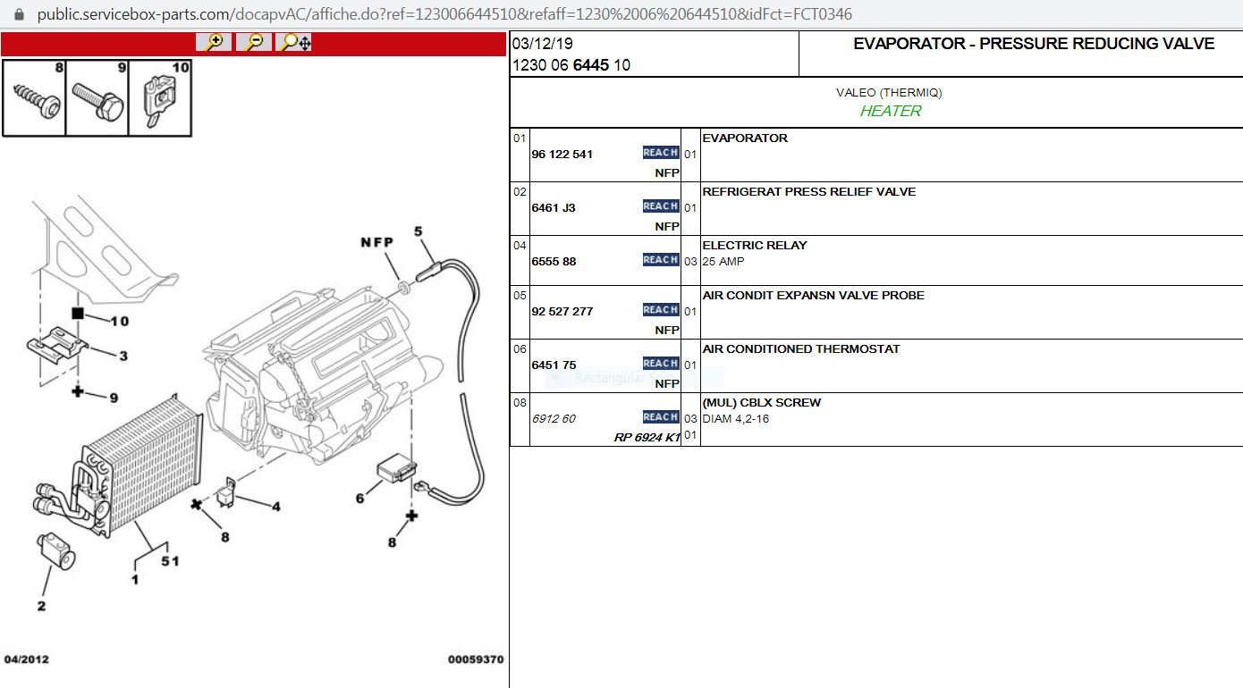

As well as the sum-up thread on AC (which you've likely already read)
viewtopic.php?p=261690#p261690
these are a few pages I found useful...
The main EWD comes from Vanny's site.

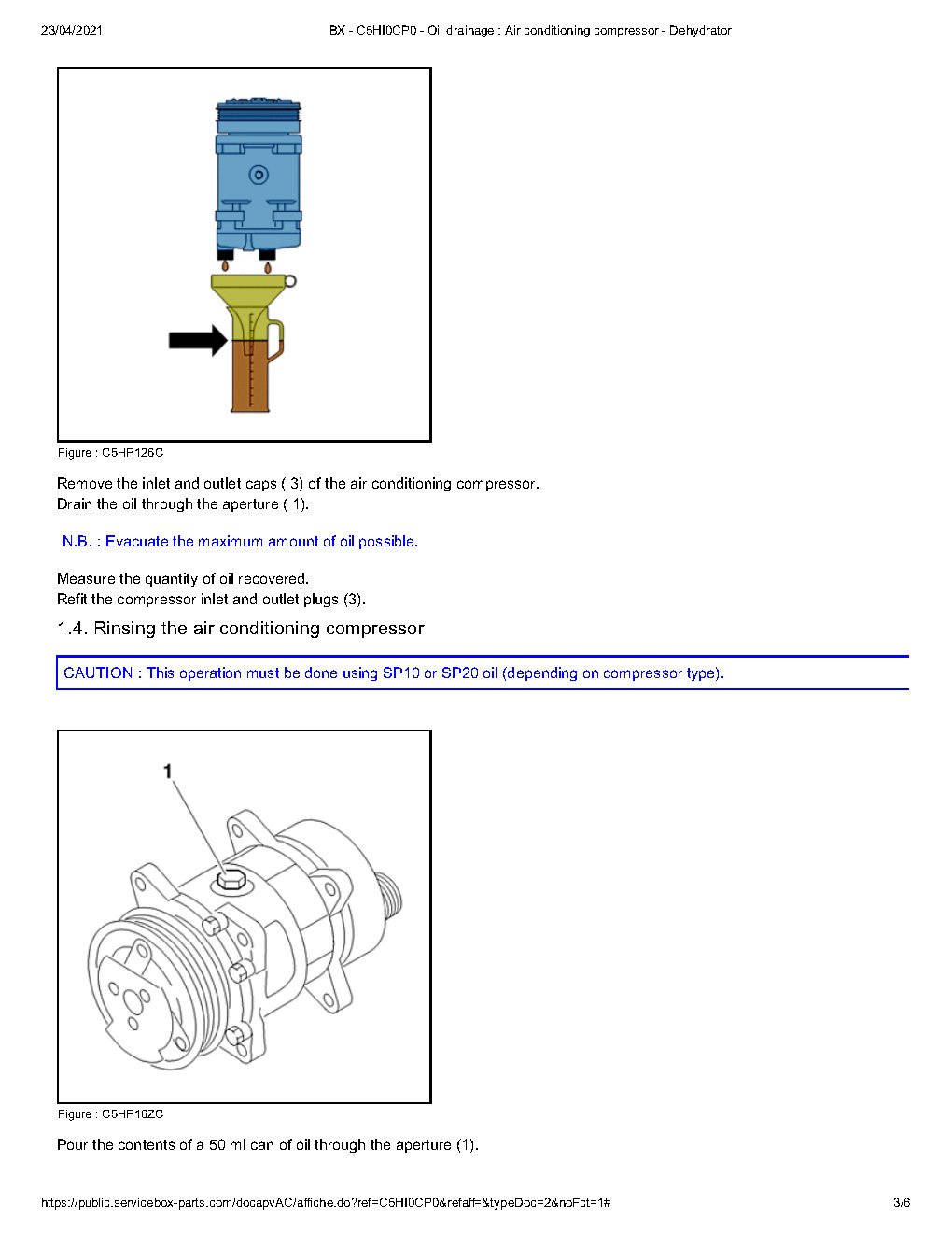

...and some Citroen R12 to R134A conversion instructions for the BX:
