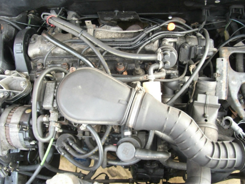

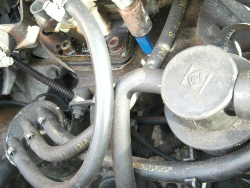

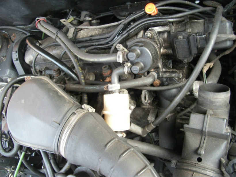

I haven't looked closely at the fuel lines in my engine bay for aaaaaaages.
I was surprised to see (I had completely forgotten) that my car is fitted with an anti-gassing device.
Everything in the pictures is original, except for the inline fuel filter which I renewed ages ago (I've had the car since 2004).
The routing for yours should be the same, except if you don't have an anti-gassing thing, the output from the inline fuel filter would go direct to the carb, and the return pipe for the tank would attach to the outlet above the inlet on the carb. However, like mine, the outlet is missing on yours, so if you don't have an anti-gassing thing maybe there was one once.

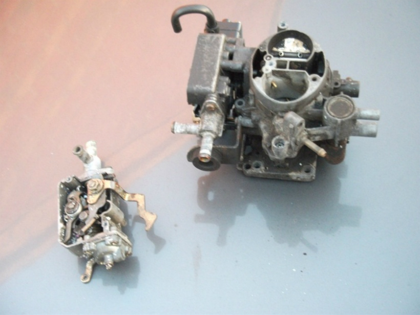

Turns out I've only got 1 spare carb (and a spare auto-choke control), no idea where the other carb went
Anyway, as can be seen from the pic, the spare carb also only has the inlet, so the scrapyard car I took it from must have had a de-gassing thing as well.

/\ yeah it does,
I have a car from the 50's with an SU carb but no return to the tank.
On my BX, there is no return to the tank from the carb (see my pics), but there is a return from the "de-gassing" device (a Citroen specialist told me that was what it is, about 15 years ago, I actually assume it's not called that because I can't find anything about it). This device must be to ensure that the presssure feed to the carb is not too high, returning fuel to the tank but keeping a sufficent pressure up to the carb.
I'm not sure what arrangement Willy has on his car. I notice that in the Haynes manual there is a direct return from the carb, and I remember that from when we had an "E" reg 1.6 which we got rid of in 1998. But ever since then they have had this "de-gassing" device, which I totally forgot about until I took the pics.
I was talking about the pressure at the needle valve from this device, I think that might have been the confusion.
