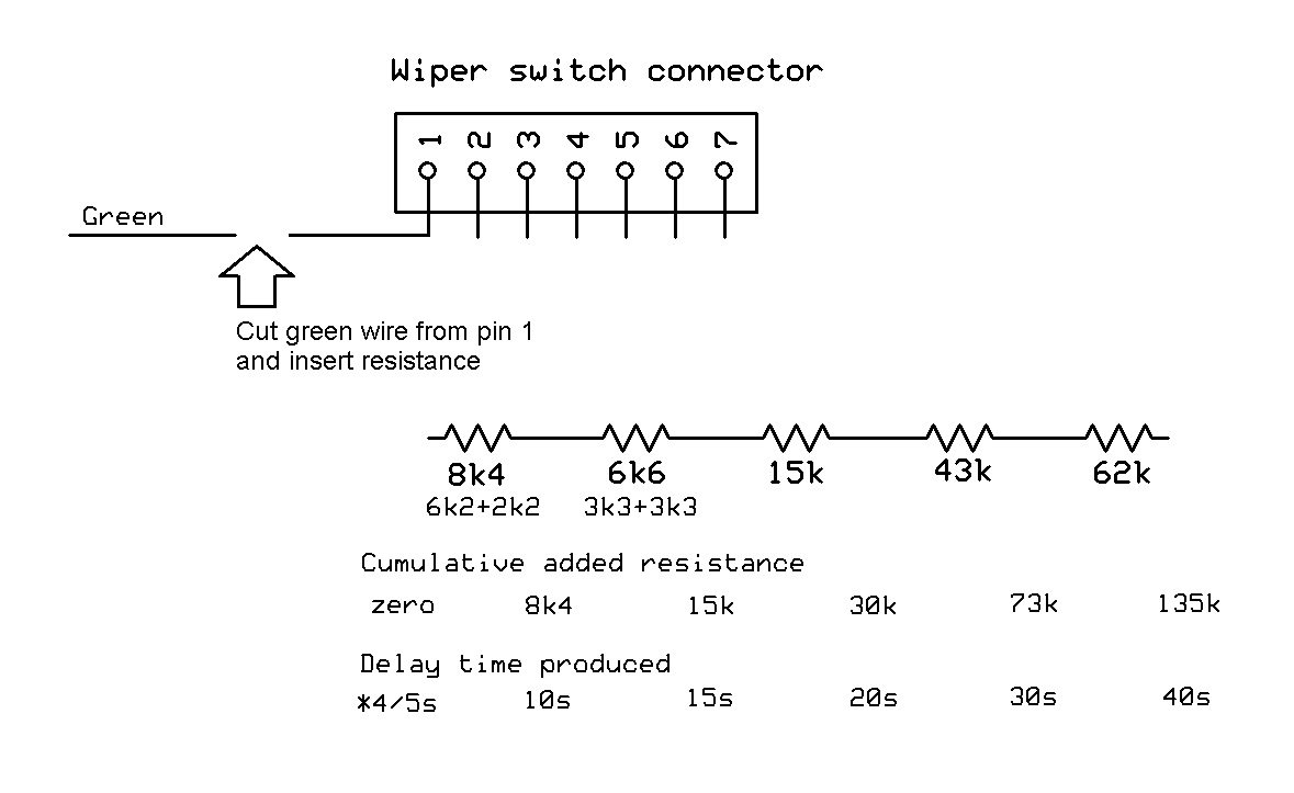

Adding the potentiometer/variable resistance turns out to be childsplay, and simply involves cutting one wire at the 7-way wiper switch connector (pin #1), and inserting the variable resistance there:

Resistance and Delay time
By doing a few tests, I found that the maximum resistance that can be inserted is about 135k, which produces a wiper delay of 39-40 seconds. Beyond that, the relay doesn't instantly trigger or re-trigger, so 40s is the max interval possible (unless you want to start altering the internal relay components, which I wanted to avoid).
So, based on some previous experience, I settled on delay intervals of
4/5 secs (the in-built original time) - achieved with no resistance added
10s
15s
20s
30s
40s
and also decided to do this in steps, rather than as a continuous potentiometer sweep.
The resistances are a simple series arrangement (no grounding).
Steps (using a 6-position rotary switch) are easy to set, and can even be "set blind" without needing to glance at the switch. Also, a 130-135k linear potentiometer would be a bugger to find, not easy to control the shorter timings.
So, that's it.
In practice, on the BX here, the rotary 6-position switch will go in the recessed switch-cubby, next to the mirror control.

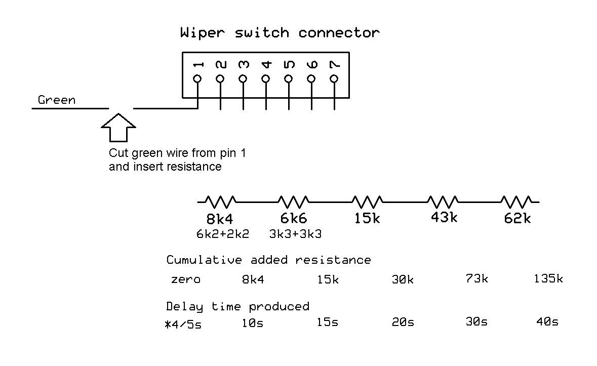

10s
15s
20s
30s
40s
So, that's it.
