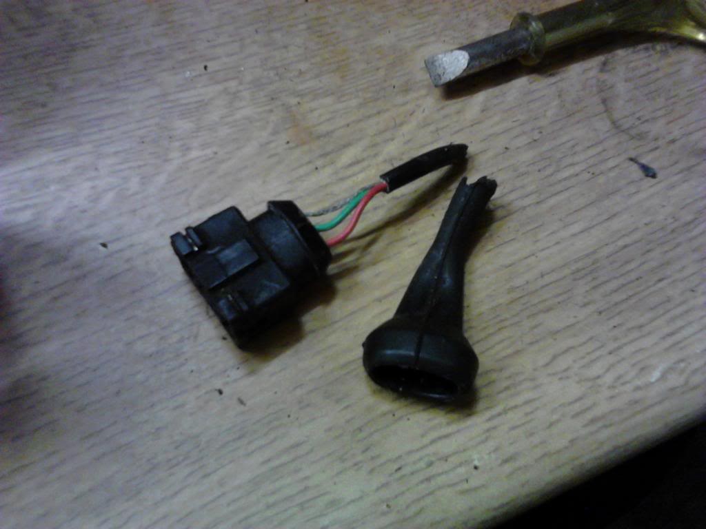

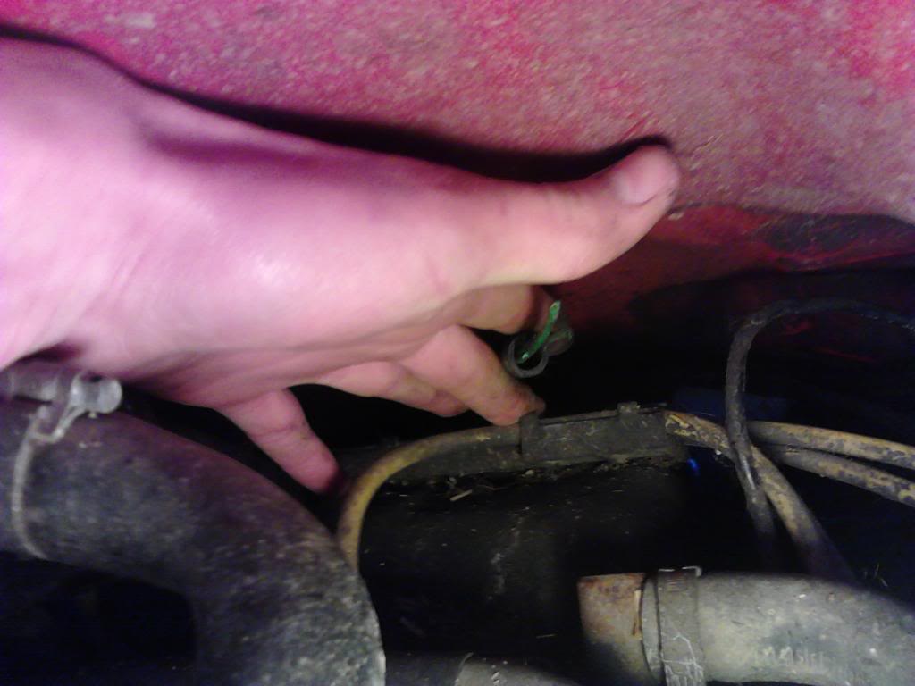

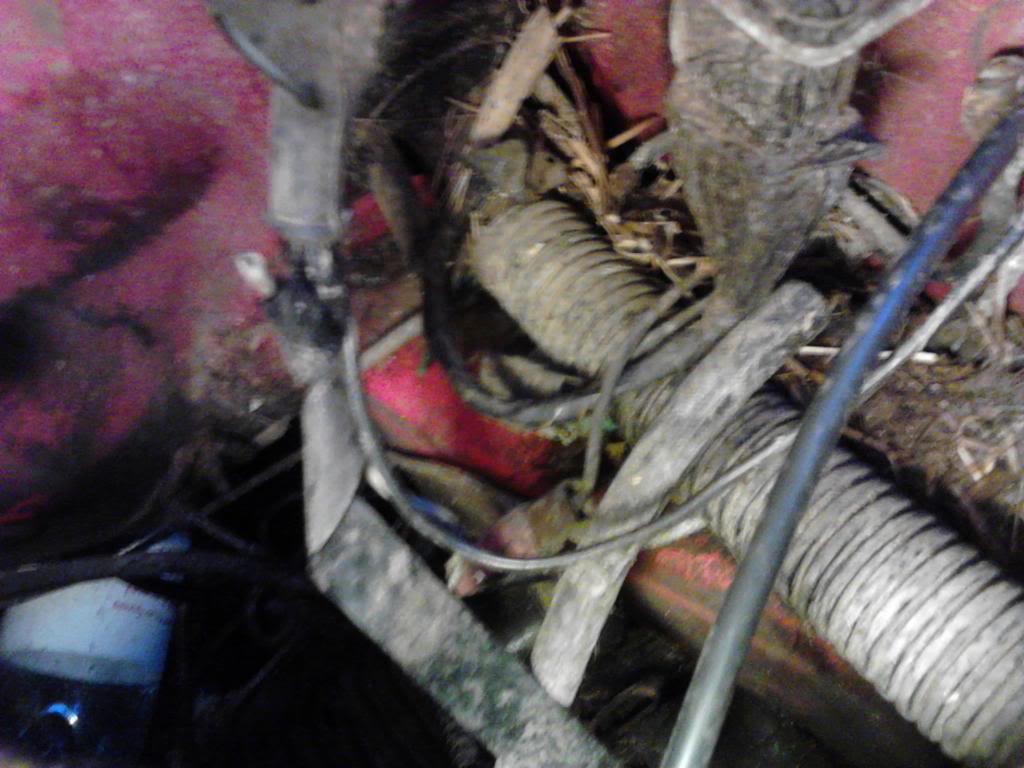

Re: B438 AVH collected
unfortunatley when i tried to get the car to start today, i found that far more wires had been eaten! the wire which goes from distributor to coil (lt) whaich has an odd pug on the end has been cut through and then other end probibly digested. the wires underneath the coil is where the mouse nested and ate a lot of the wires in that corner. The wires from ignition swithch to coil have also gone and 3 wires behind the offside headlight have also been eaten and that is just what i could see under the bonnet, i can only imagen what else has been eaten! the king lead has also been cut through and my spare isnt long enough! i will go and make a photo bucket account and show what the little barstuard has done!
photos (hopefully)

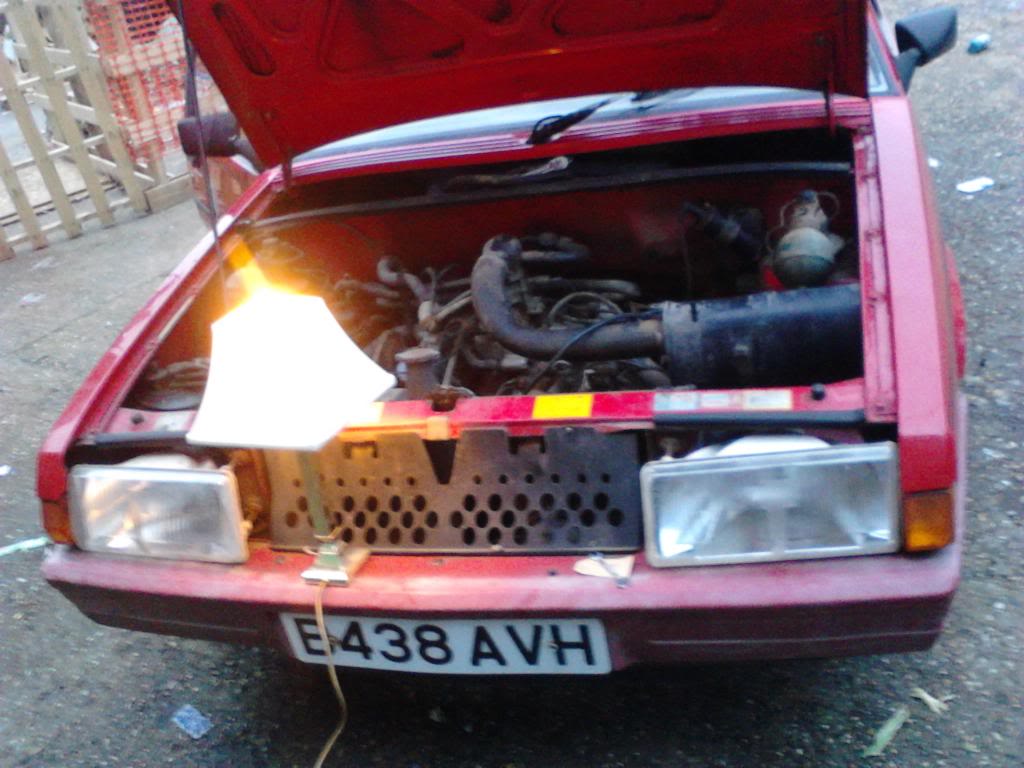

that plug connector is from the electronic ignition module to the distributor,
usually the coil terminals have plus and minus symbols emboss't into the backerlite,
i should have some of the leads to link the module to the dizzy,
i like the new head lamp, but for MOT purposes you will need a matching pair
Thanks Malcolm, I would be very interested if you do happen to have the wires I need. and ah the headlights work except main beam on the offside. the lamp is a work light
