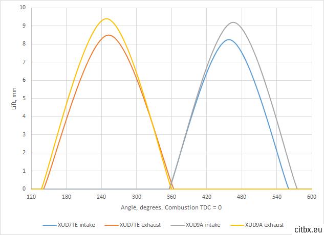

Thank you for your feedback. I have finally found a camshaft from Peugeot 309 1.9D and it fits my 1.7TD head like a glove.
Regarding turbo... The Garrett I have has seized waste-gate valve at almost fully closed position so it seems I already had some boost
And I've got myself a nice thickest possible Victor-Reinz gasket. It should do it, I hope?

Hi, I just noticed your post. I hope you have found a solution already.
I ended up with 1.9D camshaft from Peugeot and it works well. Though i don't think it makes a substantial difference in overall performance.
You can measure camshaft lift height with cover removed. With that you could identify what you have. You should have a long camshaft with rear end pulley in your TXD. Also, while fiddling with my fuel pump i found that timing settings have nothing to do with what the book says. Initially I set it to manual but ended up turning it by hand on a running engine. If yours is smokey in mid revs, you might try advancing timing just a little. But I am not an expert in this matter.
Please see D and TD camshaft dimensions:
