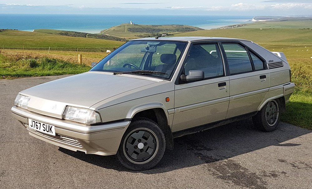

ECZ is Sable which is a pale gold as, you say. A great colour, your car must look v smart.
Here's a Sable XM and C6 for comparison:

I've seen this car at the northern rally in 2017.
A tidy car but yes it has a set of 16v grey/silver wheels fitted to it. It should have 165/70R 14 tyres
That is the only Gold one I know off as they were mostly all grey or blue.

Yes - that's my car.....it's rust free---a few dents and at some point I will get the alloys refurbished....even thinking about getting them painted the same colour.....or is that too much?
