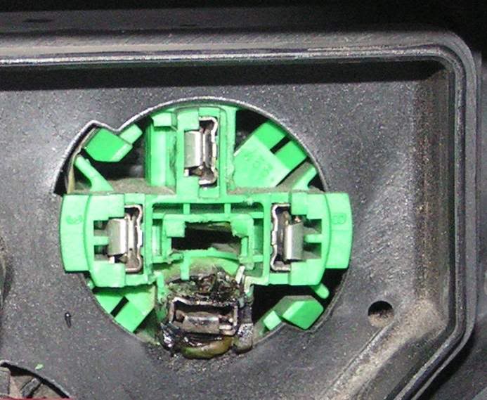

can anyone throw some light on which pins on the relay socket are which as in a top to bottom diagram as i may try and bridge these before i go hunting for another relay
will take my other xantia apart to get to the relays that i know work cos i can test them in their present location
cheers colin
thanks to Clogzz for the picture

For the record, the relay connections are as follows: (imagine a clock face, using the picture above)
9 and 3 o'clock are the relay coil connections. (85 and 86)
12 o'clock (30) is the common switching pole.
6 o'clock (87) is the normally open contact and the middle contact (87a) is the normally closed contact. When the coil is energised, 87 closes and 87a opens. This is known as a change-over contact set in old GPO telephone relay parlance....
So, with the coil de-energised, you will see continuitity between 30 and 87a but not continuity between 30 and 87. With the coil energised, you'll see exactly the opposite.
My slow speed relay socket on my Activa looks exactly like the picture above

I'm with Richard here...
