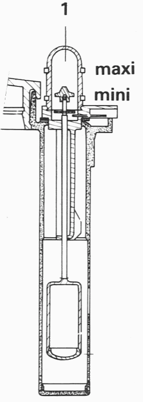

Post by ellevie »
This image is from the BX service manual.
It's fairly clear that the umbrella shape should be between the min/max markers.
You can see that the lower disc activates the sensor when the umbrella goes below min.
David

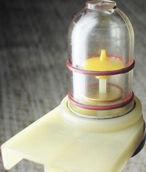

Post by Brian »
Yep that's right..
Here is an even closer look, and this one came out of a BX 16 petrol car...
The bottom disk is definately brass, and I set it to show the maximum level too...
