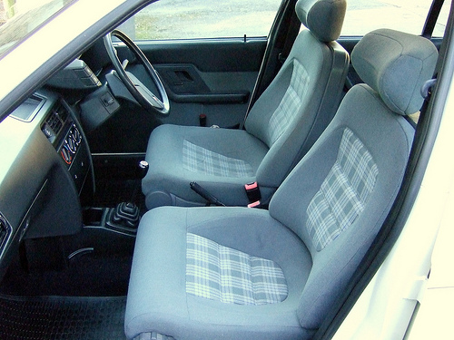

The seats are all sorted out. I pulled the driver's seat out yesterday afternoon and had a fun time trying to access the security bolts. Not a lot of room to get in there, so I had to abandon the fancy tools and go back to basics. Once the seat was out, the layers of dust and accumulated crap underneath was quite impressive. Rounded the day off by cleaning everything up ready for the 'new' seat.
The old seat had a ripped bolster that I'd stitched up to stop it getting worse. It wasn't a pretty job and periodically I've had to re-stitch it because the fabric was so weak it just unravelled. Add that to the saggy squab and it didn't do much to enhance the driving experience. The replacement seat probably needs a valet but it's complete and the squab is firm.
The passenger's seat was a little more tricky. It was in decent condition but the plastic surround was cracked. There are four screws holding this on, but the wrinkle is the plastic sleeve for the headrest post that goes through the top of the surround and locks into the seat chassis. There's a plastic locking clip that releases the sleeve but you can only access it through the bottom of the seat back. This is achieved by removing the seat squab and wriggling your hand up to the headrest sleeve. There's some minor contortions and it requires a good sense of touch! Happily, I had the old seat disassembled, so I could see how the sleeve was locked in, otherwise it could have ended in tears.
Once the sleeve was out, the plastic surround could be swapped with the new one and the rest was plain sailing. While the seat squab was out, I cleaned up the detritus underneath and found, among other other artifacts, a rubber grommet. (I'll post some photos of it in the technical section.) Once the crap was cleaned up, the finishing up was straightforward. Everything fits back together really easily and with a quite brush down, it looks quite tidy.
Probably the next step would be a good upholstery valet to get it looking a bit cleaner. In the meantime, the new driver's seat has eliminated that sinking feeling and immeasurably improved the driving experience. Hurrah!
