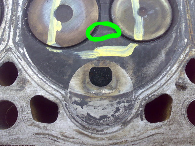

Personally I'd be inclined not to chance things, and go for HG/head replacement or a good replacement engine. I don't know what use it is, but here's a photo of what my head looked like after similar bubbling through the expansion tank.

Apart from a slightly cracked pre-chamber, I don't see anything wrong with thatmat_fenwick wrote:here's a photo of what my head looked like after similar bubbling through the expansion tank.

Not those one's, no. The pre-chambers are actually a separate part of the head, made out of a different type of alloy, and in many older heads were replaceable. As the pre-chamber is only pressed into the head, a crack in the pre-chamber cannot extend into the head itself and so penetrate a waterway.

Ahhhhh.jonathan_dyane wrote:a crack in the pre-chamber cannot extend into the head itself and so penetrate a waterway.
That would suggest the crack is between the pen marks they made after the pressure test then. I'm just wondering now whether a leaking valve could cause a pressure test fail? Surely they'd check that...

Now Mat, that is a very interesting photo.
Unless my very tired eyes deceive me, I detect a crack in the head between the inlet and exhaust valve seats.

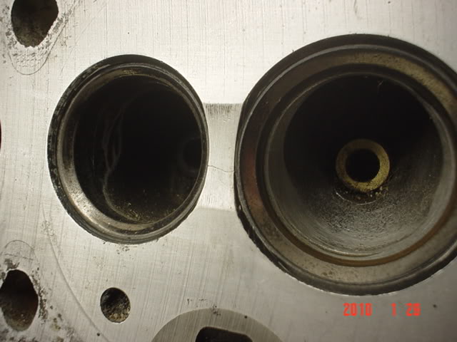

I do have another head from a turbo engine that has two of these faults.
(Will try and post a photo)
Has anyone else reused a head with that type of fault?.

This?Brian wrote:Now Mat, that is a very interesting photo.
I have had a head before with this fault, but with a skim, was reusable again for at least another 3k miles, when I sold it.
The buyer never came back to me with a complaint, so I guess it lasted well.
I didn't spot that, looks like a likely bet
In my defense, it does also look like an edge where the casting curves inward between the valves, but I guess it could be the offending crack...

The line you highlighted in the green circle, is in fact a machining line, the one I refering to, was above that line.
This is the worst crack on my spare head, but as far as I can see, with the aid of a bright light and magnifying glass, does not show up in either of the adjacent ports, so may not penetrate very deep.

That's what I initially thought the bit I have highlighted was. The only other bits I can see on Mat's head that could be thought to be cracks are the two 'ridges' which are again part of the casting on some heads (I have obscured the lower one with green on the pic I drew on) and what on first sight looks like a crack between the valves like on your head, but is in fact (I feel) a mark made in the carbon by something the head has contacted after it was removed (the mark clearly continues onto the valves...)
As regards your head, personally I would not put it on a car of mine, the crack is only going to get bigger until trouble does start. That said, it may well be some thousands of miles before this occurs!
