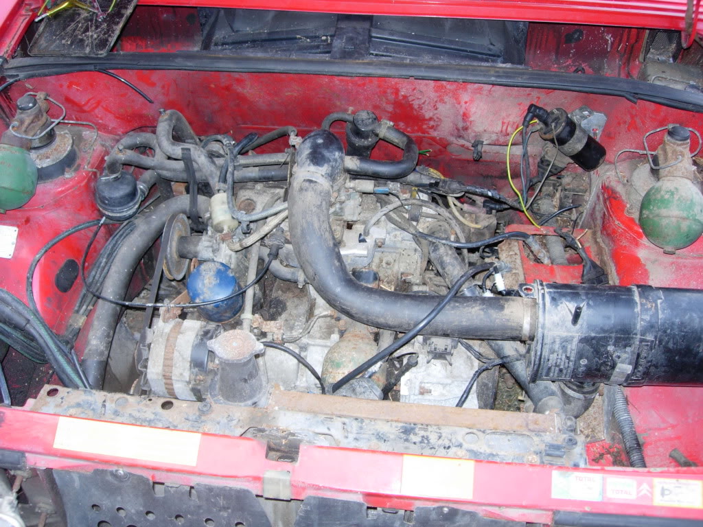

Thanks malcolm, do I owe you anything? and Tim, who's Tim? he's more than welcome to come round anyway :D the more hands the better as I got a bit fed up with the red devil today, despirate to get it running, checked fuel was being pumped out, yup, poored all over the alternator :lol: but no spark still! bodged some wiring from dizzy to coil and what i thought was the ignition switch (the snapped green wires which i had my hand on in one of the photos) and linked that to the coil and still sod all, ended up with slamming it shut and cursing loudly and one strong cup of tea!

Andy Henry's car does not have contact breakers as its electronic ignition, as thats what the lead i have found for you to take over on Friday is for,
and Henry yes the lead/s from the alloy plate/heat sink are important as the black device fixed to the heat sink is the leccy ignition module,
this lead has a multi pin plug connector at each end and two single connectors, these connect one to each side of the coil,
were the connectors still on your coil if so the colours of the plastic sheath's show you which one goes to which terminal,
one should be white the other is black or brown,i cant remember which goes to what side,
if you get them wrong you could destroy the module,
i will try and find the circuit and let you know which way they go

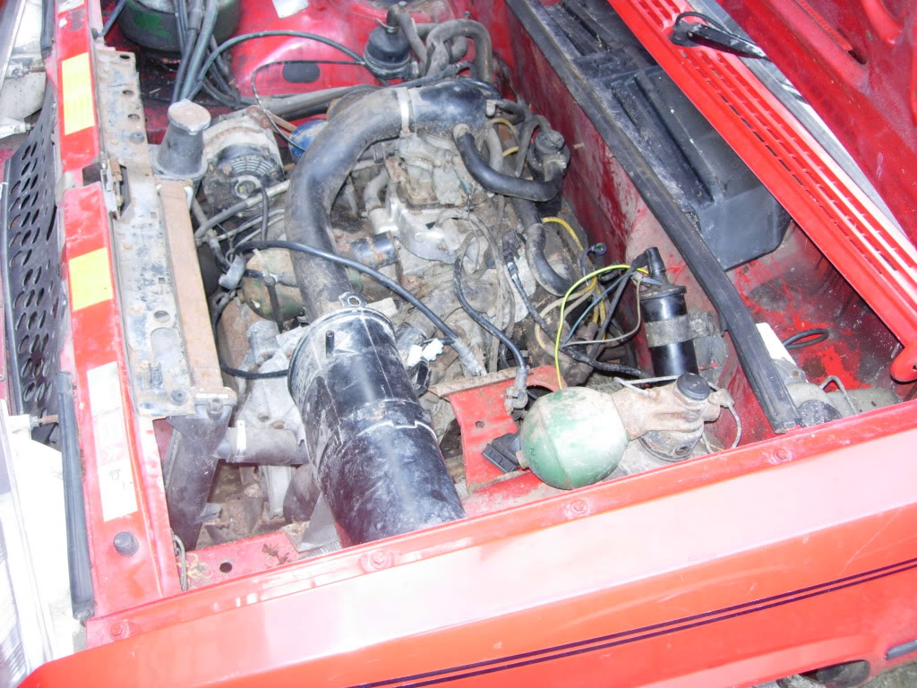

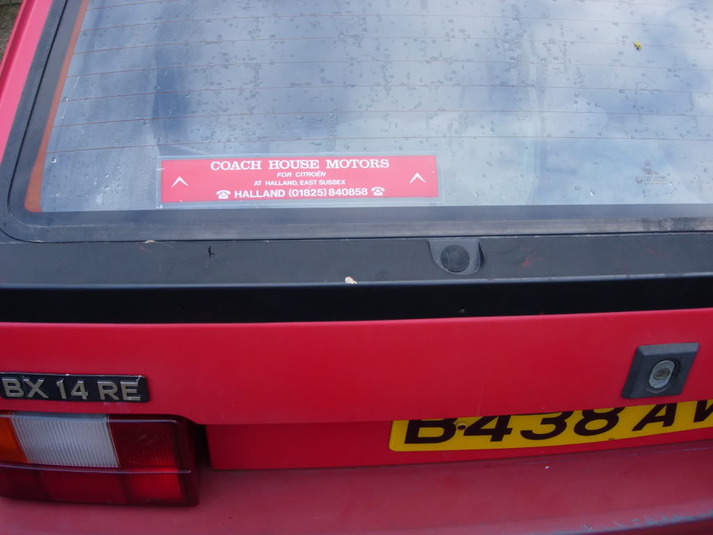

Here are some more piccies of Henry's BX14 RE which Tim and i had a look at this morning. Defo restorable and with a lot of hard work and help from members advice from this forum ime sure he will succeed.
Good luck bud.
Andy.

I only know of 1 other Mk1 14RE examples around, so this one really needs to be restored! Having seen pictures on Fb its a solid old bus with some dents that need addressing.

sound to me after Andy speaking to me on the phone after he had a look today, you need to connect a battery and with a test lamp find the 12v feed from the loom just by the coil, then connect it to the plus side of the coil along with the single black connector of the lead i sent you, then the white connector goes to the negative terminal of the coil,
and with the multi pin plug fitted to were they go you should have ignition/spark
