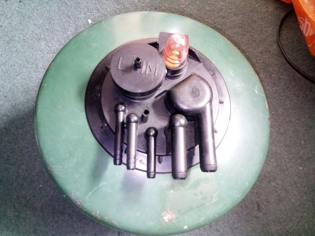

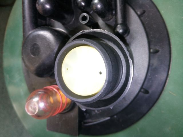

i have take the LHM tank off today, poured out the old creamy green LHM.. found that it has a plastic disc in the bottom of the tank that kinda acts as a water trap i guess. what ever.. its was pretty rancid under it. the filters were caked. i have put most of the stuff in the dish washer.. old dish washer that is.. they make awesome parts washers. the tank has come out gleaming along with the top.. i did not put the filters in it with them being a thin plastic mesh so i will have to go cleaning them manually.
now here is one i bet a few of you have not spotted.. the cap that has LHM stamped on it with the small pipe that goes into the top.. have you seen how much crap collects in that??! i have been cleaning it out for ages now and it just keeps coming! i think i am going to get a car window washer pump and some diesel and just keep pumping that though it. its really bad!

Rear wheels thus/\ usually means the bearings are shot in the arms, they should still sit straight even in low position, common prob easily solved with a bearing kit each side cost about £30 per arm. Each kit comes with 2 taper bearings, seals, plastic tube, long bolt and nyloc nut. Readily available same as C15, Xantia tho the long bolt may vary in length-you can re-use the old bolt.
The pipe on the LHM cap is only a breather which disappears into the wing shouldn't be full of anything as it really serves no purpose the reservoir breathes quite well without it.

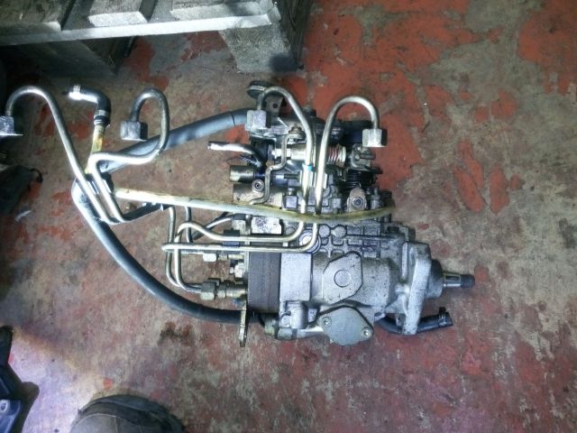

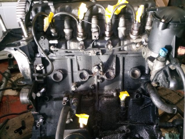

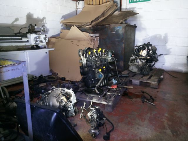

Engine acquired. just got to wait for the guys to pull it out of the other vehicle, then it can be dumped in the back of my scrappy panda and taken to work. i think they are giving me the gearbox too.. not that i want it as i will use the original BX box.
now to buy the cam belt, water pump and other bits! (i already have a few!)

so here is my little work place.. 2 engines.. a good tool set and in the background there.. on hell of a lathe (13 inch deck! sadly missing its chuck)

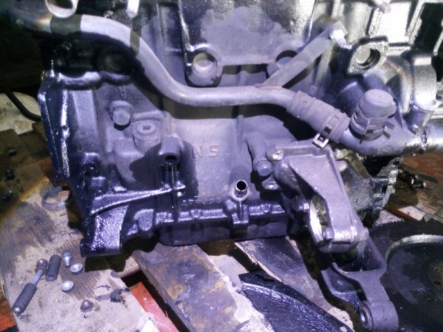

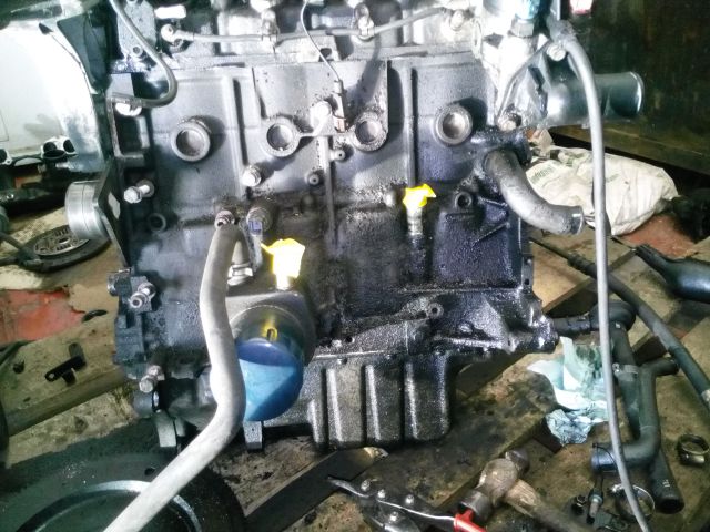

here is the engine. so far i have stripped off all the bits bolted to the sides, taken the belts and pulleys off. it needs vigorous cleaning. i will jetwash it for now and see how that makes it come up. the plan is to paint this Red with engine enamel. (red for a diesel, green for a petrol.. its just how it has to be)
guess which ones are the intake...

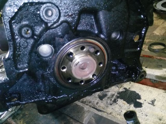

pesky oil seal behind the flywheel was leaking... gahh. well may as well change it as i have it all to bits to paint it
the other end (timing belt end) is ok.. but for what it takes, i will change that too.

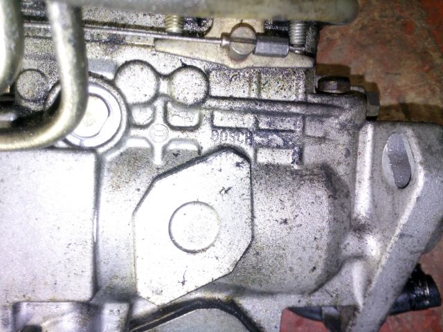

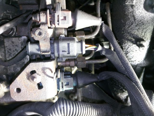

oh whats this.. it all came on the replacement engine.. could it be? the magical Bosch pump everyone raves about?? oh my.. so it is!

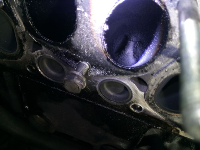

right.. so now we get back to that EGR thing i was on about earlier.

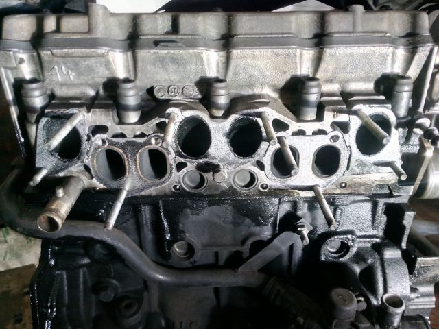

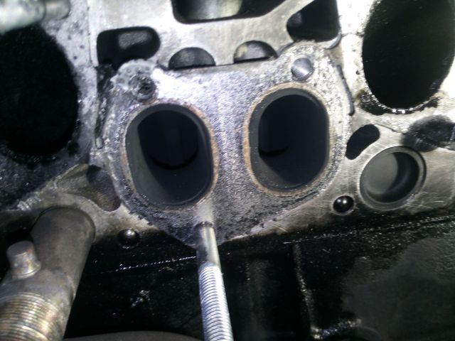

here we have the 2 center exhaust ports. nice and clean. these are as i took the manifold off. i have not cleaned these.

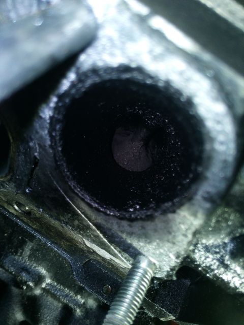

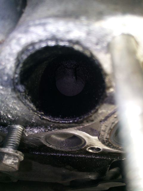

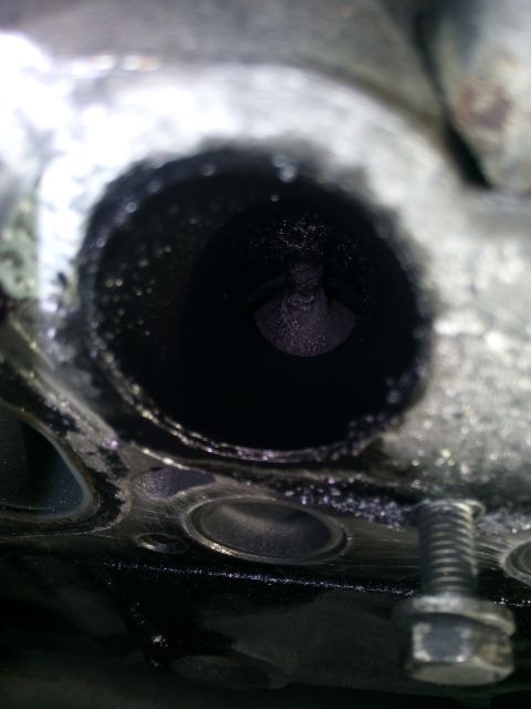

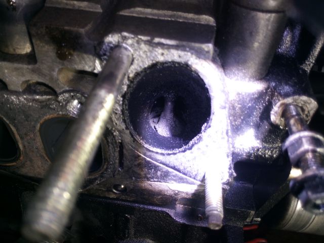

now for the true horror of the EGR.
these are the clean air intake ports.
cyl1
cyl2
cyl3
cyl4
big deal huh.. well..

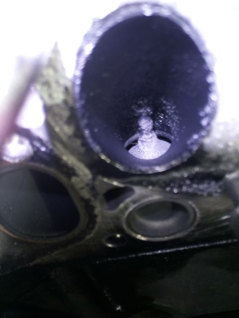

in better light:
cyl1
cyl2
cyl3
sadly torch batteries died at cyl4.. but it was just as bad.
ERG.. the creator of "diesel engine cholesterol"

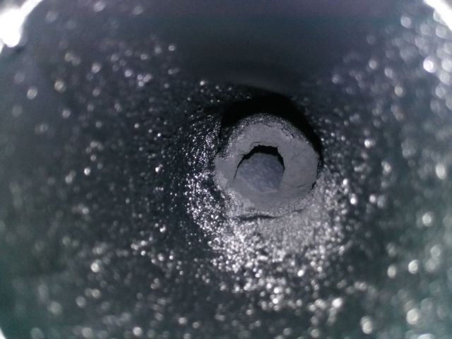

this is looking into the intake manifold, at the EGR/clean intake air from turbo mixing point. behold. strangulation at its finest.
even just me blowing through the intake manifold, i was greeted with quite a resistance. its no wonder the waste gate on the turbo was jammed closed! poor thing had to boost all the time to combat this incredible restriction.
needless to say, the manifolds and turbo (if i cant get my hands on a VNT turbo before i get the thing built up) from off the old engine will be going on this replacement engine. the old engine was before the days of EGR's on diesels so the intake manifold and ports are still shiny! even the turbo does not pass oil!

Never seen a bx with an egr before, what's it from?

a lateish rover 200. i just have to hope that the immobiliser is not built into the fuel pump. theres a lot of wires going to it :/
