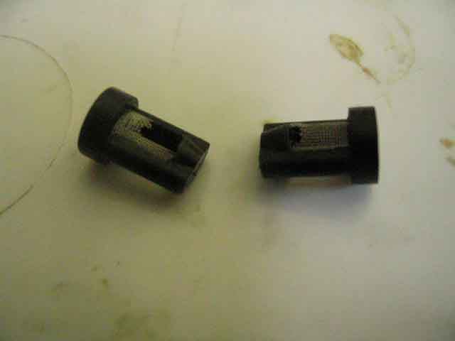

1) The two filters (one on top, one on the bottom of the FDV) are held in by 5mm allen screws. The bottom filter is inside a metal holder, which itself is sandwiched between two washers with central holes. Here's the state my two filters were in :
old filters
old filters
Hardly surprising that the steering was intermittent...

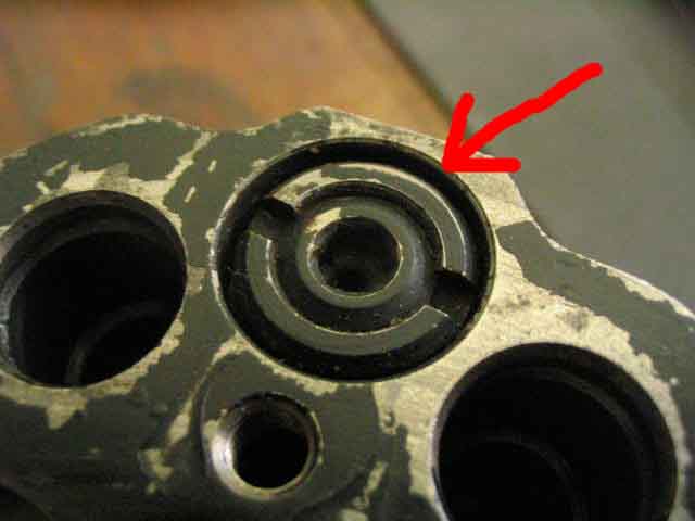

2) Once the filters and one washer are out, you need to get the four plugs on the sides out. WARNING ! don't touch this screw :
don't touch
don't touch
It regulates the pressure at full lock, and would need special equipment to calibrate.

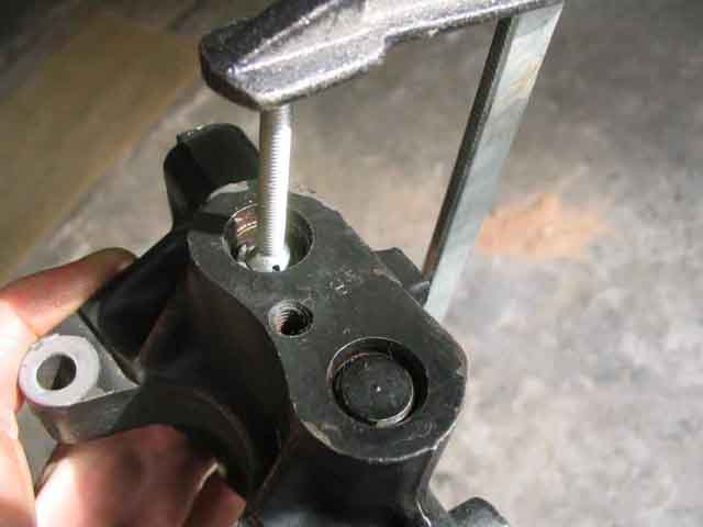

The plugs are held in by circlips, which look pretty impossible to get out. Here's how you do it :
plug
plug
You just push the plug back against the spring pressure, and then use a small, sharp screwdriver to prise the circlip out. You'll probably think of a more elegant way of doing it, but this worked. You may have to push the plugs inwards to get out the ones on the opposite side.

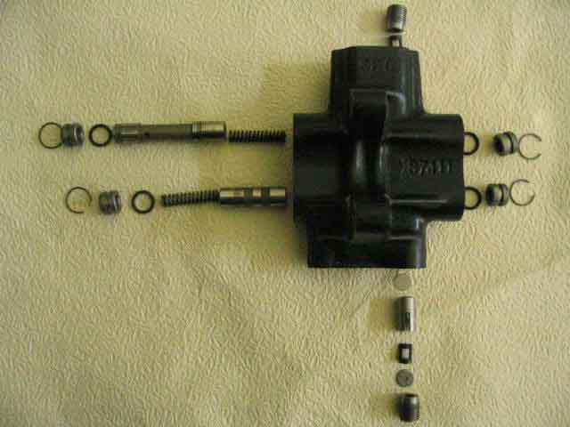

3) Take the bottom piston out on the opposite side from the filter (left side, where the spring is, as shown below, which is the FDV as seen from the motor)
explosion
explosion
because, apparently (a French guy says), the other side is not machined, and would scratch the piston. I can't confirm this, but why take a risk ?

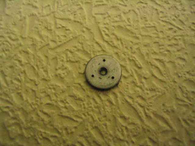

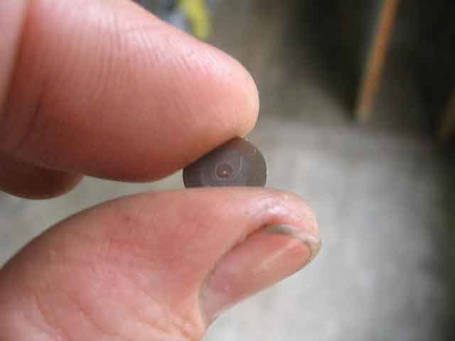

4) Now you can get the filter holder out. Underneath it is an unbelievably thin washer (0.2mm) with an unbelievably small hole in the middle :
thin washer
thin washer
highly losable, IMO.

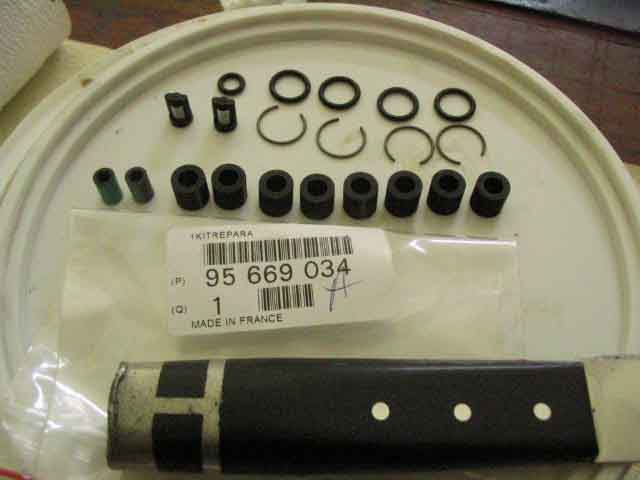

5) When it's all apart, wash in petrol. It all looked as good as new, ready for another 300000km ! Buy your kit :
repair kit
repair kit
which for some reason contains a double ration of LHM joints. Thanks Mr. Citroën !
