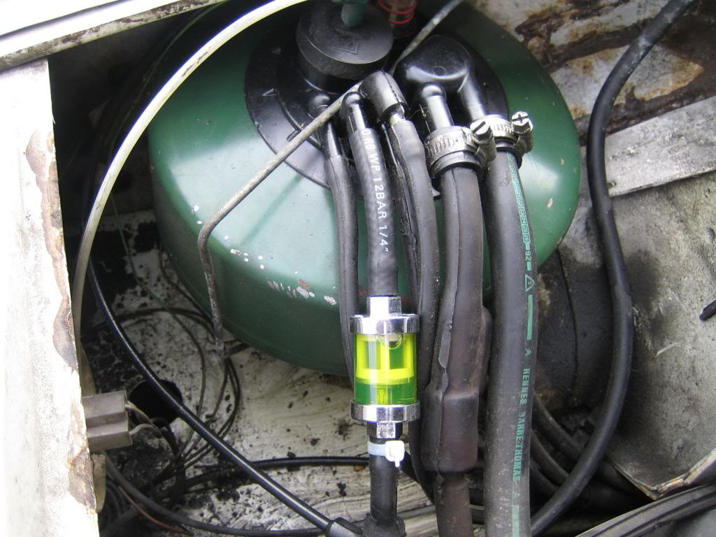

I'd also at the weekend fitted a new external filter onto the lhm tank which is a re-usable one, looks a lot smarter & because its glass i can clearly see any crap being grabbed & more importantly the colour to hopefully avoid it getting to yucky like last time. I'll post up a piccy when i get around to it.
Re: Mulley's New 19TXD
Here are some piccies of the lhm filter that i was on about:
