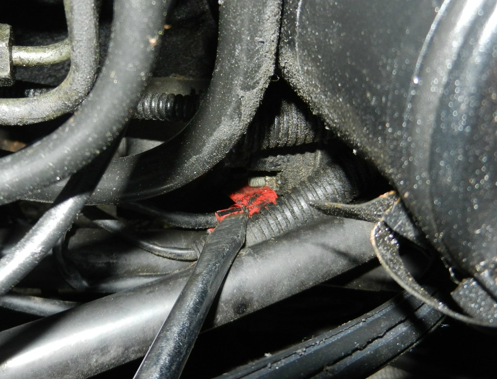

So I've got a multimeter now, tested the battery and it full of juice - 12.44V apparently, so did some more digging around the starter motor and I think I've found my starting issue.
Now who likes oily pictures ??
Where the battery connects to the silenoid there is the spade connecter to the side of it which goes off to the trigger wire, but on mine it's wrapped up in red electrical tape which must be a good thing. right ?

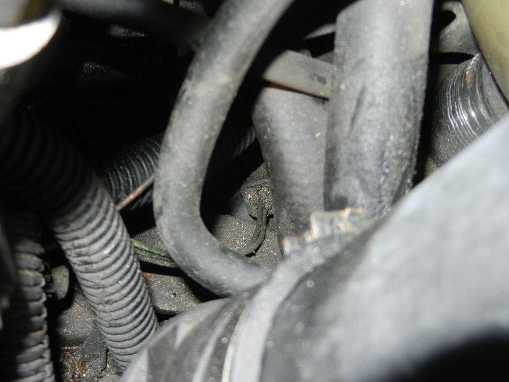

And I've found the spade clip at the end of the wire and it's looking pretty grotty too.
That's all I've been able to do today, but if the trigger wire connection is broken on the silenoid what would be the best course of action ? Would that be a whole new unit ?

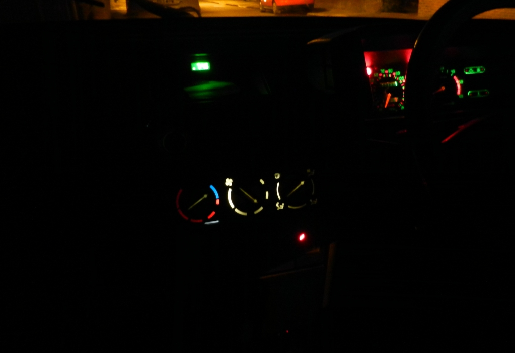

I decided I'd have a go at changing my heater lights, as well as the clock light and cig lighter today.
Got a few of these for 60p each and they came with a FREE STICKER!!!
http://www.crazyleds.co.uk/286-T5-Capless-LED.html" onclick="window.open(this.href);return false;
They work pretty well, can't see the cig lighter really but the clock now looks radioactive.

Re: The Aubergine
I think that clock would seriously annoy me but the heater controls look great!
