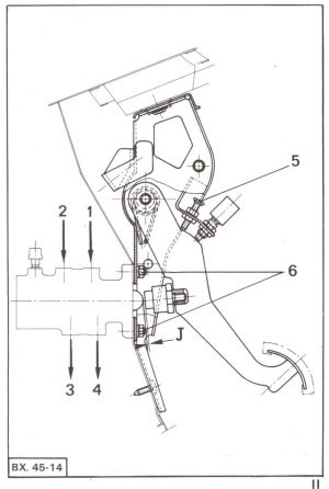

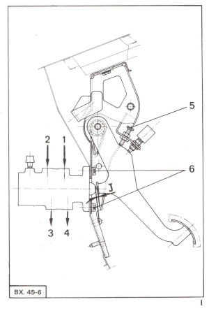

So i've been reading the workshop manual (in preparation of resetting the suspension height on the valver tomorrow!) and was reading through the BRAKES section and spotted some images that might expand on some of the topics covered here.
So the pedal spring, these are drawings of the old (Mk1) and new (face lift) pedal clearly showing the addition of the 'spring' unit;

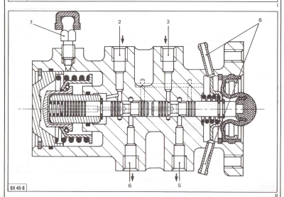

I see its been mentioned above, and frankly i'd forgotten about it, but have you yet tried bleeding the brake valve/dosseur? It's likely something i'll try tomorrow. It's labelled number 7 here;
I'm betting a bit of pedal wiggling would help to replace any air with LHM, and it does look like an air trap. It also looks to me like this could be the cause of poor rear braking effort?

Interesting pictures, shows why the Mk1 Brakes are so sharp!

I had no idea that you could blead the doseur, whats the technique?
citronut
- Posts: 2781
- Location: EAST SUSSEX UK
Re: Poor brakes
so you didnt know were all your nipples were then MULLEYMULLEY wrote:I had no idea that you could blead the doseur, whats the technique?
long time since i have bled this bleeder/point but i think you di the same as a caliper bleed, open nipple clear pipe attached, other end in to hydraulic tank, engine running, press and hold pedal down till you have a good strong flow of citro blood
what does it state the air gap should be beween the pedal and doseur????
Re: Poor brakes
You'll have to forgive my ignorance. Is the doseur in the engine bay then? Trying to work out how to access it. Not something I've had anything to do with but I'd very much like to try bleeding it.

Ian
the doseur valve is in the engine and behind the brake pedal,
in conventional cars it would be the master cylinder

Re: Poor brakes
Mk1's (upto R.P. no 2235) J = 1 to 3mmcitronut wrote:Vanny
Mk2's (post R.P. no 2235) J= 0.1 to 1mm
