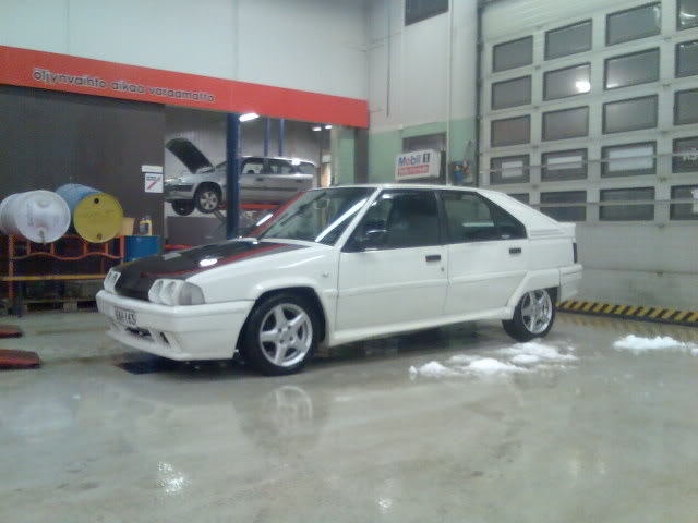

Just so you know.. Im not going to do anything else for this car, Im gonna sell it if buyer comes up. Bought a Xantia Turbo CT Activa and that's gonna take my money next

Is there a chance you will straighten that door trim now??
