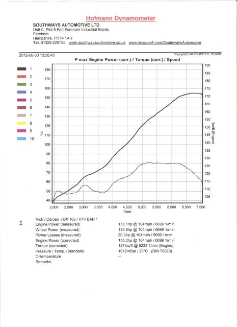

Here's a perfect example of why the rolling road is a good thing:
That's from a GT. You wouldn't know there was an issue to drive it, but there is clearly something underlying!
We tried looking to see what it was, but we saw nothing
The 16v had a better day though:
Re: Rolling Road Day
Might be a knackered back box?
Oh dear, its done intergalatic mileage though? probably somethings worn out.
My money is on lots of things being worn out. Mileage has no real bearing on it (although I wouldn't call 190k on a 27 year old car 'intergalactic') - carb is probably the most likely culprit for the spikes and flat spots in power, but I'll do a compression test and a few other checks to see what the rest of the engine is like. Cam could well be worn, but that's a pretty easy fix at least.Roverman wrote:Oh dear, its done intergalatic mileage though? probably somethings worn out.
Like I say though, until you put it on you have no idea just what's going on underneath.

Kitch wrote: Cam could well be worn, but that's a pretty easy fix at least.
You think? It seems like a rather low mileage to be significantly worn, i've no idea of the setup but can it be shimmed out like a *cough* diesel?
I've only ever seen one worn cam, on a little old lady car, around 40k, and as best we could tell it had never made 2nd gear. Shiney white lobes where not what i expected.

190k a low mileage?Vanny wrote:Kitch wrote: Cam could well be worn, but that's a pretty easy fix at least.
Did a compression test on the GT today - all was well. No.3 slightly lower than the others but most at 200psi, which was nice. I think fresh fuel, rebuild the carb and retune it before another run. until the fuelling issues are sorted (which are the main cause of the spikes in the graph) the rest might just be speculation.
