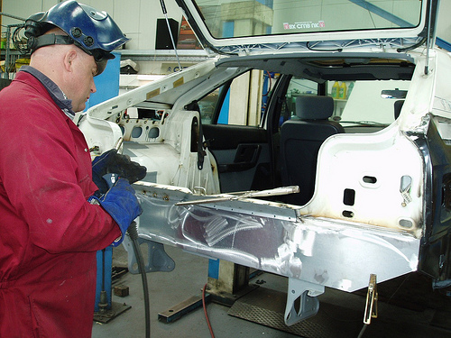

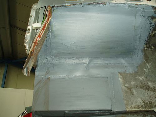

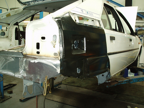

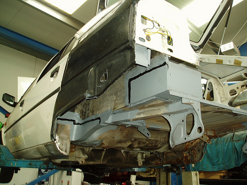

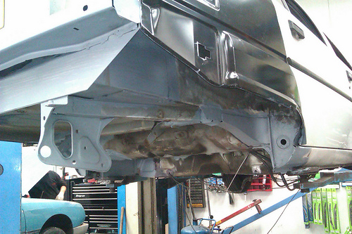

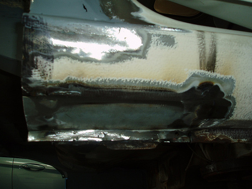

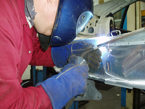

I've been a bit slack at updating the restoration project, so here is the latest. It's been steady progress, with the rear subframe being rebuilt, ready for fitting and the ongoing surgery to replace the corroded structural tinwork. The NOS rear quarter panels have been welded in and the new metal is primed. The latest work completed is welding in the new rear panel. Anyway, a picture paints a thousand words, so here's the photos...
NSR wheel arch with new rear quarter panel
Rear subframe assembly rebuilt
OSR wheel arch and box section
OSR inner wing
OSR sill welded
OSR quarter panel fitted and rear panel ready for welding
Welding in the new rear panel 1
Welding in the new rear panel 2

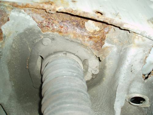

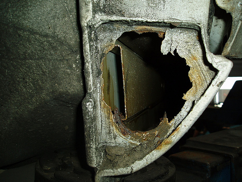

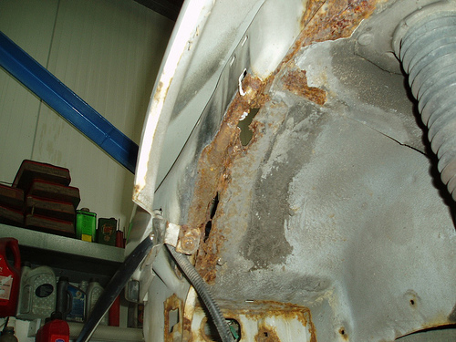

Today, work has started on the NS front of the car. Usual health warning, scenes of a distressing nature etc. FWIW, I thought this area was reasonably solid, having already been welded. No such luck. Apologies for any impending offence if anyone reading this was responsible for this 'work', but the word 'shoddy' barely scratches the surface. I think anyone who welds in a bit of metal and apparently fails to finish off with a proper anti-corrosion treatment should be emasculated with a pair of rusty gardening shears, preferably blunt.
General view of NSF wheel arch
The patch went in on the inside of the inner wing but the view from inside the wheel arch shows the extent of the rust and clearly there was no treatment or protection for the very part of the inner wing that cops the worst of conditions. Doubtless a goodly application of water, grit and salt has not done the metal any favours, but it might have had a fighting chance with a some treatment?
Here's a close-up on the suspension turret. There's quite a bit of rust, but I'm hoping it's more surface than deep. [-o< I wonder how close I was to hitting a pothole and launching the strut into the bonnet?
NSF suspension turret

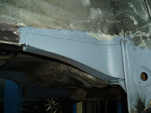

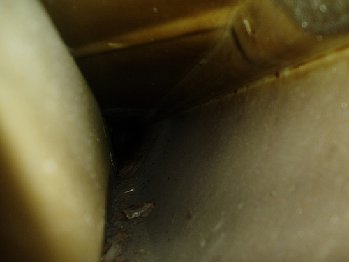

This is the front view of the NS sill. Remarkably the inside of the sill looks quite clean and the second picture suggests that it's been waxoyled.
NSF sill
Inside the NS sill
Given the state of the NSF wheel arch, I'm not looking forward to what will be revealed when the OSF wing comes off. I know there is quite a bit of corrosion, so stand by for some more shockers. Rob assures me there will be something left of the original car, but even I am amazed at the extent of the corrosion that is coming to light. At least I'll know that all the new metal welded in will be properly finished off and treated.

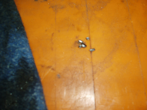

This will teach me not to upset caravan-lovers. Rob sent me this picture of some 'little darlings' he found in the gearbox. It's not immediately clear where they should be, but I suspect they're no longer doing what they're supposed to. It could account for the stiff gear selection, although I've always assumed this was down to a dodgy clutch and French precision engineering. Anyway, the gearbox is going off to get a rebuild and hopefully there won't be anymore nasty surprises popping up.

Sandre very kindly took some snaps when she was at Chevronics earlier this week. You can see the rear cross-member is back on and everything is more or less complete and primed at the back end.

Would it not be chaper just to find a 2nd hand gearbox rather than getting a rebuild?
barry badger

MULLEY wrote:Would it not be cheaper just to find a 2nd hand gearbox rather than getting a rebuild?
Yes, I wondered that. I'm looking at around £350 plus VAT for the work, which Rob subs out. As ever, its about supply and demand and getting a second-hand box with known provenance may be tricky. I don't want to be putting another box on, only to have problems again. The labour is already factored in - I am already having a new clutch and as the subframe is being swapped, there is no additional spannering to do. I haven't been very lucky with Citroen gearboxes - Back in the 90's my BX14 Flight seized solid while I was on holiday in Hereford. The AA recovered me to a BX specialist garage in the town, who did a complete new box - £600 as I recall, which even then was a bit of a 'bargain'. Then I had a gearbox fail in my Xantia - lots of horrible crunching noises followed by a bill of over £1100. I'm beginning to think I'm jinxed. Anyway, I'll keep my fingers crossed that there's no other nasty surprises. [-o< [-o< [-o<
