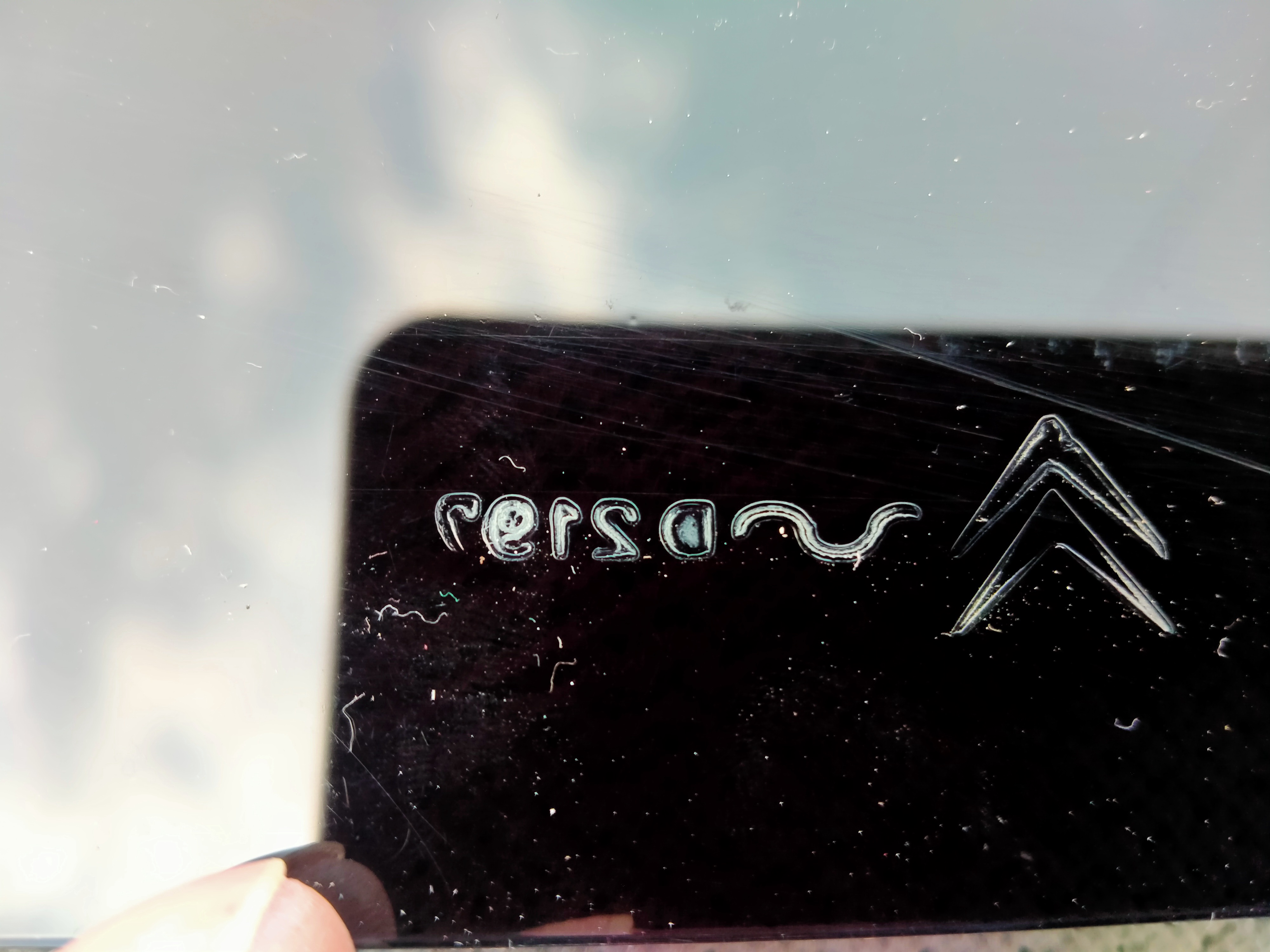

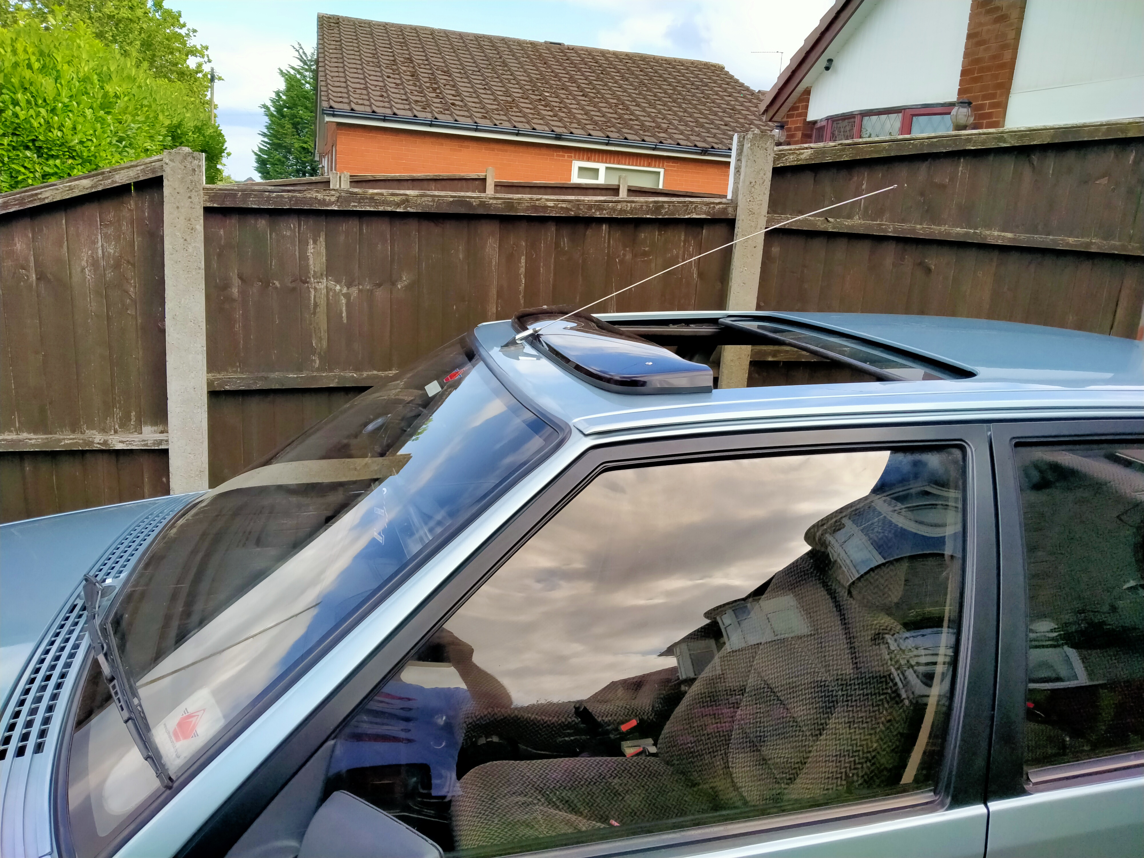

My latest Ebay bargain
I've been looking for one for a while and this came up for £15 advertised as being fitted to a Honda
Not sure if they were originally available for a Mk1 but I like it :D
Re: DKK
Lovely....what is it!
panky
Posts: 689
Location: Widnes
'88 BX GTi (a long time ago)
x 175
Re: DKK
Post by panky »
The sunroof wind deflector, I can speed along with the sunroof wide open with barely a ruffle of me curls now :D A bit less wind noise from up there too.
Re: DKK
Ah yes! Ive one on my GT, very useful

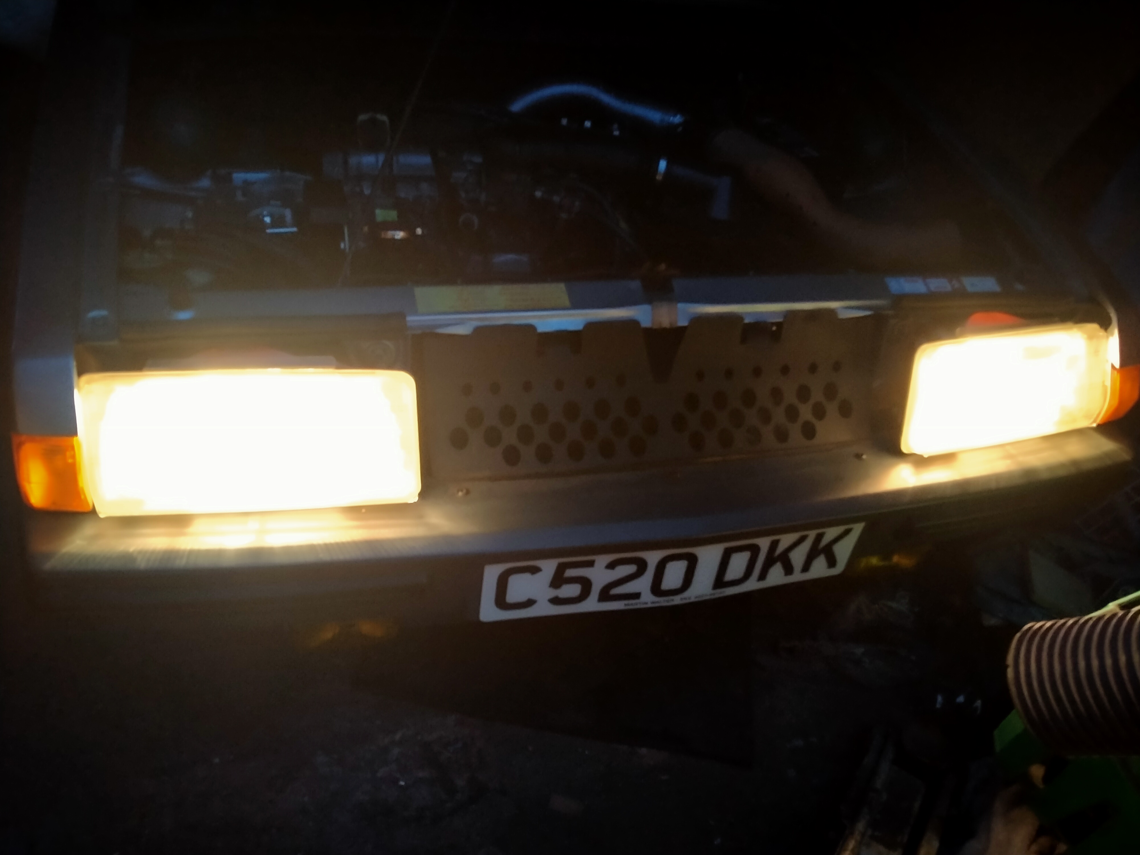

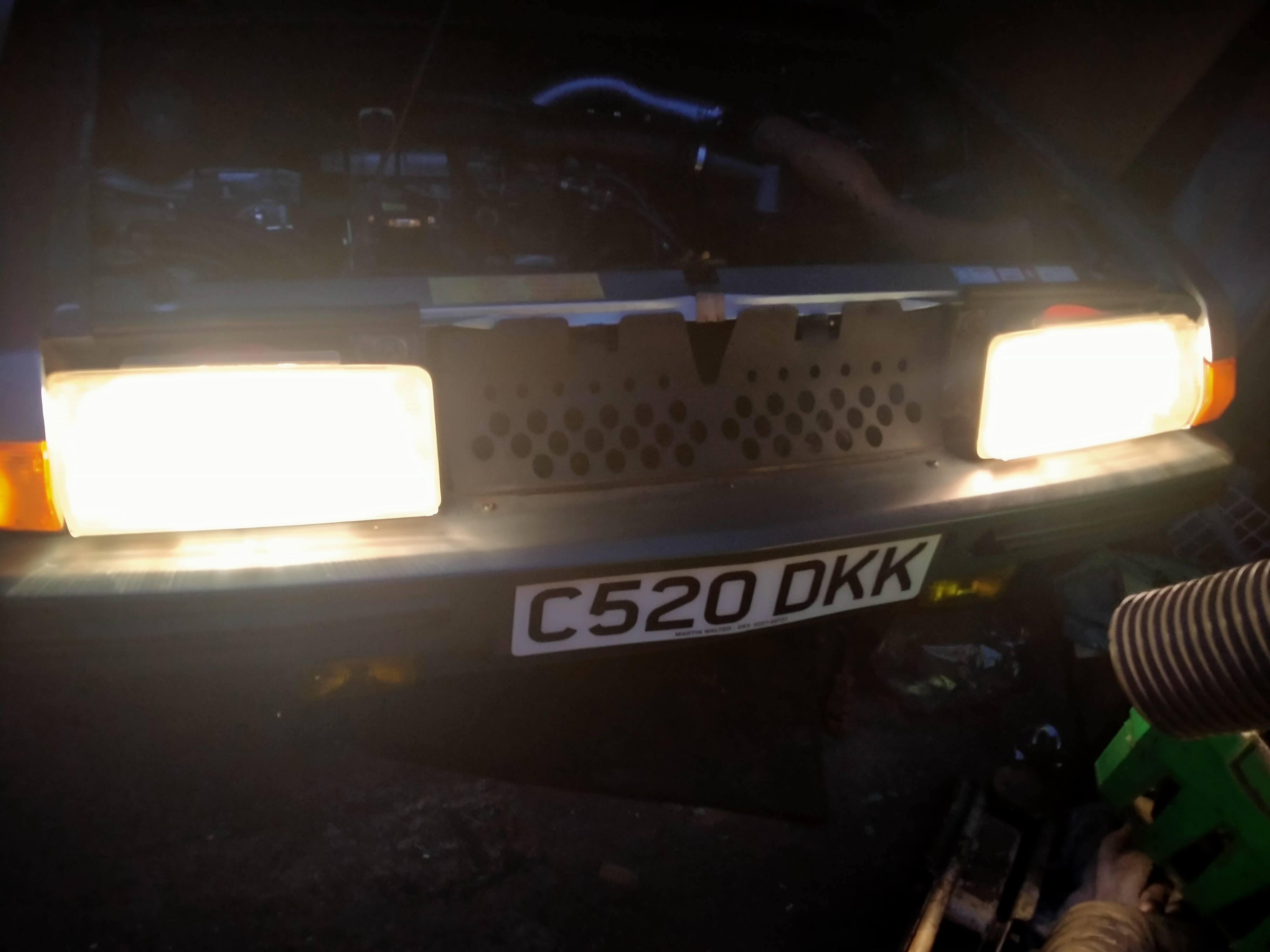

I've read a few post that recommend fitting relays to the head light circuit to make life easier for the switches so I bought a kit off ebay
https://www.ebay.co.uk/itm/365293088292
Dead easy to fit - It took less than an hour including investigating a non working side light (loose connection), finding a place for the relays and cable tying the wiring in place. The difference is noticeable even with the original bulbs so the original wiring must cause a fair resistance as the headlights are brighter now and I can safely fit the Nightbreakers I've ordered.
Posts: 2034
x 117
Re: DKK
That's a worthwhile mod then? Although I have the kit it is one I have never fitted as I just make do with the yellowing glow from the original setup.
One mod I have always done on all my BXs is to connect the dashboard lights to the lights circuit not the ignition so that I always know that I have my external lights on when needed and with the incidental gain of extending the lifetime of the bulbs.

Re: DKK
Post by panky »
Before and after
Doesn't look much in the pics but there is a difference, same bulbs with relay kit fitted.
