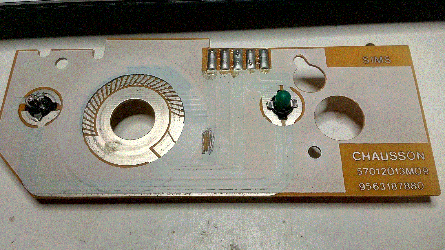

Re: The definitive heater modification
the one from my TZD Estate (with aircon) looks differant than the ones i have seen on here.. my one does not work in the full speed position (turned right up).. wonder if its a relay that has gone?
the scratched off track was already like it. its not a track though, its more like conductive paint between the tracks.- JohnDragonMan

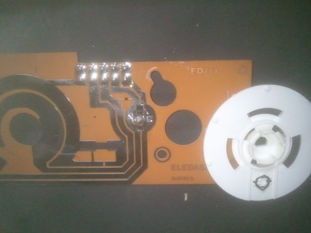

DELETED
No that is a standard one, there were a choice of 2 different types fitted the Chausson and the Eledas but both do the same thing, note the different contactors though.
Dragon Man wrote: Fri Aug 04, 2017 3:19 pm the one from my TZD Estate (with aircon) looks differant than the ones i have seen on here.. my one does not work in the full speed position (turned right up).. wonder if its a relay that has gone?
AndersDK wrote: Tue Aug 21, 2007 10:54 pmThe plot is if the high speed relay is cutting in or not.ed4ferrets wrote:I've seen no reference to the other type of circuit board, brand named CHAUSSON as opposed to the ELEDASA (Valeo) as pictured. Just wondering if it also has the same shortcoming as I've never heard the relay click when turning it to max? The pcb is in front of me but the circuits are not very clear, being covered by a protective white film of sorts .... hence unable provide a pic! This is off a K reg BX. Hope I haven't missed a previous posting asking the same thing
If you lean down to the steering column and hear a characteristic faint relay click while turning the fan blower control up, then there is nothing to modify.
If you dont hear that relay clicking and the fan does not kick into "hurricane" mode when the control is turned fully cw, then you need to modify.
It would be wise to turn off your 400Watts bass & drums before the test
hmm interesting, thanks. theres an interesting thing that happens. when i turn the dial all the way to the cold the fans will work on full speed. but when i bring up the temperature enough to lift the little microswitch (which i assume is something to do with the aircon) the fans go back to very low speed on what should be full speed. ill have to go probing with my tester..
Dragon Man wrote: Sat Aug 05, 2017 1:44 am hmm interesting, thanks. theres an interesting thing that happens. when i turn the dial all the way to the cold the fans will work on full speed. but when i bring up the temperature enough to lift the little microswitch (which i assume is something to do with the aircon) the fans go back to very low speed on what should be full speed. ill have to go probing with my tester..
That is sort of normal behaviour John. When temp is on cold you get full speed blowers - plus a gradual increase as the dial is turned. When not on cold i.e. the microswitch is out of the circuit the speed control should still work normally from slow to high speed but not quite as high speed as with the no heat position.
I think the idea is to give a bit of an extra blast when the aircon is on and no heat is required.
If the blower circuit board has been modded to get the extra speed it is possible to kill the normal speed control operation. Don't ask how I know this!!!

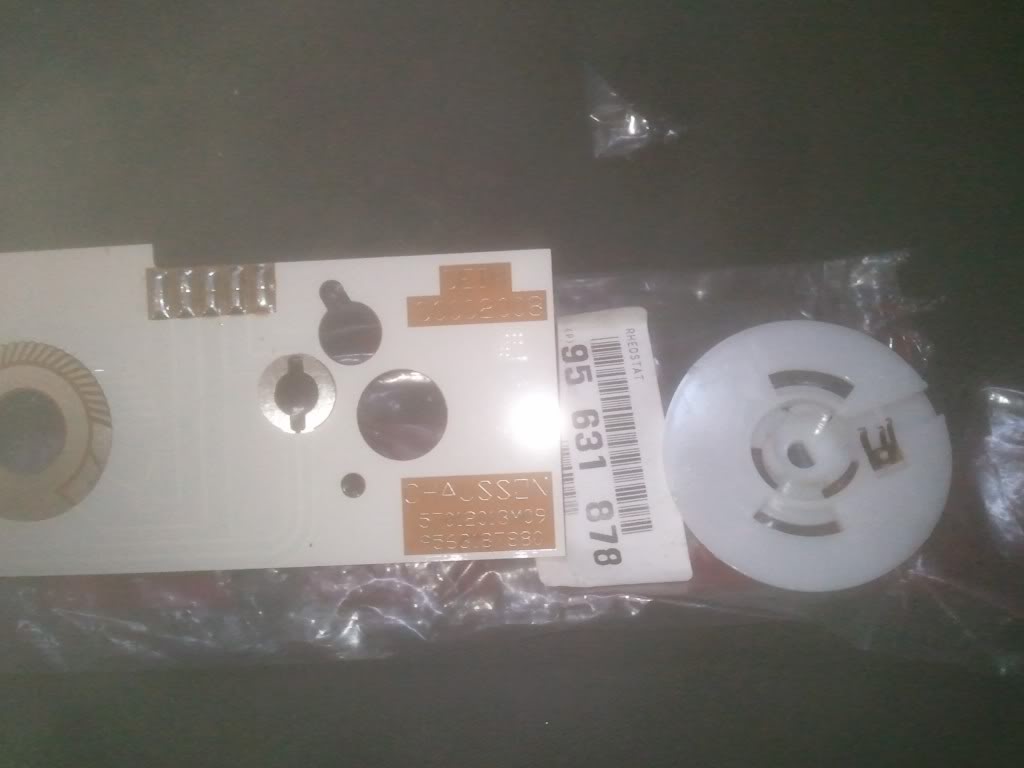

I've (now) got an unmodified Chausson one, and that does indeed operate the relay at full chat (on this car, anyway). The Eledasa ones don't, unless you carry out this modification.
That rather conflicts with previous comments above about the Chausson model. (Thought they were camper vans and they never go fast).
It does, and I'm not quite sure where those comments came from. My understanding was that the Chausson ones are wired correctly, and the Eledasa ones - for whatever reason - weren't. I've got an unmodified Chausson one (typically from the earlier mk2 cars) and it clicks the relay in and out. It's the only Chausson one I've ever had.Jaba wrote: Fri May 29, 2020 9:34 am That rather conflicts with previous comments above about the Chausson model. (Thought they were camper vans and they never go fast).
