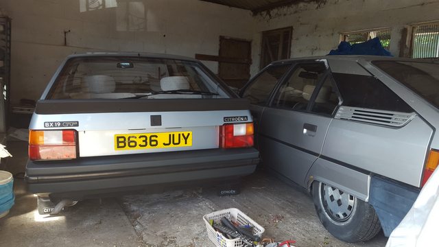

Anyway, onto BXing! Today I went to see the GT and spent 2 hours fiddling, i'm working a night shift (right now, typing this in between work) so wanted to be home and in bed for 2pm to have a pre-shift sleep. I wanted to fix a little fuel leak from the fuel flow meter on top of the radiator top-mount (for the GT-only fuel computer 8) ) and look into the fuel flap that has never properly sealed, on the challenge fuel was splashing out of the flap on those mountain switchbacks! So that needs looking at.

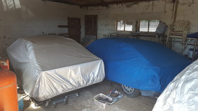

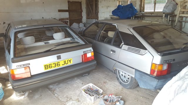

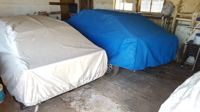

Here they are, two BX's in a barn.

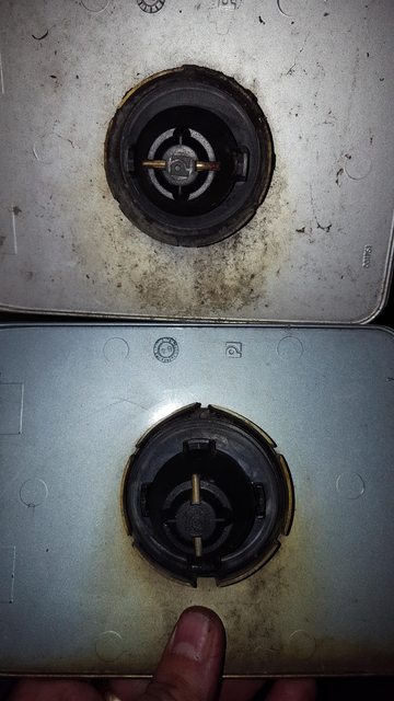

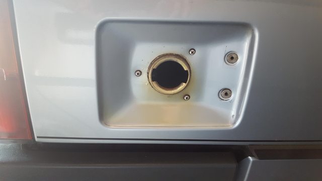

The fuel flap was similarly easy, the insert to the flap that contains the lock and the sealing part was upside down! I hadf the french TRS to compare with thankfully to confirm my suspicions. There is a tab that fits into a cutout, but someone on this car had forced it into the spaces between the clip lugs that hold the the thing in. Unfortunately this had bowed out the plastic fuel flap slightly so we'll see how this gets on when the ol' girl is back in use.
You can see where the retaining lug/clips at 'north' of this insert are pushed out and bent.

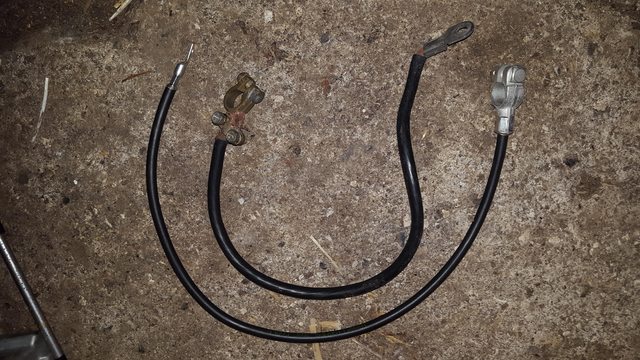

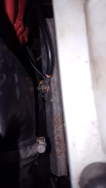

Phase 1 of the great aircon challenged has commenceth! I spent considerable time over in the barn today tinkering. My main aim was to sort the battery electrics and earths for the TRS so it started and ran better, I can report a full success here! I started fiddling, but got cross about the lack of access so removed the air filter housing, such a huge great thing on a MK1! Access now solved, I removed the battery to gearbox earth and battery negative lead and it really is no wonder that it struggled to turn over with such poor earths.

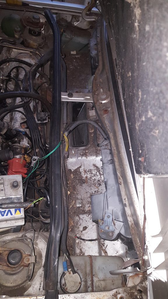

Rusty, frayed and split battery earth cable with it's *slightly* large replacement, I wasn't sure of the length required so went a bit OT!
Battery negative lead was passable, but now much improved.

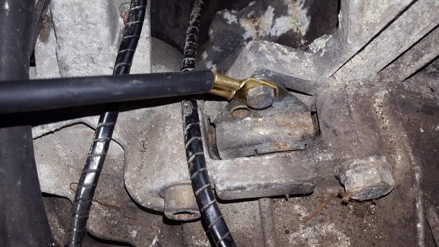

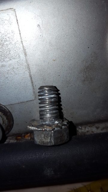

Next issue was the gearbox top earth point, on removing the bolt the thread came out with it! So no good now, a different earth point is required.
Not sure what this little guard, well - guards! But it was a convenient earth point once the metal was nicely cleaned up.
There was an additional, small battery earth wire going from the negative lead to the body (inner wing), the new neg lead didn't have the facility to introduce additional leads, so I compressed the cable end between the two big spade connectors for now on the battery clamp. I will get another spade end - I didn't have any of this size with me, but it worked fine so hopefully will do for a bit.

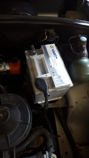

The GT got a new battery! I couldn't be doing with keeping swapping the battery from one BX to another... I have been very impressed with the GT's old battery, it has lasted ages and has been almost completely discharged a couple of times and not regularly run very much at all over the last 8 years, so I went for another Varta, but an upgraded one just because.

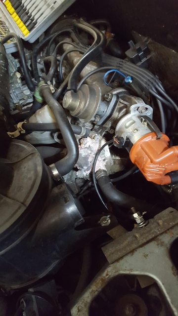

I ran the TRS for a little while to it got upto temperature, it hasn't been run since last august so i'm sure it'll do it some good. I also wanted to shuffle it around a little so access to the barn was easier for the other tenant. I really could do with changing the oil, it's probably utter crap by now. I took a video which i'll attempt to upload tomorrow, a couple of observations:
-Black smoke when you rev it hard
-Had a couple of bubbles in the coolant after it was turned off (slightly concerning)
-Still hunts at idle
-After tapping the carb body with my hammer, the periodic stalling seems to have gone away (blocked float maybe?)
-Not running right still, after a bit of a rev it dies off and either stalls, or may idle.
-Exhaust sounds odd, I wonder if there is an obstruction somewhere.
-Tyres flat again!
-HP belt squeaky and irritating
-Turns over really quickly now the earths are sorted.
-No leaks!

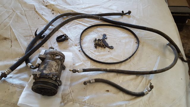

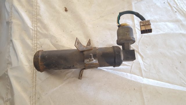

So when it was in the correct position, up on axle stands she goes and remove a/c components-a-go! Wheel arch liner piece with compressor shield, nifty.
Dryer, off. Will get a new one as this one is bound to be rubbish by now and they aren't hideously expensive.
Oil coming out of the a/c hoses going into the expansion valve. Thought these lines should contain gas not oil! NB the amount of gas that came out when I disconnected the 1st hose was not even enough to disoldge the dead spider next to it, so no wonder the system was in/op.
Lots and lots of swearing, clanging, adjustment of position (above, below, sideways etc) changing of tools and extensions later yielded this. A dissassembled engine bay a/c system (not the condensor, ran out of time), the worst parts were the two rear compressor bolts, they were very difficult to get to with averything else in the way (including the body of the compressor!). The a/c hoses were also on REALLY tight, even when the retaining nuts were removed the rubber seals took quite some effort so the hose could be removed.
Does anyone have thoughts on re-using the hoses or having new ones made?

Hi Tom, those old hoses will be brittle by now and will anyway be much more porous than newer hoses. If you decide to get new ones then you could have two new charging valves fitted somewhere near the condenser and drier connections making access easier and keeping them away from road spray. The new hoses probably wont be cheap.
As the oil circulates around with the refrigerant its probably best to get it all flushed out before regassing, especially if it is still R12 mineral oil which is not compatible with the later R134a oil.

The A/C system contains a measured quantity of oil, most lives in the compressor, but some circulates with the refrigerant and there is always some in each component, making it difficult to guess how much oil to add when recharging a system that has been drained or had parts replaced. Talk to your A/C tech, he may want everything flushed out, or he may want it left as-is.
If the A/C system was originally filled with R12 gas, it will need new charging ports or adaptors added for R134A. R134 leaks faster than R12, so it is recommended to have new hoses made.
I have had 4 old Jags converted over the years, on one I had new hoses made, no problem other than expense, the next I tried with the original hoses, but one was porous and you could just about see the oil oozing out through the rubber, I had a new hose made, but the fitter was a bit ham-fisted and broke the evaporator fitting, so that was a big waste of money. The next one I did not change the hoses and there were no leaks. The last I did had 1975 hoses and no leaks, but after a while a high pressure hose popped out of its crimped fitting. So you can take your chances.
Make sure you find a tech that has experience converting R12 systems so that he has the knowledge to use a compatible oil and calculate the correct gas charge weight. Even better if he has crimping tools for making up hoses.

Thanks for your replies and advice folks. I've organised a compressor service and conversion to R134a, not cheap! But better than putting an unknown unit on the car and spending ages tracking down faults.
I'm investigating how to get hold of new hoses, there isn't anyone obvious who's local to me, so I'd be grateful for any recommendations you learned chaps might have.

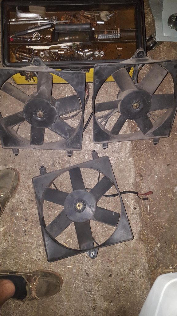

I was expecting to have to swap the GT and TRS radiators around, as the twin fan setup will be needed on the GT for the a/c, so to avoid starting messing around with coolant draining I had a go at the blower motor/fans first. As i'm sure most of you know, a/c cars have an additional blower fan, It was quite fiddly to get it all out, after struggling to get the last bolts out I gave in and took the windscreen wiper arm and scuttle panel off, which is necessary to remove the blower unit anyway, so really I shouldn't've been so lazy and just removed it in the first place! This is good, as the GT's wiper arm has shed the majority of its paint which has been bothering me for quite some time! It is one of those little jobs that will get sorted 'one day', but now the wiper is off I can actually get on and do it. Satin black should do the trick I think.

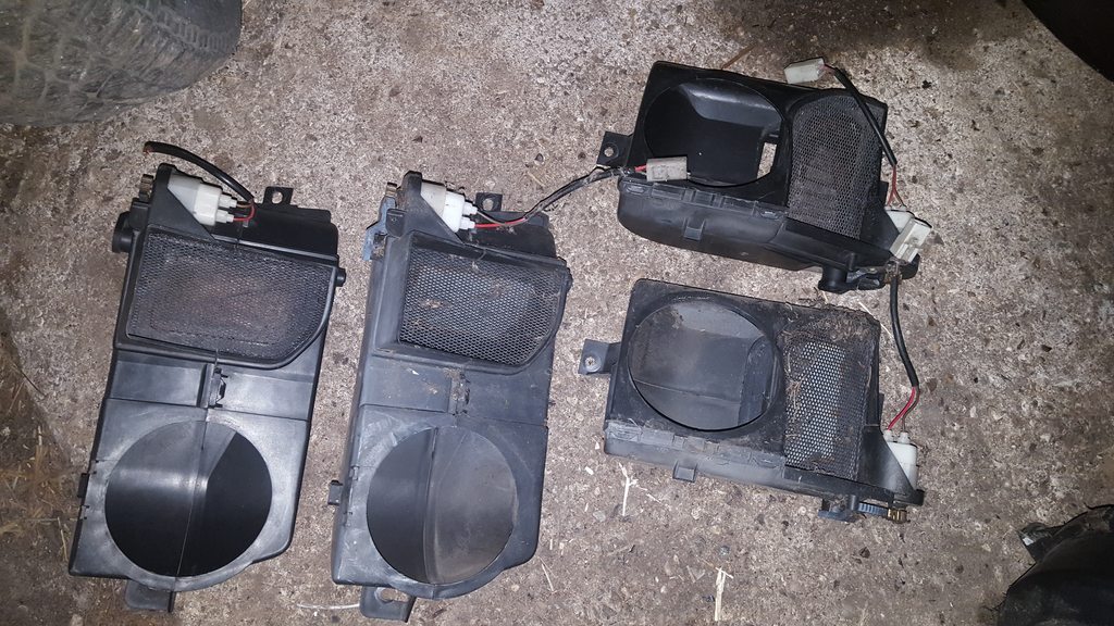

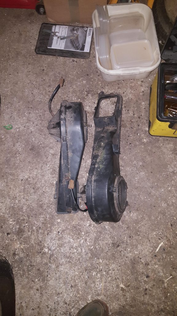

You can see where the additional blower fits onto the cutout in the standard (larger, on the right) motor.
Recirculation flaps, clean ones (top and far left) from Alex should work lovely, TRS units (bottom right and middle left) didn't work on the car but whos knows what electrical fuckwittery is going on.
Waaaay back when I was hunting down individual a/c components I bought some stuff from a lovely guy in Germany (Alex, BX 14 GT on here) who had converted his standard fuel injected MK2 14 to have a MK1 dash, he wanted to also have a/c but the car ended up being very rusty so was to be scrapped, IIRC he found a way to get the BX welded affordably after he sold me all his a/c parts :D The point being I have a choice of additional blower motors and recirculation flaps, Alex cleaned up the ones he had and tested them, so if the TRS ones don't work, I have these nice clean ones to use.

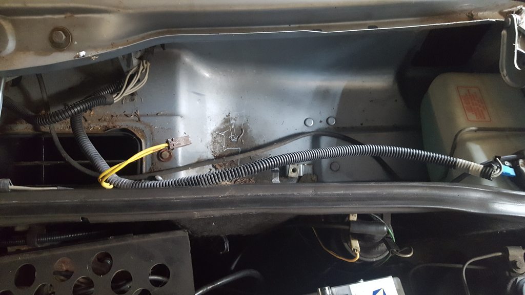

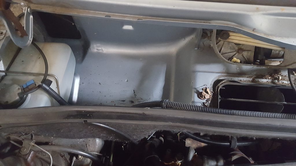

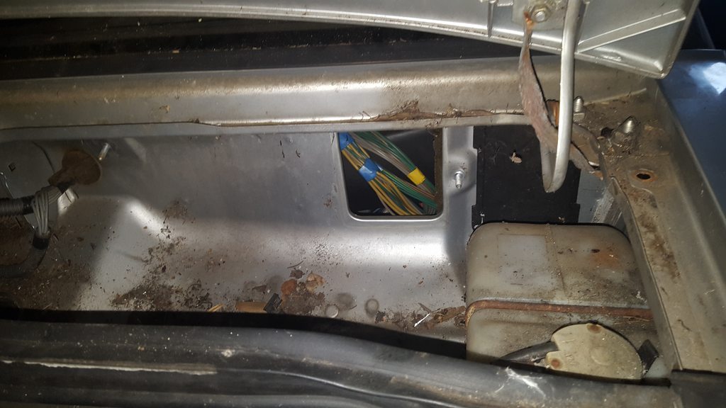

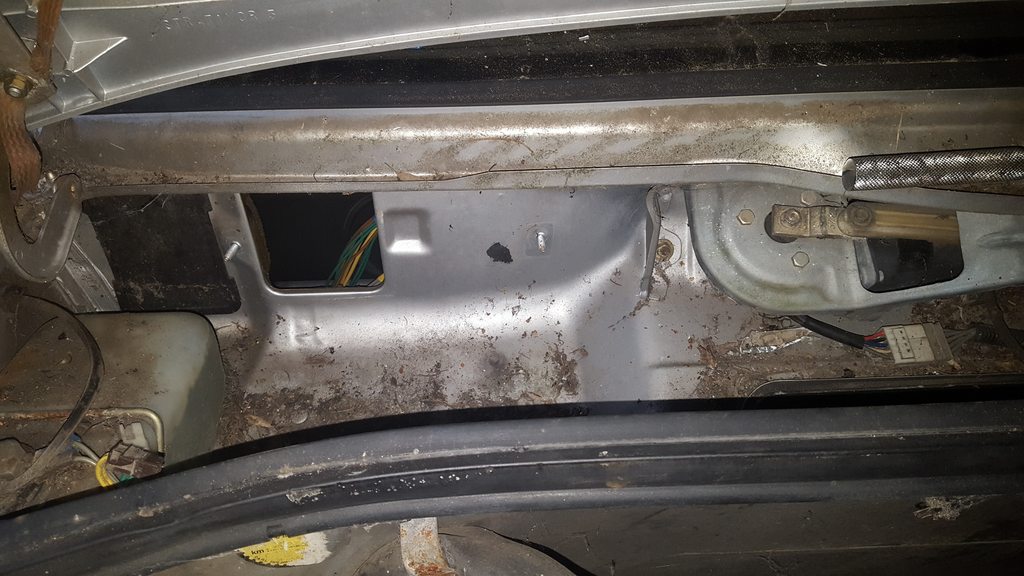

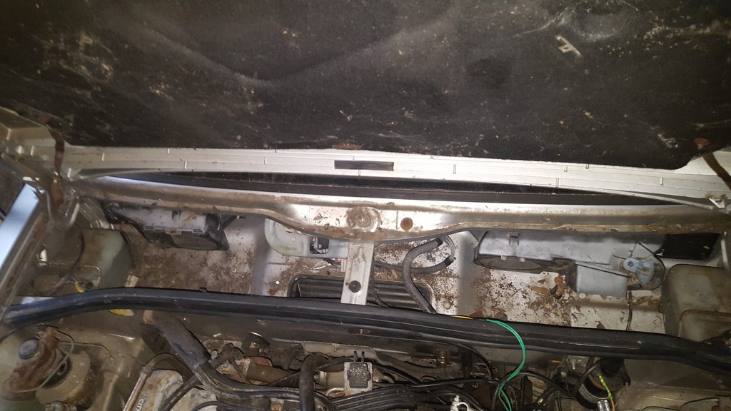

What filth! Lots of crud under here! Blower motors removed, but recirc flaps in place still, interestingly both the recirc flaps and blower motors seem to be wired in series, so creating an extension of the GT's wiring (at least for the blower motors) shouldn't be too difficult. Another interesting point (keep you socks up folks), the airflow in the GT (one blower fan) feels about the same that in the TRS (two blower fans), maybe even better! There are lots of factors that could influence this, including the GT (non a/c) haveing a 1, 2 or 3 fan speed settign whereas the TRS (a/c) has a continuously variable slider for the fan speed - i'm hoping it is just dirty contacts or something but we'll see whan it is all cleaned up and transferred to the GT.
Recirc flaps gone, I had forgotten I will need to drill and cut the GT's bulkhead for these. I'll also need to drill a hole for the dryer and in the bulkhead for the hoses to attach to the expansion valve on th interior. The dryer could probably be mounted without drilling a big hole in the inner wing to be honest.

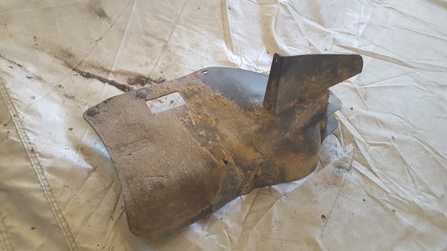

In the absence of recirc flaps, the GT seems to have an exterior air exclusion flap - this is what can be heard closing I think when you move the fan control lever to '0', or to the left of 1 at least. I also removed the GT's single blower unit, the scuttle panel and wiper blade too of course.

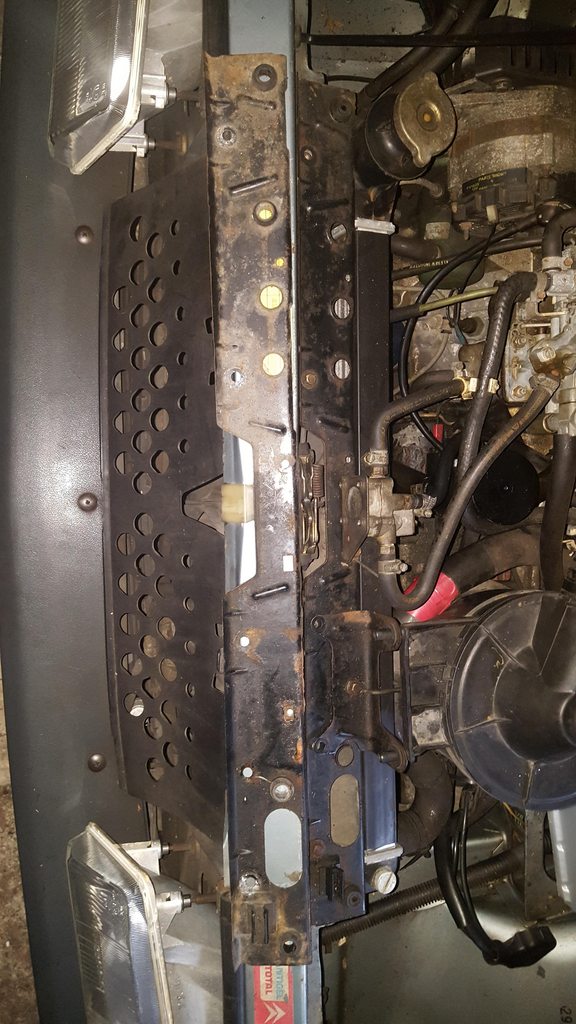

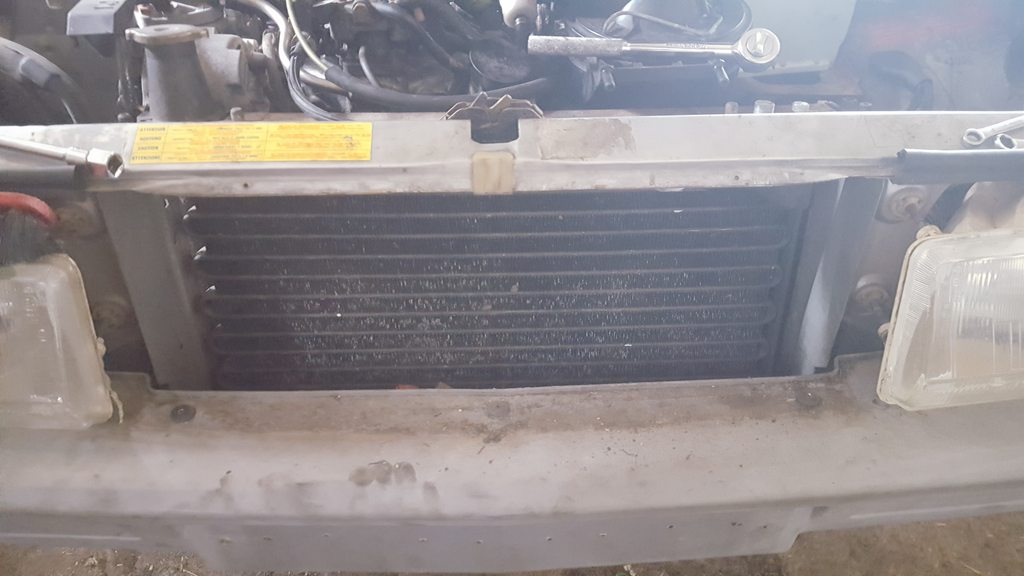

Next, onto the condenser! I was a bit anxious about this, I was really hoping not to have to find and purchase a new one of these as the cost of this a/c project is ramping up - not that I expected it to be cheap, especially having bought and imported a whole BX for the purpose! Thankfully, it looks ok, there are no crystals or obvious evidece of a leak, but then with a/c refirdgerant baing a gas I don't expect there to be much to see if there was a leak. The condenser slots between the radiator and coolant fans, it has lugs that sit in a lower support panel and is held in place by the top radiator panel, so once the top panel and fans are off it just lifts out, simples! I likes simples.
Two top panels are the same = good. Do I go the whole hog and paint this? Maybe, it'd be nice.

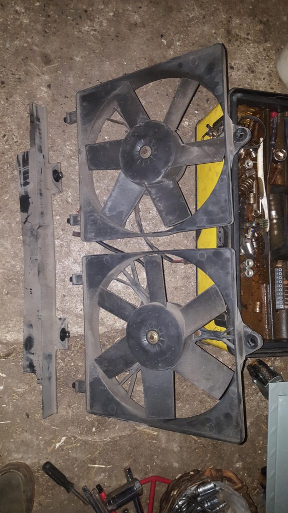

Twin fans and top mounting bracket easily removed, the most difficult bit is unplugging them! Silly electrical connectors are behind/underneath the passenger headlight (RHD) with all sorts in the way, I was reluctant to give them a good tug because french electrics.

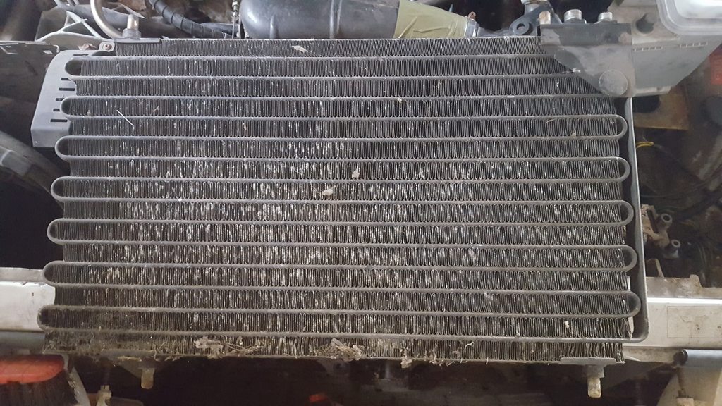

Fans removed gives surprisingly good acccess to the condenser.
Dirty, but looks ok (I think!)

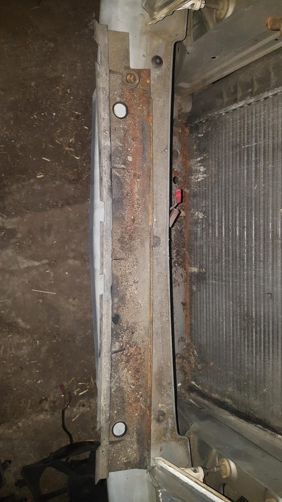

Condenser bottom support panel, needed to swap over the rubber bungs as the TRS ones had an extra slot in them for this panel.

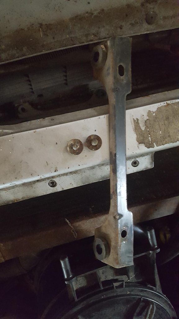

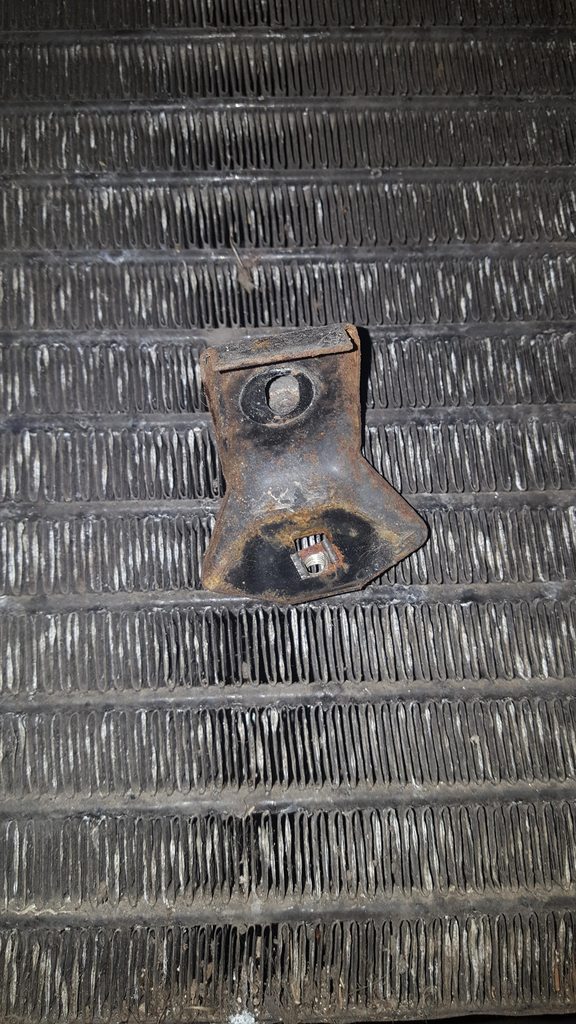

The extra fan upper (1st image) and lower (2nd image) mounting brackets are very sensibly bolted onto the car, whereas the original ones are welded or bonded, this makes swapping over nice and easy.
HOWEVER, how on earth do you install captive nuts in panels or box sections where there is no access? I think I will have to drill holes in the slam panel and the cross member underneath the radiator to allow me to secure these mounts. Is this going to be a structural integrity issue? Being ignorant, I would hope that drilling two lower (under radiator crossmember) and one upper (slam panel) 10-15mm hole would be ok?
Where the slam panel hole would need to be, drilling though the top to allow a nut to go inside this section above where my finger is. Not sure what the triangle is all about, it was under the yellow sticker I peeled back! Here a new sticker could go over the top of the hole, making it neat and tidy. I'm sure I sawa new set of enginebay stickers on ebay recently, must investigate.
It seems that MK1's used a set of two single fans, I was expecting them to both be in a single unit. The TRS' fans are the top two and the GT's the bottom one here. I wonder if MK2's used the same?

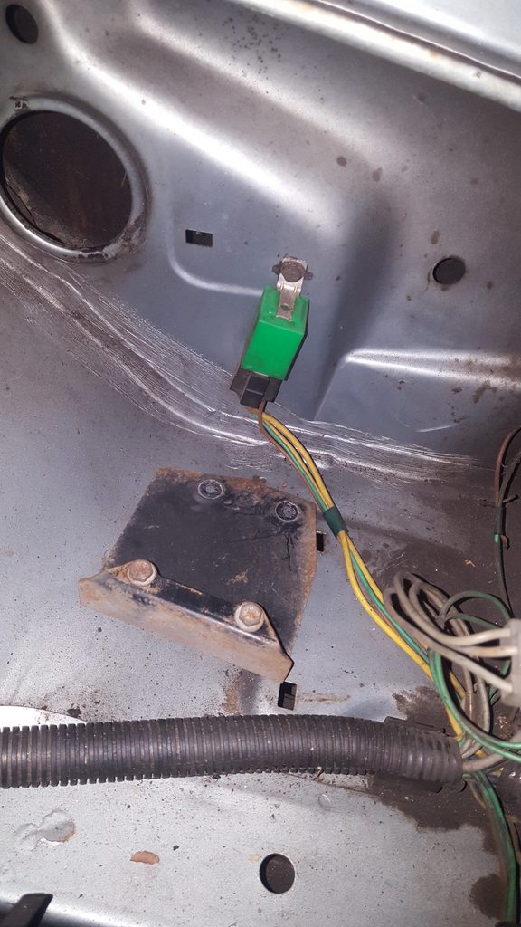

I stole the TRS' relay mounting bracket, it has 6 relays whereas the GT has 1! I have a few wiring diagrams/technical bulltiins so I can hopefully figure out what relays I need and where, but that can wait till I get into the dash and need to think about all the wiring requirements, i'm not looking forward to that tbh. For the TRS I'm thinking a relay or two for the radiator fans, one for the compressor and one for the air blower motors, maybe one for the autobox too?

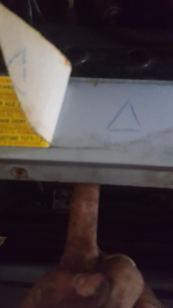

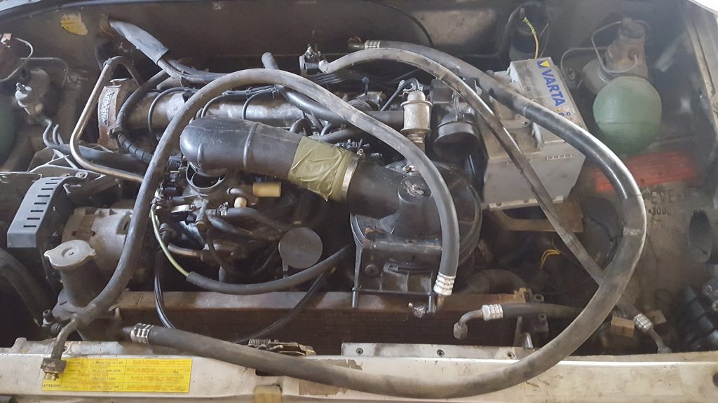

I realised that after I removed the a/c hoses, I didn't label or photograph them to know which go where! A very nice man, and a proper BX'er has offered to make me up some new a/c hoses at cost, so I have these at home ready to be sent off now I have a record of which goes where!

saintjamesy89 wrote: Thu Jun 11, 2020 5:36 pm HOWEVER, how on earth do you install captive nuts in panels or box sections where there is no access? I think I will have to drill holes in the slam panel and the cross member underneath the radiator to allow me to secure these mounts. Is this going to be a structural integrity issue? Being ignorant, I would hope that drilling two lower (under radiator crossmember) and one upper (slam panel) 10-15mm hole would be ok?
Probably the easiest way would be to install rivnuts - if you're installing a lot of them best to get the proper tool, but for a few it is possible to improvise with a screw, nut and washer.
Basically hold the allen key stationary, and use a spanner (ideally a ratchet spanner) to wind the nut towards the rivnut. An oiled washer between the nut and rivnut stops the latter from also rotating, so compresses it and locks it into place.

That's great info, thanks Matt! Will look into those Rivnuts, saves me drilling holes in panels. I'd love to borrow your a/c manual too :D

Hoses sent off for copying, Mat and i have discussed alternative charging ports as having them aylt the compressor couplings risks all sorts of road dirt, salt, grime and wet.
