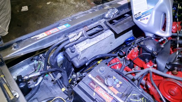

Hey guys,
today i fitted the wings on fully and really tidied up the LHM returns.
heres a few pictures:
it looks a little complex but in all of this, the Octopus now lives. from where the octopus should sit, all i did was extend all of the pipes up to the LHM tank and build everything there. in all fairness i think it does not look half bad. nice and accessible now and each part 100% user serviceable (just the way i like it.. if not i make it user serviceable hehe).
the one pipe left open is the return from the front accumulator sphere.. flow distribution valve? i will pipe that one up when the engine is in!

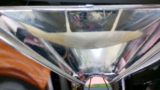

heres a few close ups of the head lamp reflectors:
So what i am going to be doing is fitting some bi-xenon projector lenses. bi-xenon meaning they do both high and low beam.
the hard part will be getting a small "window" ground into the original headlamp's glass so the original markings on the head lamp wont affect the cut offs of the projector lens.
the aim is to make the headlamps look as if the car does not have them. besides the small circular shaped window in the centre of the head lamps, they should be unnoticeable. as far as legalities go, it does not matter what kind of headlamp produces the output light so long as it is in the correct beam pattern and level with good cut offs.
actually, does anyone have any left hand drive headlamps? or just the glass from out of them? i'd rather damage some left hand drive lamps than the more rare right hand drive lamps.
its a tough thing, once you go projector lense you never really want to go back. i only use 55w halogen H1 bulbs in project fallout but the beam and cut off compared to the original lamps are worlds apart.

i also got my projector lenses through the post. look at that beam cut off..
ok.. how about the high beam...
pretty good...
now lets put the glass over the headlamp and switch it back to low beam...
oh dear.. the cut off is now just a blur and the ridge has just gone! plus look at all the glare it gives now! only one way to fix that..
next job is to grind smooth a small circular "window" in the middle of the BX's head lamp glass. i need to remove all of the ridges/fluting where the light from the projector lense sits. this may be a challenge..

hey guys!
well i have done a little more work today.
i have flushed the engine with diesel a few times. only cranking on the starter just to wash out any old stuff. i did this till the diesel was almost clear. then i put the new oil in with a MANN W712/8 oil filter.

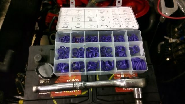

i have also replaced all of the external air conditioning piping seals too.. i think i just have to do a few under the dash. i have also filled the compressor with 135ml of PAO oil too. i am holding the system in a vacuum for now till i can get someone "trained" to fill the system for me.
as you can see, the radiators are in now:
nice "Green" seals..
