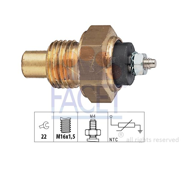

Chris, does your sump have the hole for an oil temperature sensor (on the front face I think)?

Went underneath today, and was surprised to find what looked exactly like a second sump drain plug, a few cm immediately above the one used for draining, on the rear face of the sump. Presume this is for the oil temp gauge. Unsure of its thread, but oil needs changing before long, so will pull it out and see.

These are apparently the dimensions of the sender

Later on, Mike, I managed to pin the pt.no. down - 0242 50 .
Found a couple on Mister Auto: that FACET 73099, and an FAE 32080.
Have already put the wiring run in (when I did the coolant temp gauge), so an easy addition.
Not desperate to know about oil temp on the diesel, but it does seem daft to have a gauge not showing anything.

Well, the oil temp sensor arrived today from Mister Auto - an FAE 32080 (made in Barcelona).
A slightly dated-looking small box, with pt.no. FAE 3208.
The brass sensor is the right one, but date-marked "1 94", so pretty much as millésime as the car!
Interestingly, it's also listed for a new Mini Cooper.
Oil change next week, so good time to fit it.
Do I really want to know about oil temp? Too late now...
