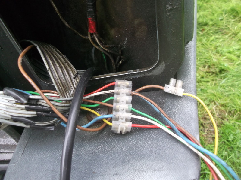

Started with replacing the tow electrics, which as with everything wasn't as straight forward as hoped:
Hmmm, something not quite right here
I think I got it sorted in the end, although I'm still not sure why they did this

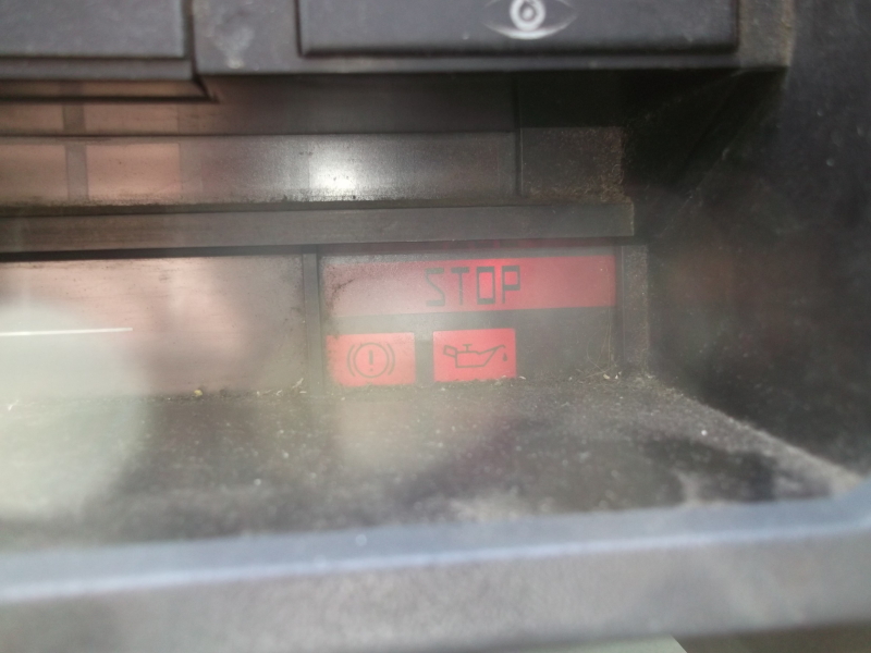

I then changed the oil pressure switch. Now the oil pressure switch lights up:
More importantly, it goes out again when the engine starts.

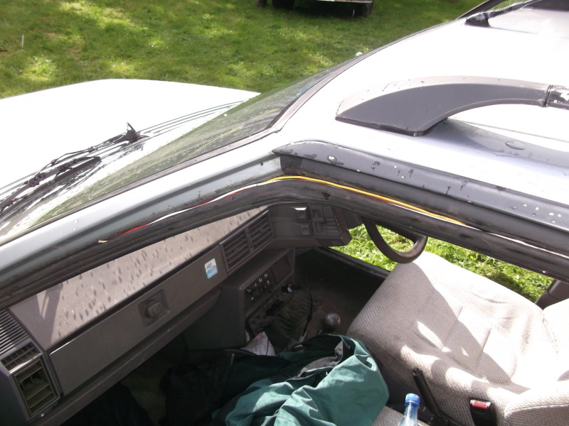

During the storms the water was pouring in through the front passenger door, so I used the wire from the old tow electrics to force the seal out a bit - seemed to help:
