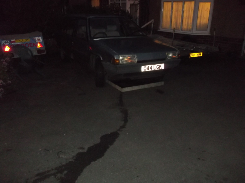

My mate John has kindly let me use a space on his drive to work on it this week, but as they're digging up his road tomorrow I tool it round tonight, after topping up the coolant again! I think the water leak is getting worse:
x 13

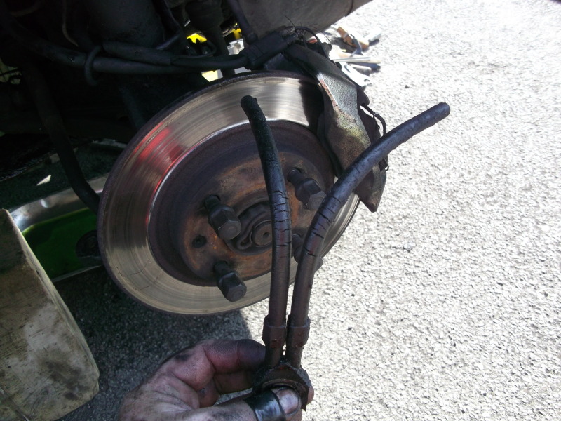

Today involved lots of swearing an getting very, very oily! I changed a strut return pipe as the old one was slightly cracked:
the new one actually went on better than I expected, as last time seemed to take ages!

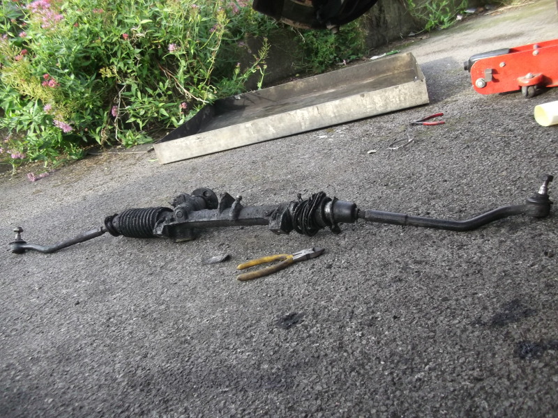

There then followed an afternoon of fighting the steering rack, not helped by a less than helpful Haynes manual. The feed pipes in particular were stubborn, one of which seems to have unions that need an 8.5mm spanner :? , and ended up getting cut :evil: . It came out in the end though:

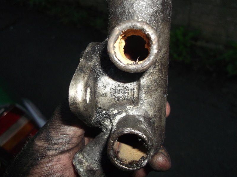

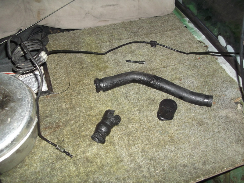

With the rack out of the way, I then removed the damaged hoses. The one that had actually failed came out relatively easily, but the joining pipe that wasn't leaking but looked about to fail was more tricky - in the end I removed the alloy casting on the back of the engine that both these hoses plus the radiator hose all attach to. It was when I was cleaning off some corrosion to the outlets (hopefully not bad enough to scrap the part [-o< ) that I made an interesting discovery:
That's a date mark cast into the housing, and it's 1985! It seems that Timex may have it's original engine after all, but fitted with a later head \:D/ . I may have a lead on an early head, so watch this space!

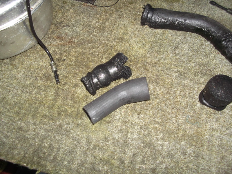

The blanking cup I'm replacing as a precaution due to the state of the other hoses - god knows how the joining piece wasn't leaking as it's in shockingly bad condition. Unfortunately the part I bought to replace it is both too long and too big a diameter, although I'm not sure if the latter is down to a design change or reduced diameter of the outlet on the casting as a result ofmy cleaning off the corrosion:
