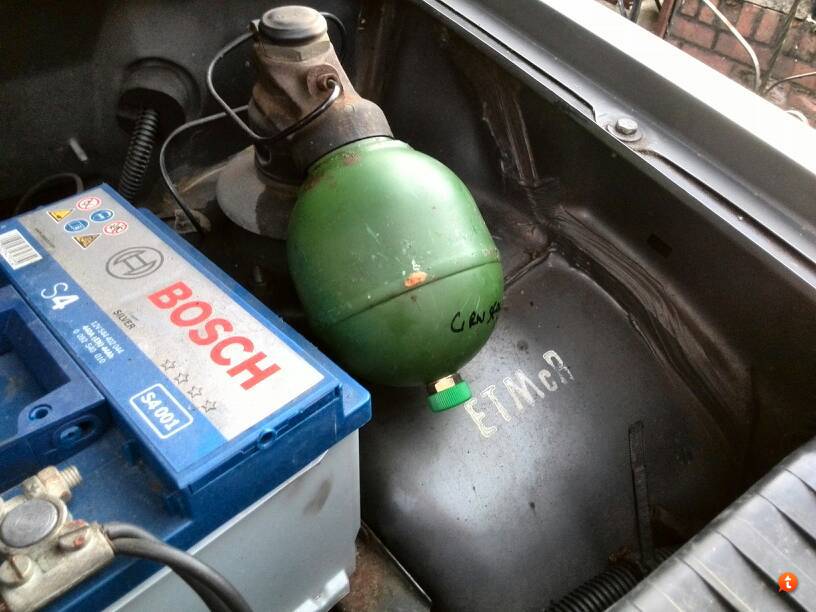

Had a call today from Simon who is doing the spheres. Generally speaking they are all down 10-15bar pressure. The spheres themselves all look ok so he will regass them. He also commented on how nice the car was underneath.

Two freshly gassed spheres and the auto box dipstick. I think that should be red.

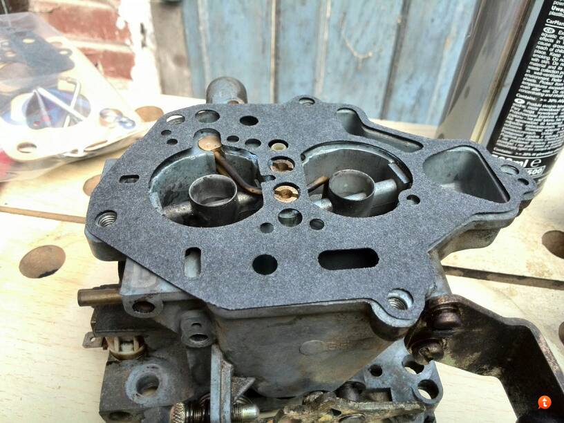

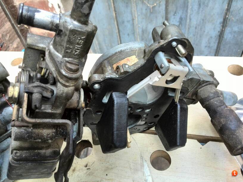

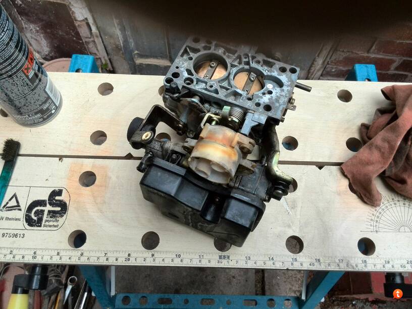

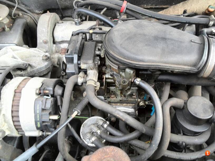

The carb is now off the car. It took about one hour working nice and steady and taking piccies. Some of the hoses were a bit iffy so took my time to ease them off.
As can be seen the carb is quite dirty and stained with old fuel. Tomorrow I'll start cleaning and stripping. I'll have to watch Wifey doesn't moan about the smell, the carb cleaner aerosol is quite potent stuff. :roll:
Maybe... maybe not - I don't know what colour the BX ATF should be. If there's a rumour that Ford red ATF should work ok then I might have started it :oops:

Useful pics - I think my 4x4 has a similar carb set up, so I may refer to these later!

Be prepared to change the ATF several times before all the old is fully removed. It's worth dropping the auto sump and cleaning the magnet inside and changing the filter. You may need to remove the flow valve to get it fully off though and be careful with the sump bolts, they can strip easily!

I think the petrol pump is leaking as well. I ordered a new one only 12 quid off the bay. I bought 5 litres of ATF so will do a few changes over the next few weeks. The carb is in two pieces now. Top and bottom. Took some working out how to split them but Haynes came to the rescue and it was easy. Now I can fit all the new parts and get it running again.

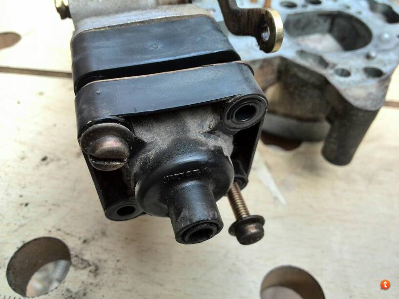

Mmm, I think there is a major problem with this carb. After cleaning and rebuilding with a few new parts from the kit I refitted it this afternoon and started the engine. There was a lot of petrol around the bottom of the carb and on the inlet manifold. Previous to refitting I cleaned the inlet manifold as it was covered in a thick goo. Now I'm wondering if that was a combination of petrol and road grime. Now it's all clean it's easy to see the petrol sitting there but not to see where it's actually coming from. :? I took the carb back off and checked the float level which should be 33mm from the gasket to the tip of the float when the carb top is inverted. This one was 35mm so if anything there should be less fuel in the float chamber. I fitted a new float valve thinking that was where the problem was before. I was very careful not to disturb any settings on the carb because the set up is ridiculously complicated in the best Citroen traditions I suppose. #-o Where to go from here? I noticed there were adjustments made last year for the emissions at mot time. Don't know if that is related. I'll check the floats tomorrow to see if they are holy. Also shouldn't there be a return to the tank? I'm not sure where it is. :(
I always thought this black box had something to do with the choke mechanism but it's just a black plastic box with a vacuum pipe and no other connections. Is it a vacuum accumulator?

Success! :D After yesterdays saga I stripped the carb again this morning and double checked everything I did yesterday. Everything appeared to be sound and the floats looked fine if a little old. I refitted it again :roll: taking extra care to make sure everything was just so. I lubed the throttle cable this time to help with the stiff pedal. Cleaned tools and rags away from under the bonnet and turned the key. After a few spins to fill the float chamber it burst into life and went into a rather lumpy fast idle. After a few minutes the revs started to slow as the auto choke eased off and it started running very smooth. I was watching for any smell or signs of petrol and there was nothing, nothing at all. =D> So what I did different I have no idea but it was ticking over lovely. I waited 10 minutes for the fan to kick in so it was good and warm and it was still as dry as a bone. Hopefully that's another job out of the way. [-o<
