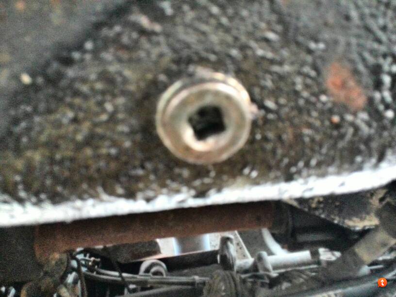

Sump plug. I took a pic to see if it was a square hole. :D

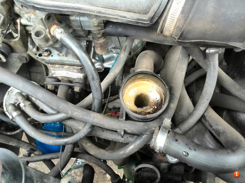

Oh dear mayonnaise. Note the dry carb! :lol:
Atf sump plug. Someone's been here before with a big chisel!
The stain is WD40 I sprayed on.

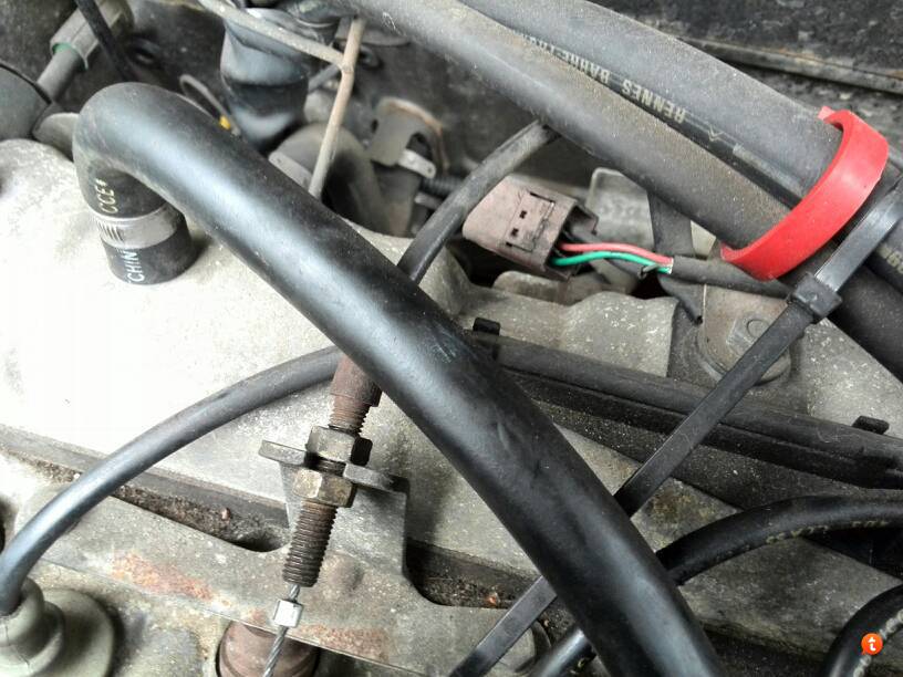

Does anyone know what this cable and multiplug is for?

demag wrote:Someone's been here before with a big chisel!
What baffles me is that they put the mangled plug back in! Unless they tried and just gave up I suppose.

I don't think they got it out it was solid. I undid the big compression fitting on the filler tube and drained it from there. Simples!

demag wrote: Does anyone know what this cable and multiplug is for?
And this one?
The plug in the top picture is for a rev counter. It connects to the green & red wires. If you follow the wire it will take you to the sensor.

OK thank you both. The rev counter is working so I won't worry too much.
