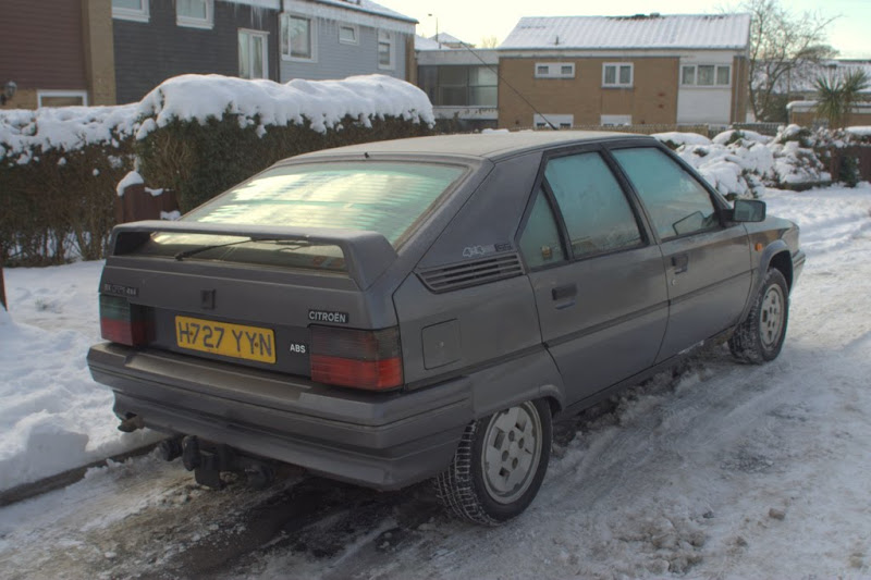

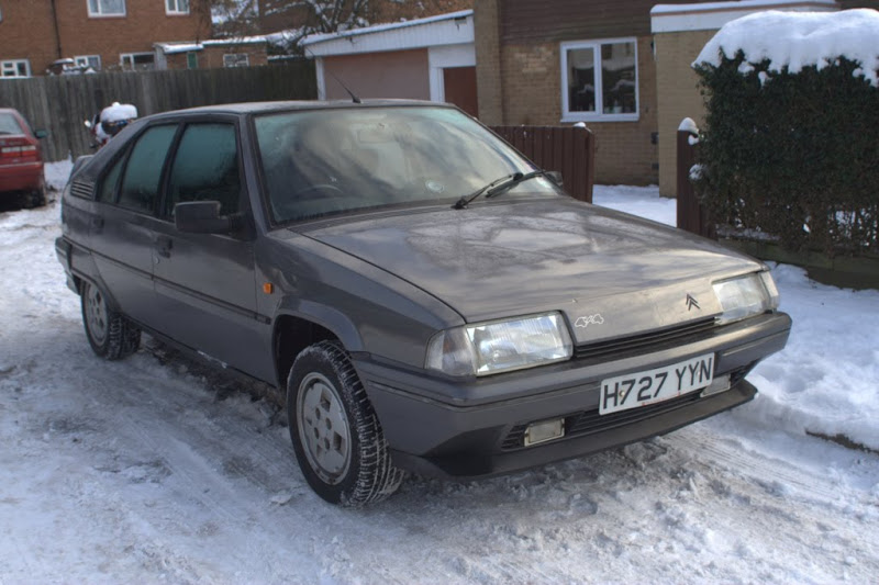

well by popular demand here are a few snaps of her covered in a layer of frost in the snow this morning. not great photos.
I'll get the back wheels off in the new year and have a closer look at the pipes that need replacing.
