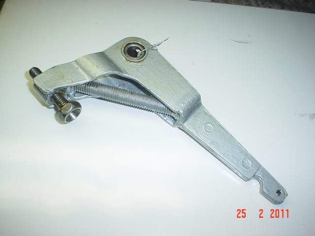

This is the one I made earlier.
You can see the bush, which is held stationary when the through bolt is tightened.
Hope this does the trick for you.

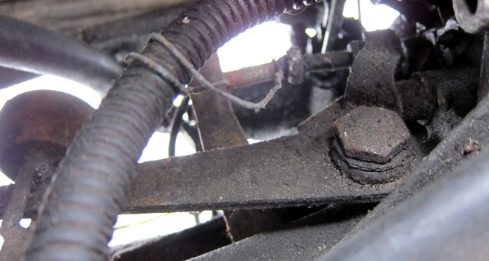

The new design has a nylon bush:
Not as eager to seize as the old metal one, but somewhat of a problem anyway.
(Looking at the pic, it's time to clean it again.. :oops: )
-Riku
