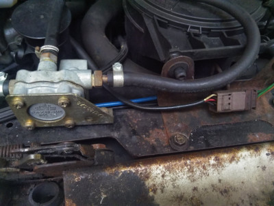

I have an oil leak, I think it is gearoil it is all over the area just below the gearbox breather.
I have put a pipe from the breather a distance away and isolated it as being the cause.
I have also replaced the gearoil and measured the quantity out as just under the two litres specified...
The LHM level hasn't changed since I got it.
I think the leak is very small but a little oil goes a long way on clean ground...
Is there an Oring on the gear selector? can it be easily replaced?
any other suggestions as to source?

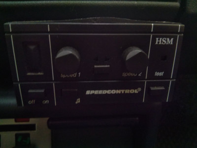

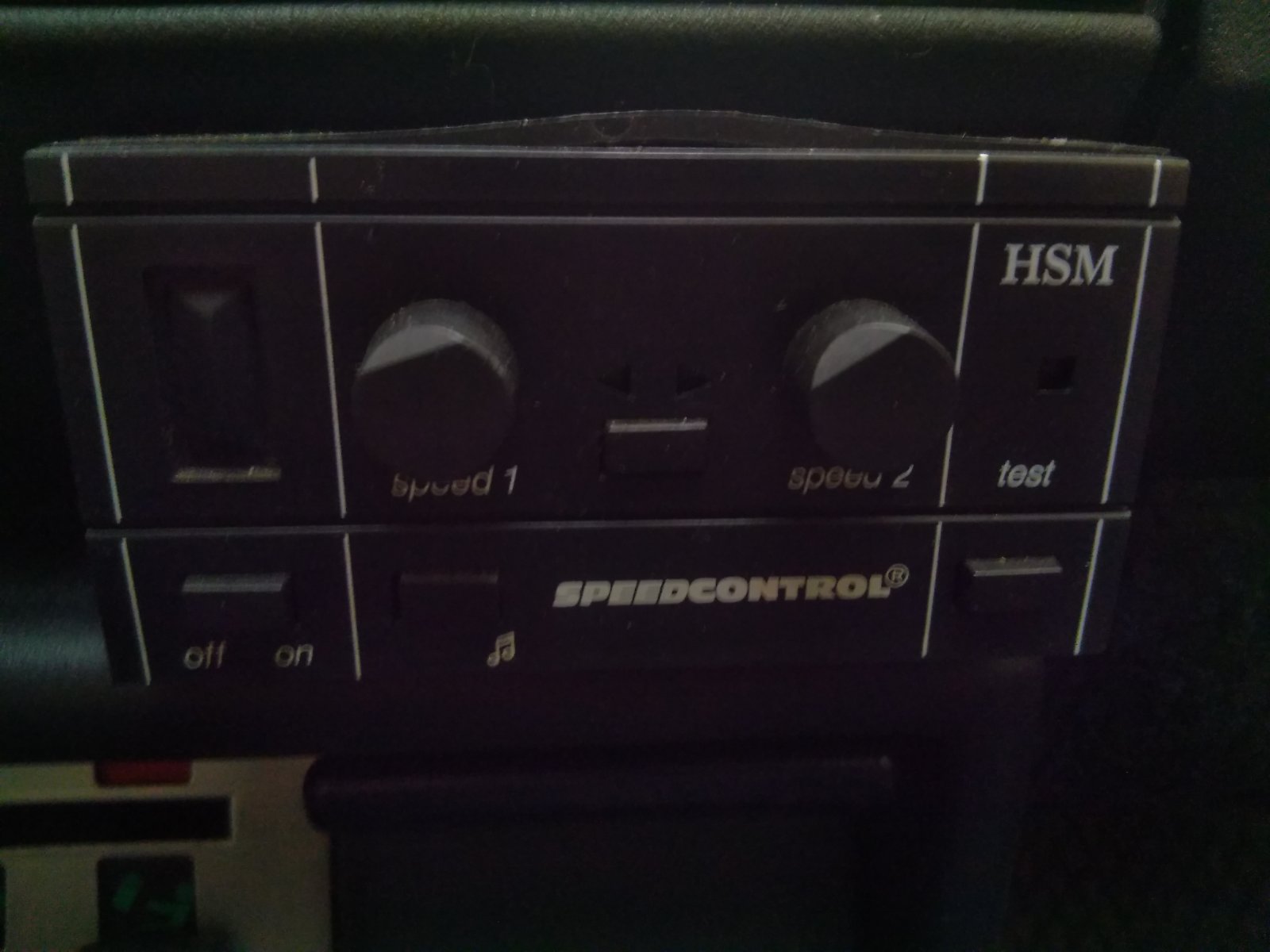

There is something on the Dash pictured in attachment, anyone know what it is exactly? how to wire it in?
I don't like seeing scotchlocks on wiring and I tried to clean the wiring up on the car when I got it particularly around the Speedo-pickup (of which there are two on my car? only one in use)
I am hoping I have just wired something back incorrectly....

Oil leak: I am not familiar with the digit gearbox but the be5 box on most BXs does develop a leak from the selector shaft on the top which lifts up and down when selecting gears. This shaft has an oil seal and at least one o-ring. It looks as though your box has a similar seal. It can be replaced by removing the link lever, be careful that the selector shaft does not drop into the box. The seal can be levered out slowly and carefully as it has a metalring which is larger than the actual seal and keeps the seal in place, just work around the seal easing it up as you go. I can see this in your picture.
