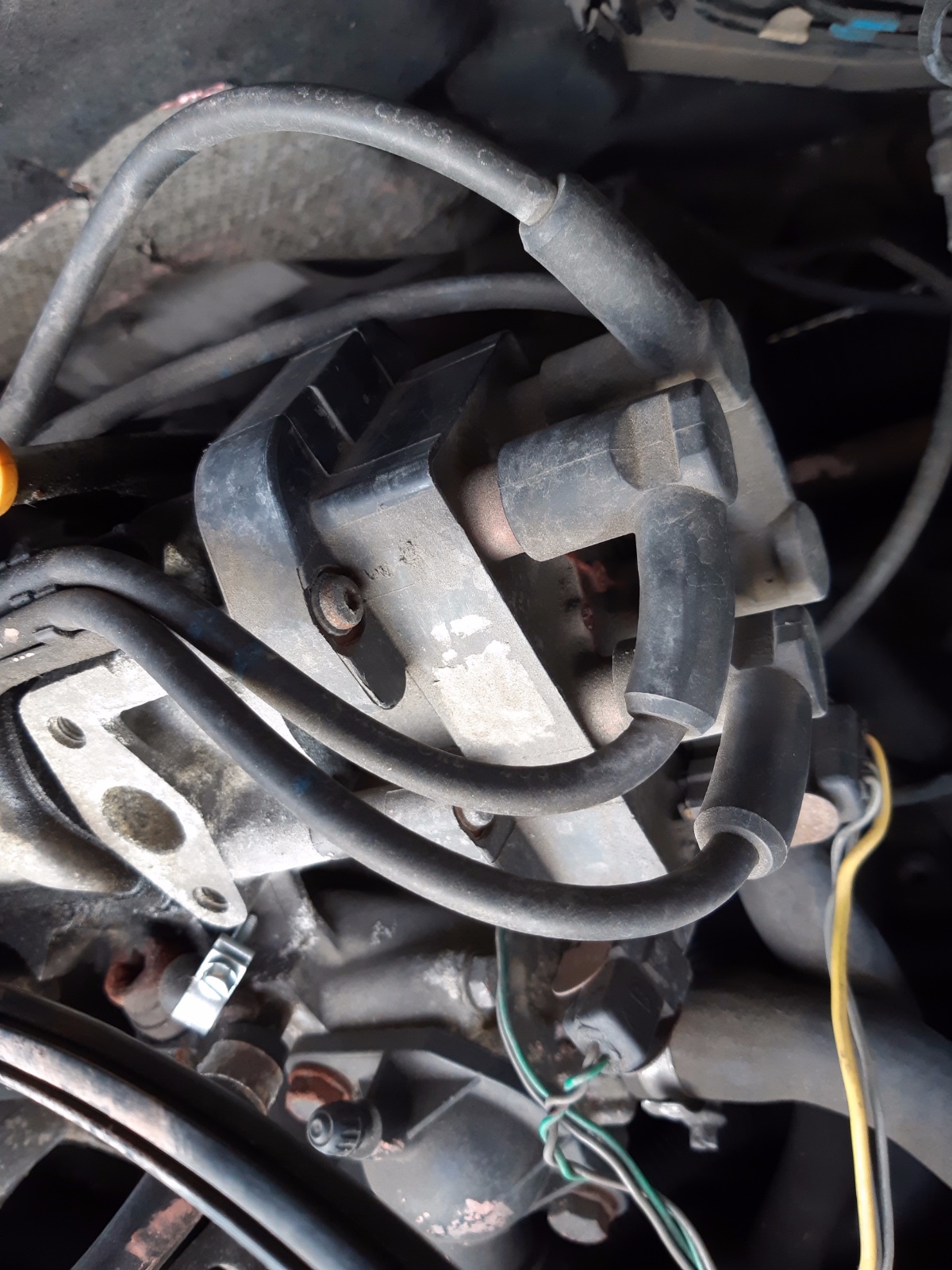

Thanks both for the advice. The photo shows where the distributor should be, am I correct in thinking that it is actually a distributorless ignition system?

No there is no dizzy to worry about.

Thanks for the further comments. Have only just had another chance to look at the car this evening and it looks like the coil (the thing in the photo above!) is only producing sparks to three cylinders so all being well an easy fix. Hopefully!
Assuming I get hold of a correct replacement coil is it just a straight swap?

The coil provides a spark for cylinders 2 & 3 and 1 & 4 at the same time, that means two sparks per cycle where one is a wasted spark. So it would be a strange failure if only one of them is not sparking. Have you checked the HT leads and perhaps swapped some around to see if it is the coil or a lead or plug ?
Hope that makes sense. The usual failures are two cylinders losing spark due to HT coil or ignition amp failure

I see. What I did was remove each lead from the coil in turn and all but one continued to produce a spark. Only in the case of removing the lead from coil did the engine continue to run, for the other three the engine stalled.

Replaced the coil (as depicted above) which (thankfully!) fixed the problem. Top tip: access for removal is easier if you remove the battery...
I sourced a Hella coil on eBay, part number 5DA193175-421 for just over £32.00. This also seems to fit a large number of other Citroens.
