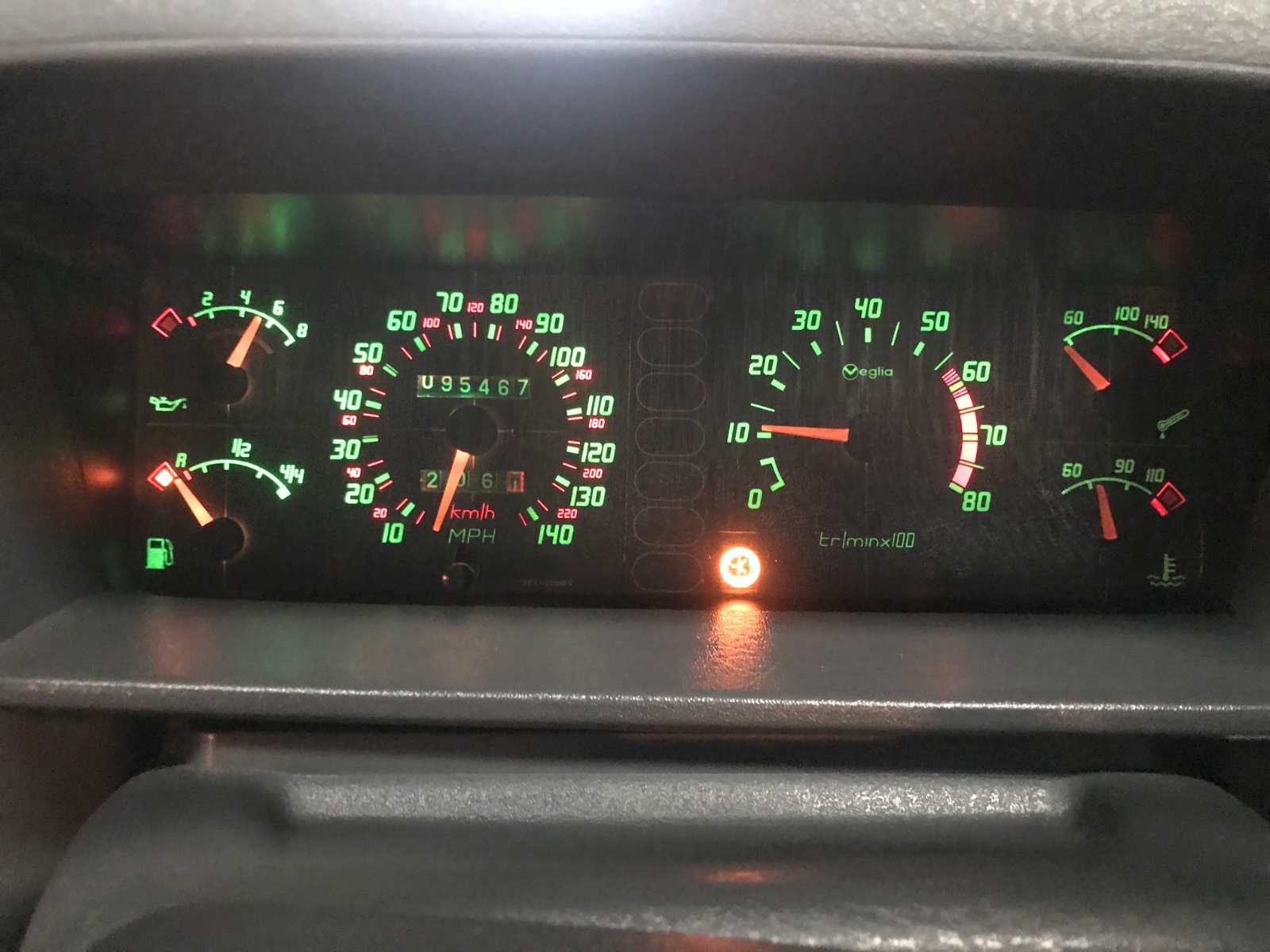

Starts fine, idles high, Wont Rev up unless I’m very gentle, appears to run Rich, if I accelerate hard it cuts out but restarts immediately
I’m thinking coolant temp sensor
Bx 1.9i Wont Rev up and engine check light on
