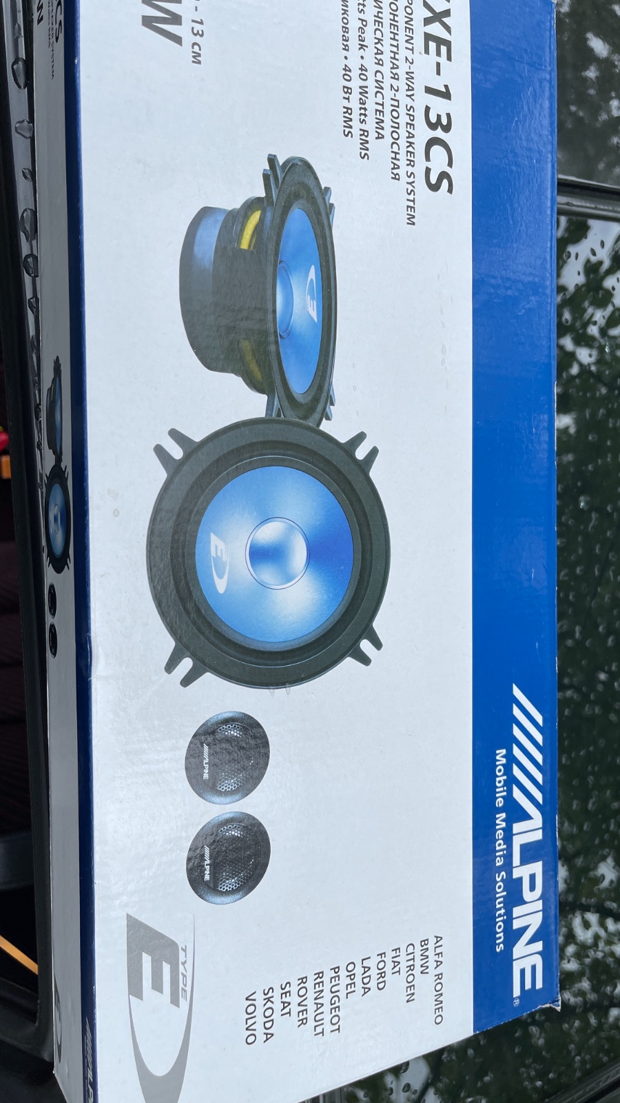

Door speaker upgrade.
The factory speakers, even 30 years ago, are terrible
This mini upgrade was cheap, with a noticeable increase I. Range and volume before distortion sets in.
Will add tweeters and a under seat sub as time permits.
