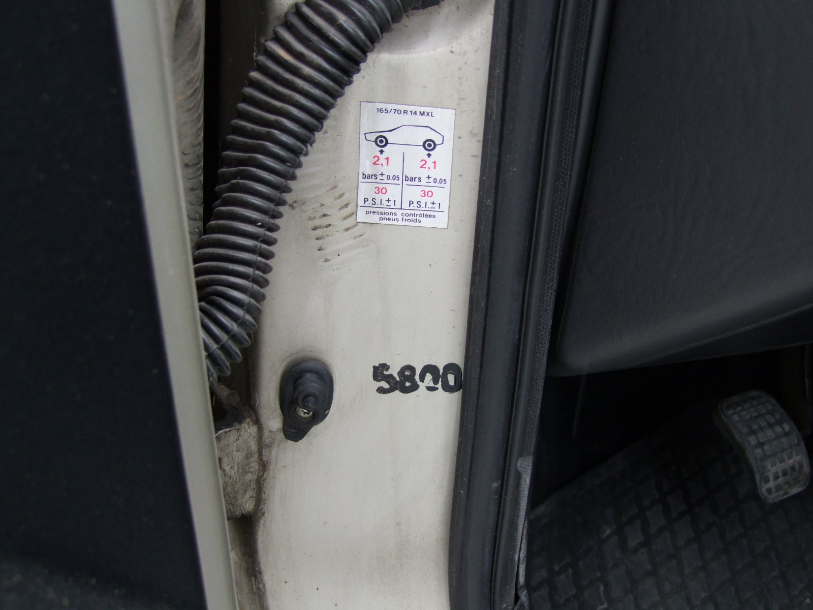

Your VIN number looks correct enough (has the requisite 17 digits, in expected format) but - annoyingly - is one of the early-90s BX VINs not recognised by Citroen's vehicle database (ServiceBox), which details build date, and many of the factory fittings to the vehicle.
The other way to age the vehicle is by the 4-digit RP (aka RPO or ORGA) number, which on BX is usually paint stencilled on the A-pillar, between the door hinges... This site (there are others too, just google "RP decoder") will allow you to enter any Citroen RP number and get the ex-factory date:
http://www.citroen-ds-id.com/gen/Gen_Organr.html
Someone else here may be able to decode some of the vehicle details embedded in your VIN.

Thanks for that. I don’t recall seeing an ORGA on the A pillars, possibly because it has been painted over when the door hing rust was repaired?
Does it seem reasonable that a 1990 model can still be a P1? I guess I’m trying to confirm whether this is an original car, or has it been the subject of ‘mix and match’ over its lifetime?

One of the members here has a surviving silver p1 Valver with the VIN ending 4701...the one before this car! VINs were issued separately to build dates/times, so they didn't neccessarily go down the line together, but there's a possibility they did. That would make it almost certainly a February/March 1988 car, which means it's actually a GTi 16v, not a p1 16Valve. Rare machine!Cresco750 wrote: Sat Feb 12, 2022 8:21 pm Is it possible to confirm a BX’s build date and spec from its VIN? Number is VF7XBEJ0001EJ4702. The vehicle in question is registered as a 1990 model, but was first registered in NZ in August 1991. Odometer is in miles (NZ vehicles normally in Km’s), which suggests it may have been privately imported from the UK as a new car? Body kit is P1, but I thought the P2 was in production from 1990 onwards.
As mentioned, the ORGA/RP number is the sure-fire way to get the exact build date, but they're easily rubbed off, sadly.
There are a few p1 in the register which were exported to the east, and almost all are much older vehicles than the registration dates suggest. One of them came back to the UK from Hong Kong, and has somehow ended up on a K-plate, despite it being an 88/89 built black p1. It's just administrative errors.
VINs with ***BEJ0000EJ**** or BEJ0001 are p1. P2 began as BEJ0002.

Had a brief mental image of the automotive equivalent of a "brass rubbing", but guess the the only way to find if overpainted rather then rubbed-down is destructive. Repeated T-cut?white exec wrote: Mon Feb 14, 2022 1:52 pm Wonder whether some of those painted-over RP numbers might still have the number under the new paint layer?
white exec
- Posts: 681
- Location: Sayalonga, Malaga
- LHD, NA, AC, RP_5800
Re: Looking at buying a 16V
If the stencilled number is still there, it might show as slightly raised digits under the new paint? Bit hopeful, I know.
Otherwise cotton-bud tactics and a smidge of solvent.
Digits were usually in white on darkish colours, but black or yellow on the light ones. (Ours is yellow on white.)
Calls for some Fake-or-Fortune forensics...

Solvent would take the ORGA clean off. Brake cleaner does, too. In fact, if you scrub too hard with a sponge and car shampoo, it starts to fade!white exec wrote: Tue Feb 15, 2022 6:23 am If the stencilled number is still there, it might show as slightly raised digits under the new paint? Bit hopeful, I know.
Calls for some Fake-or-Fortune forensics...![]()
