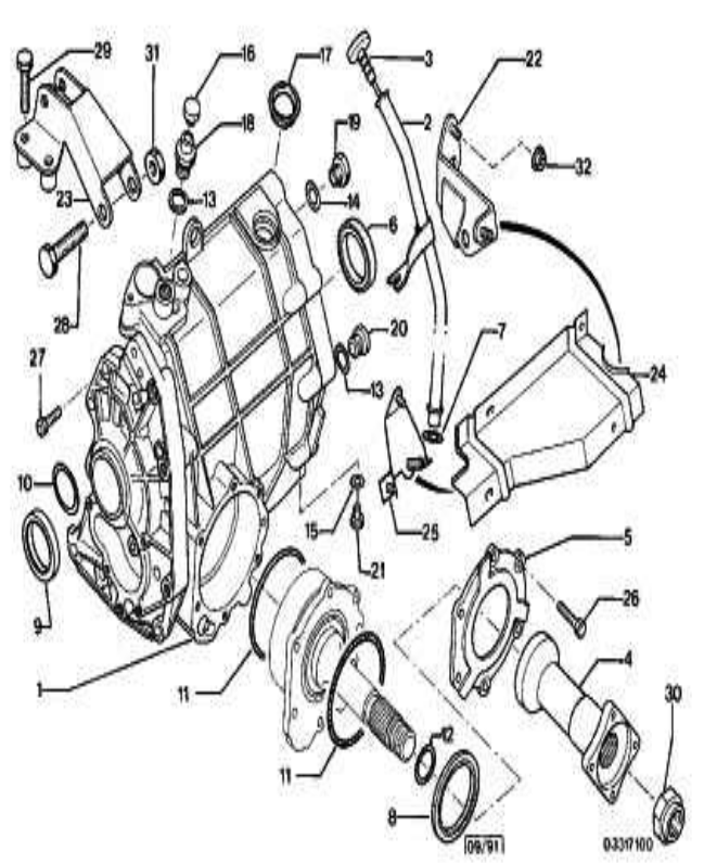

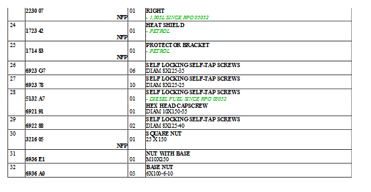

Hi, I've heard nothing and recieved nothing yet but it might be worth looking for 405 parts or trying to get the seals somewhere else. see here these pictures if they're any use, looks like they have the sizes for the seals on it:
I have access to more of these diagrams if you ever need any for the diff etc.
