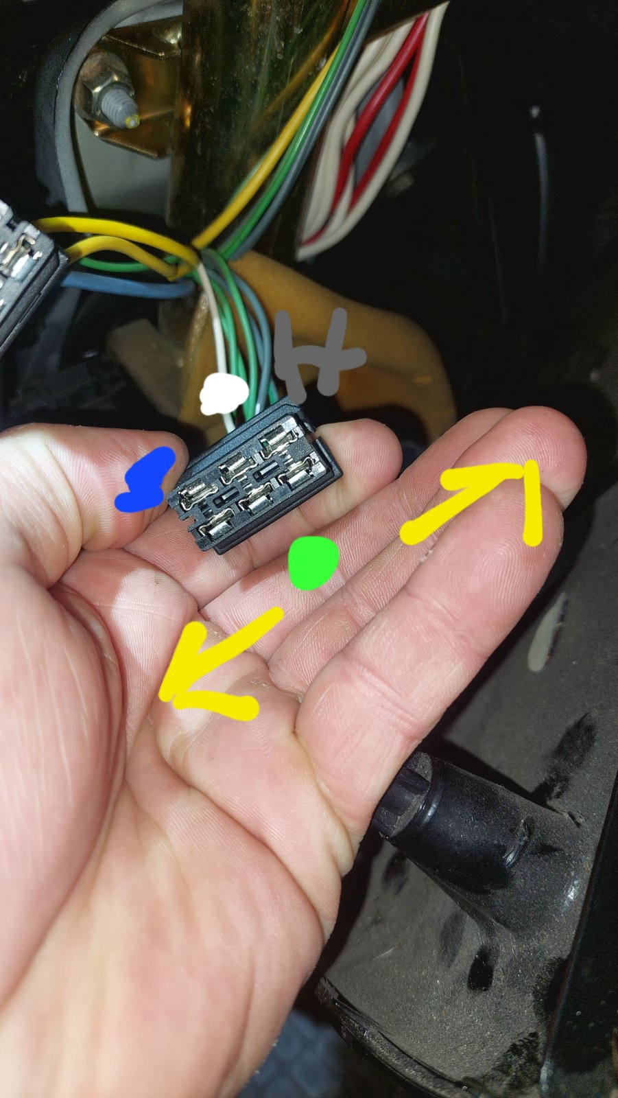

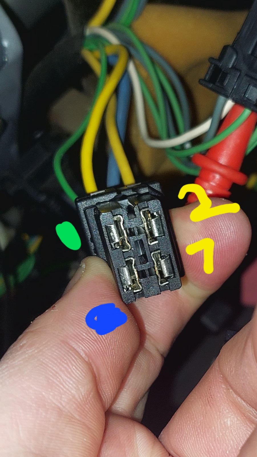

I have now measured and bridged the contacts to see if it’s possible to manually activate the position lights.
Unfortunately, I didn’t succeed, but it’s still a step forward.
The connector with four pins has the following functions:
Blue (12 V)
Green (buzzer)
Yellow 1 (low beam)
Yellow 2 (high beam)
The connector with six pins has the following functions:
Blue (12 V)
White (unknown)
Gray (horn)
Yellow (turn signal)
Green (6.7 V/relay)
I couldn’t find any function for the white contact, and I didn’t hear any relay clicking when I bridged the contact.
I’m skeptical about the green contact since it gave a low current, 6.7 volts. It also activated (clicking) a relay near the fuse box, but I couldn’t identify which one. However, I couldn’t determine that any function was activated when bridging the contact.
I measured the last four fuses (5A) in all configurations, but there was no current on them. This means no power is reaching the fuse box and being distributed to the lights. Occasionally, when measuring the mentioned fuses, I got 0.05 V on the last three fuses. Not sure if this was due to my cheap measuring instrument or if there was indeed a weak current on them.

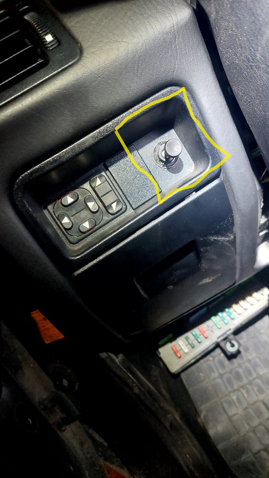

There’s also a switch (push/pull) in the "cockpit" that I suspect is a aftermarket construction. I don’t know its function, but if I were to guess, it might be for low beam automation? I’ve never used it and didn’t find any function connected to it, but it might be a potential source of the issue. However, the switch has been installed for as long as I’ve owned the car.
I tested all configurations with the ignition in different positions, except with the car running. No diffrence.
If anyone knows the function of the green- and white-marked cables, I’d be very grateful—or if you have any tips on what the fault could be. For now, I’ve probably ruled out the turn signal lever!

From what I remember, there should be another thick yellow wire going to that position in the 4 pin plug wheee your thin green wire is. It’s possible that someone has rewired the car. The buzzer also is to warn you that the lights are on with the ignition off, but should be connected to the position lights somewhere. All 4 wires go down to the fuse box, but I don’t remember which positions.
The green wire that you asked about is your flasher box for the indicators. If you connect it to any of the indicators (or the horn), it will turn on & off like it does in general use. That’s why it clicks.
The white wire that you’re unsure about is the feed to the rear fog light switch. If you send 12v down it, then the rear fog lights will work with nothing else turned on.
I’m not sure what that lever switch is for, as that position is only used for the choke on early petrol cars, but maybe they’ve connected the position lights to it?
I’d personally check the back of the lights switch with a multi meter to see if the switch connects the blue & green wires in the 4 pin plug when turned to the 1st light position, but I suspect it won’t. Then I’d have a look at that switch that you suspect is aftermarket to see if that is working the position lights.

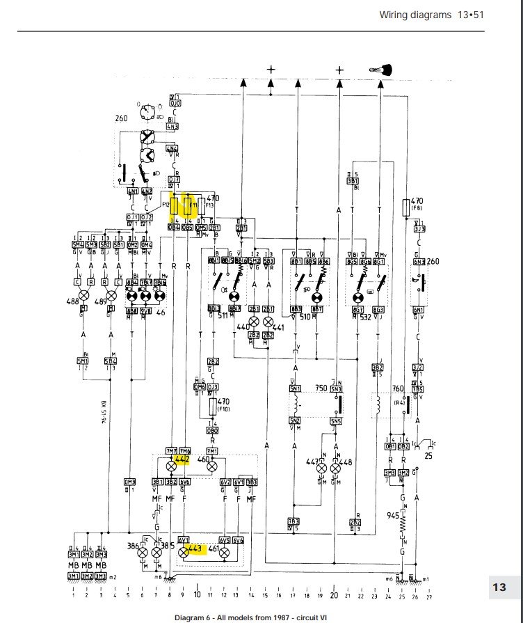

It’s been a hectic period, but I’ve finally had some time to continue troubleshooting. Still no solution to my issue with the license plate light, rear light, or front position light.
I’ve installed a new indicator stalk, but unfortunately, that didn’t solve the problem. I’m starting to suspect a bad ground connection. I measured again at the fuse box and got 0.24V on both fuses F11 and F12.
If I feed 12V to the non-powered side of fuses F11 and F12, all lights work perfectly.

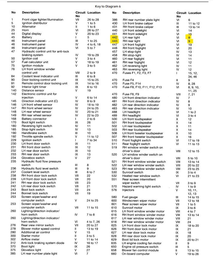

I’ve tried to decipher the wiring diagram, but that’s not really my strong suit. Is there anyone here who’s better at this and could lend a hand? Is "C" north of F12 (yellow) a relay?
This will be my last attempt before I install an extra relay to the non-powered terminal of the fuse box, connected to some ignition-switched function…!
