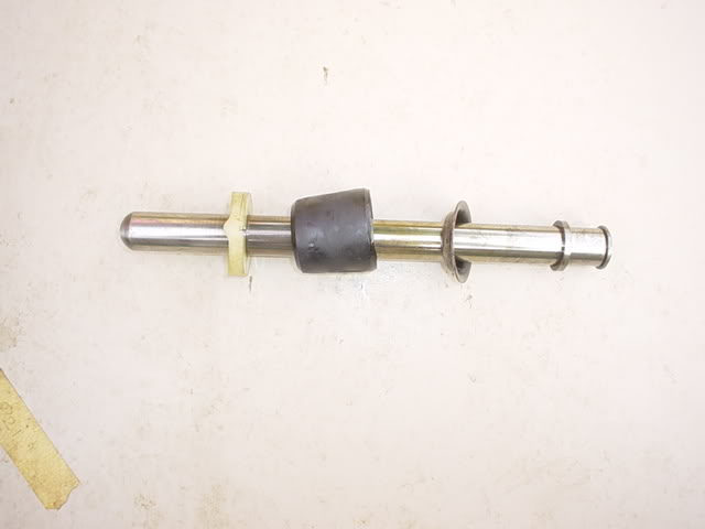

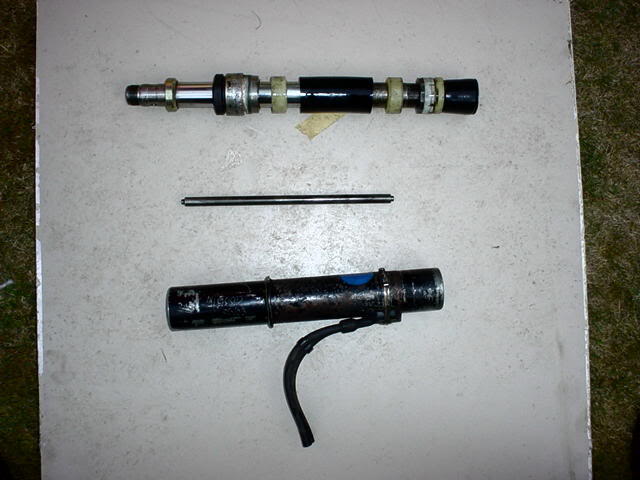

Well, yes I did have a go some time back, purely as an exercise and got stuck, I assume at the same point as you..
I then cleaned up all the internals, spent a long time removing all the ridge marks on the centre stanchion, using very fine wet and dry soaked in diesel, then re assembled.
As there were no obvious major wear on the bushes, I re-assembled.
It still remains a spare to this day !!!
I did take some picies though, a couple below..
Be interested to know if you do progress any further...

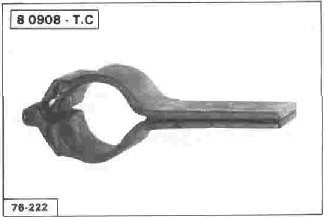

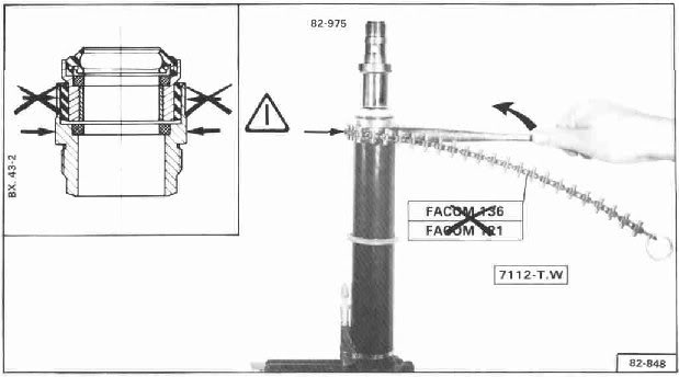

The Citroen service manual shows a special tool being used to clamp the lower end of the strut in a vice and and a chain wrench being used to free the top.
chain wrench used to free the bush
special clamp used to grip the lower end in a vice
