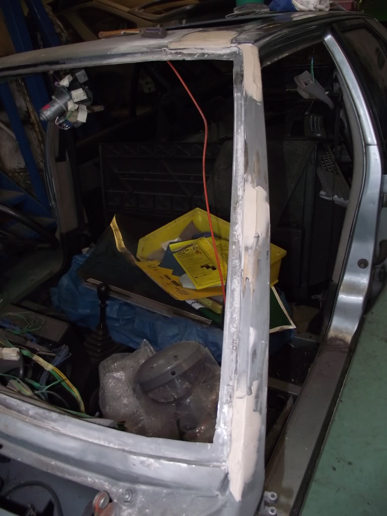

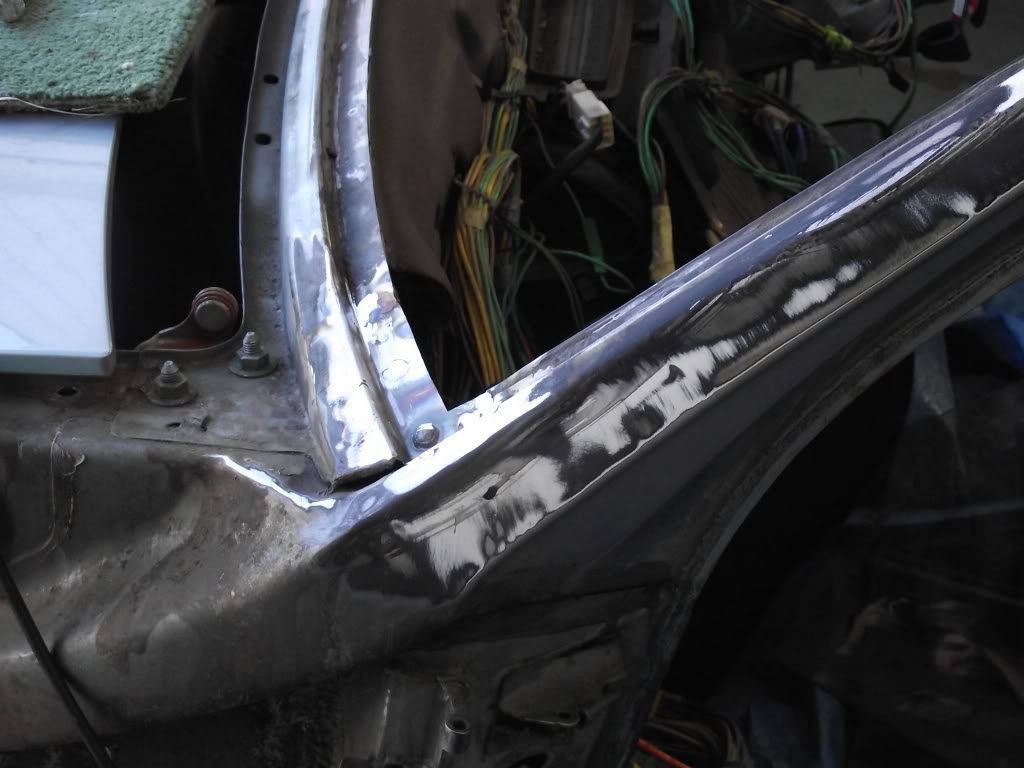

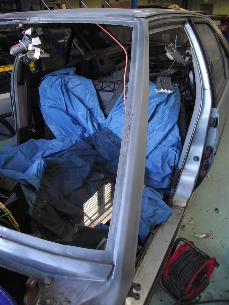

Windscreen pillars coming along:
Bodyshop is going to finish off the sanding down, as I can't quite get it right :lol:

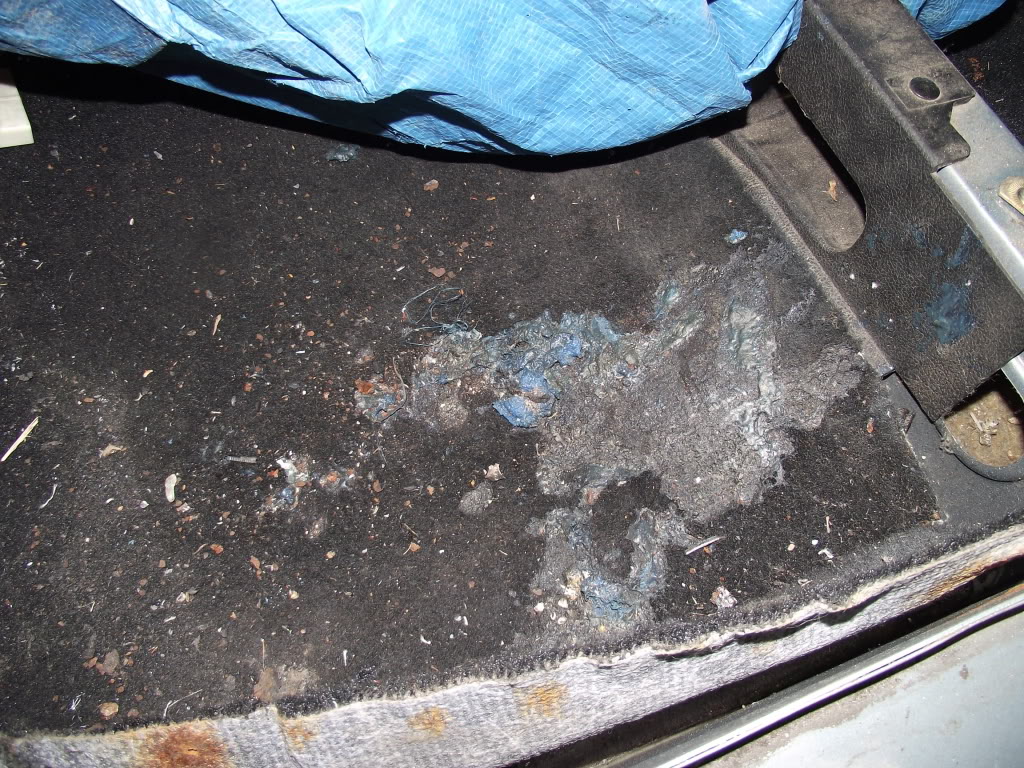

Managed to set fire to the carpet while welding:

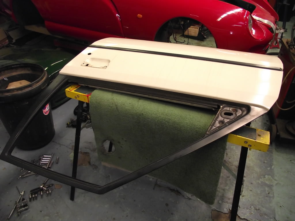

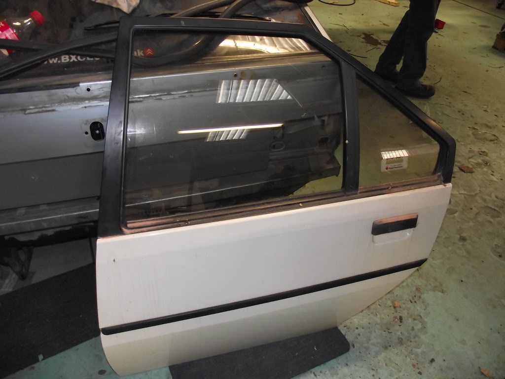

Blast from the past......anyone remember Snoopy? (I think thats what he called it) It donated its doors just after being totalled by some moron IIRC:

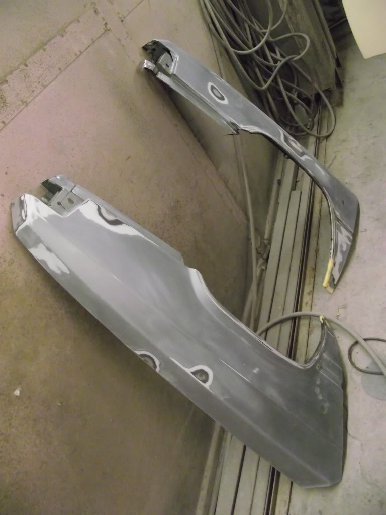

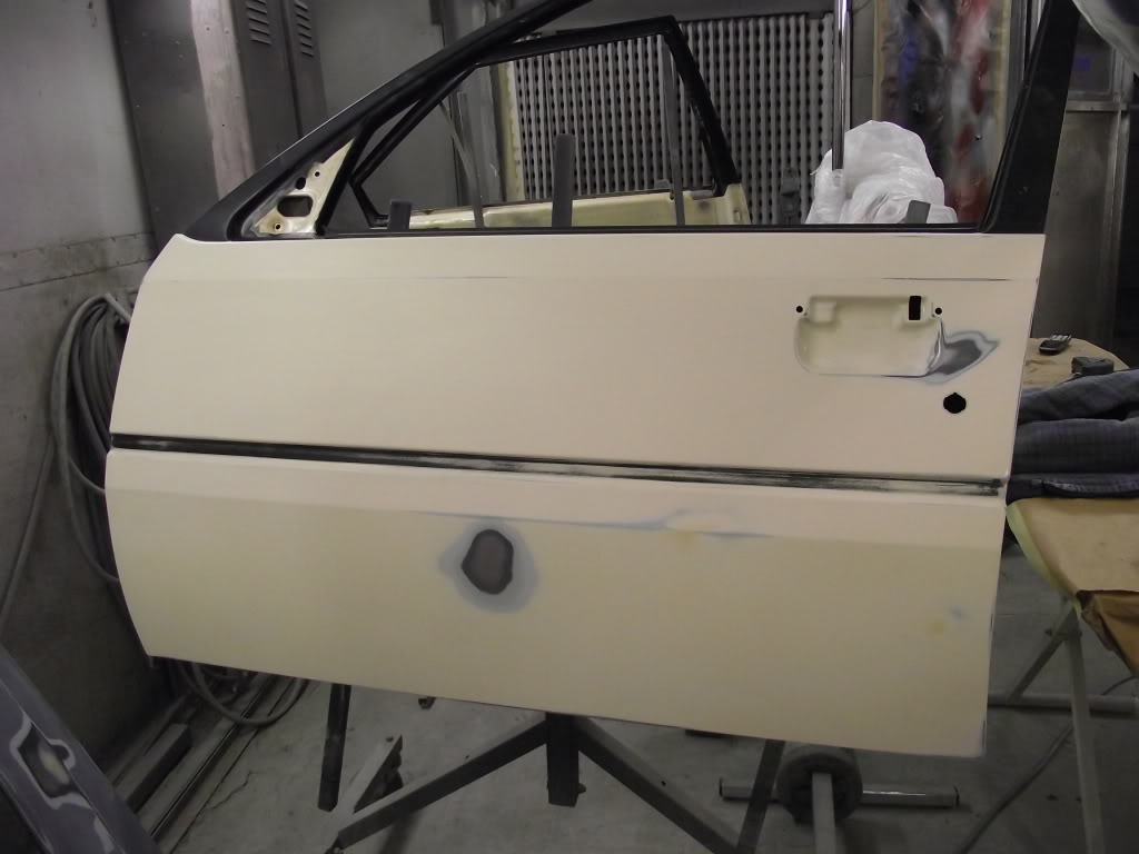

Wings being prepped:

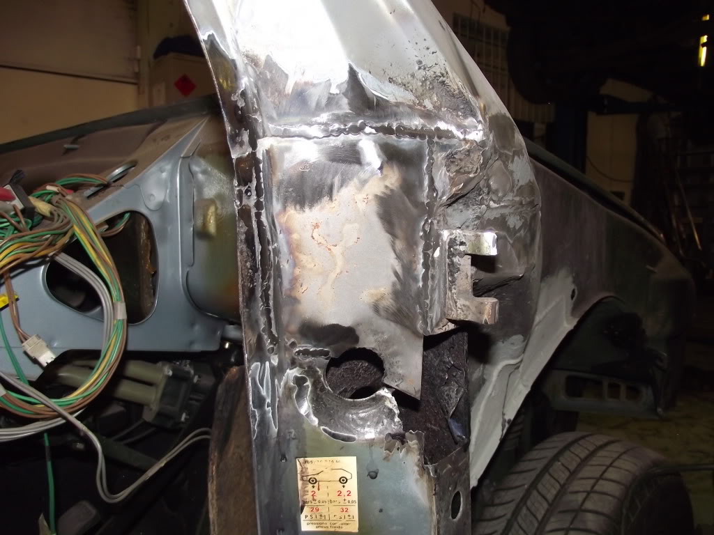

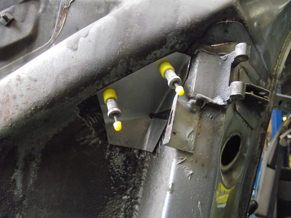

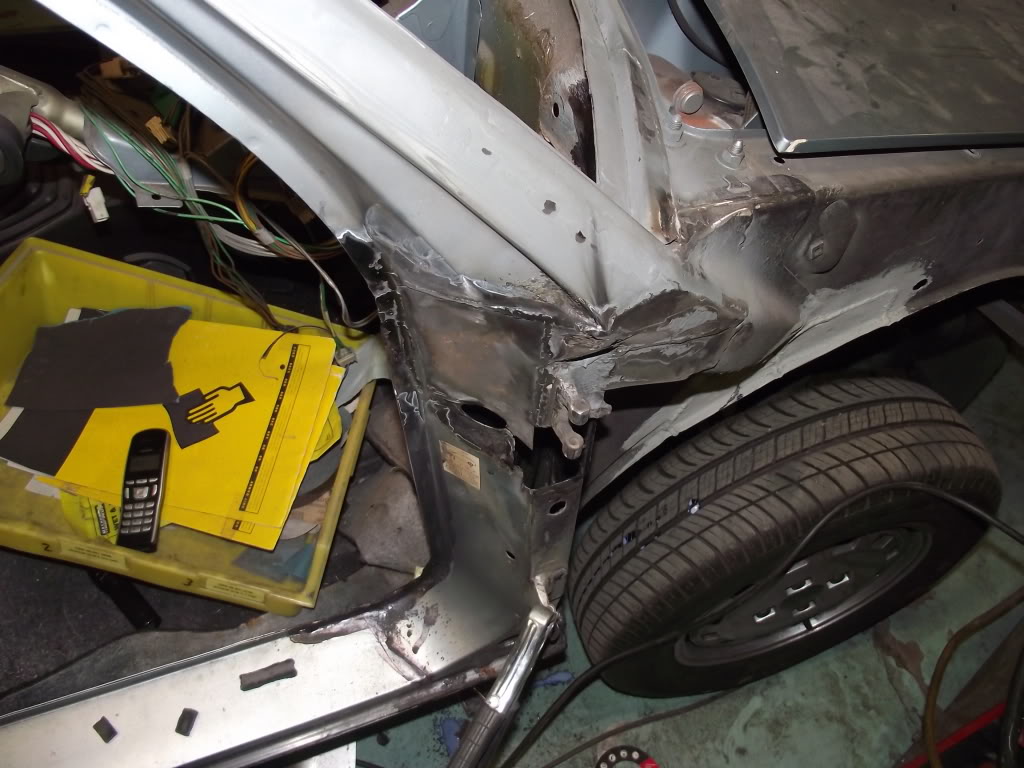

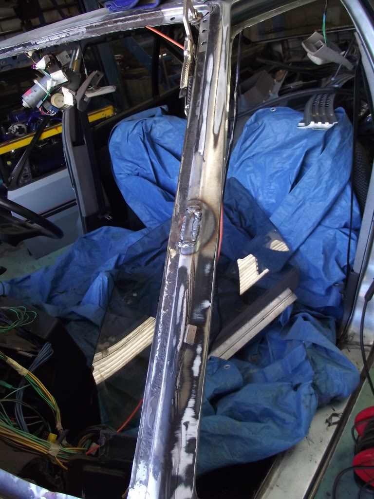

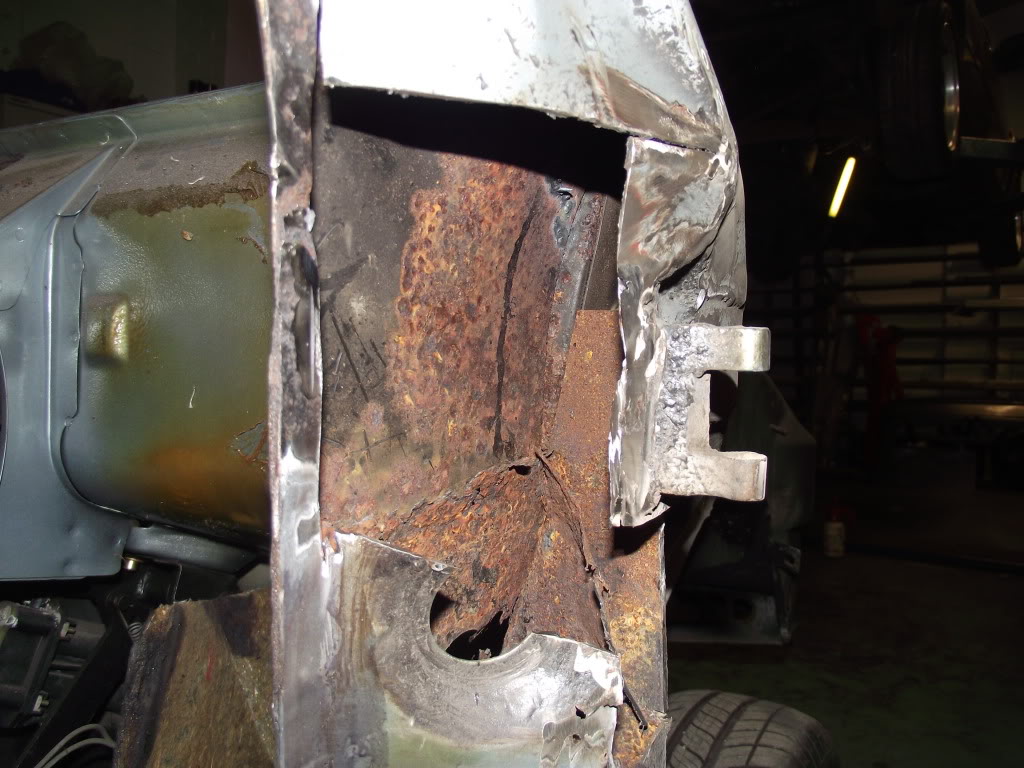

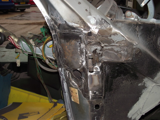

Started doing some last minute stuff on the body today and found a previous repair on the A-pillar which I always thought was ugly but solid turned out to be ugly and flimsy:

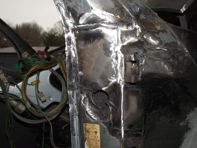

So we had to come up with something pretty quick sharp:

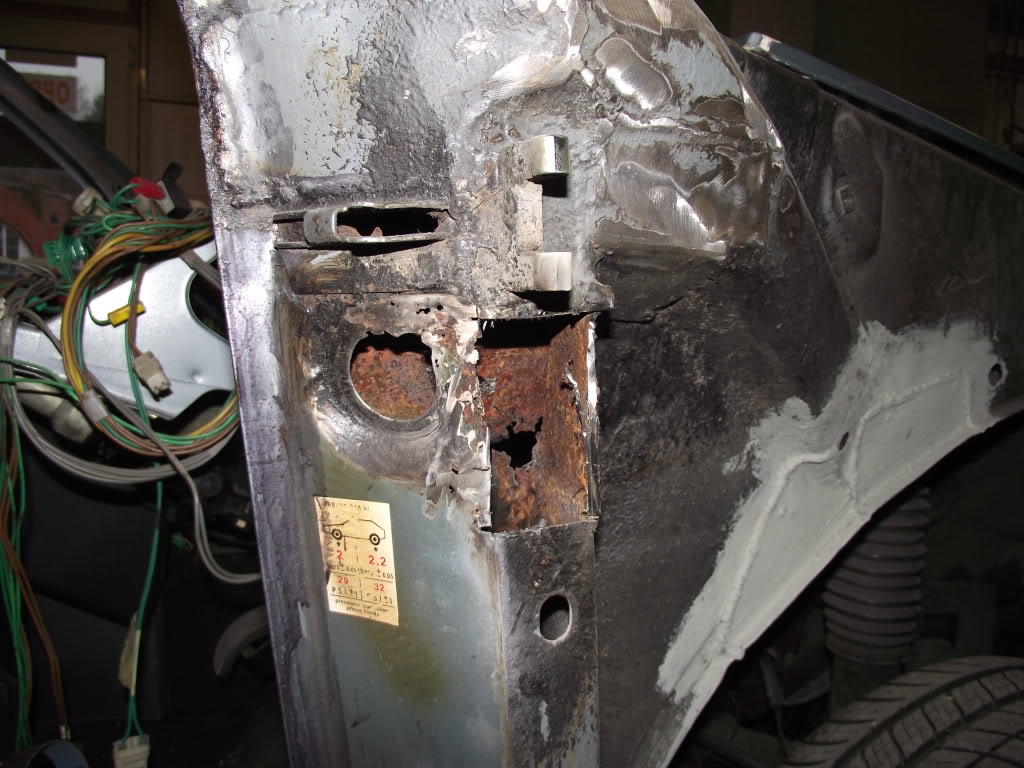

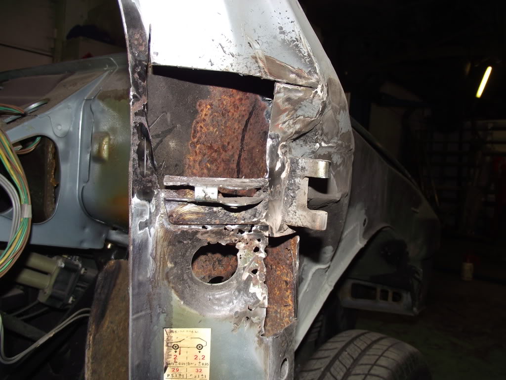

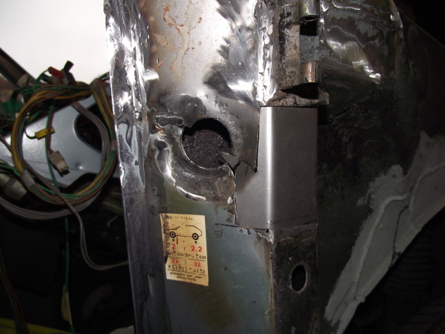

Innards (or what's left of them) caked in Kurust and new bits of tin welded in. Looks awful inside still, but that's luckily the only part that's solid (previous repairer has used 3mm plate!)
Made it go on fire again though:
More tomorrow!

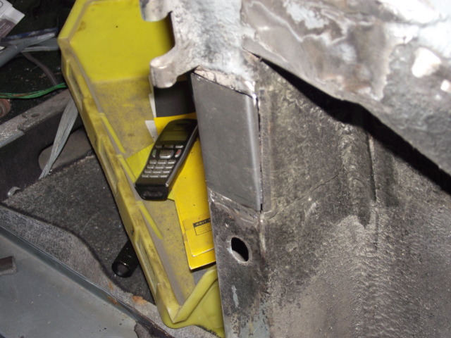

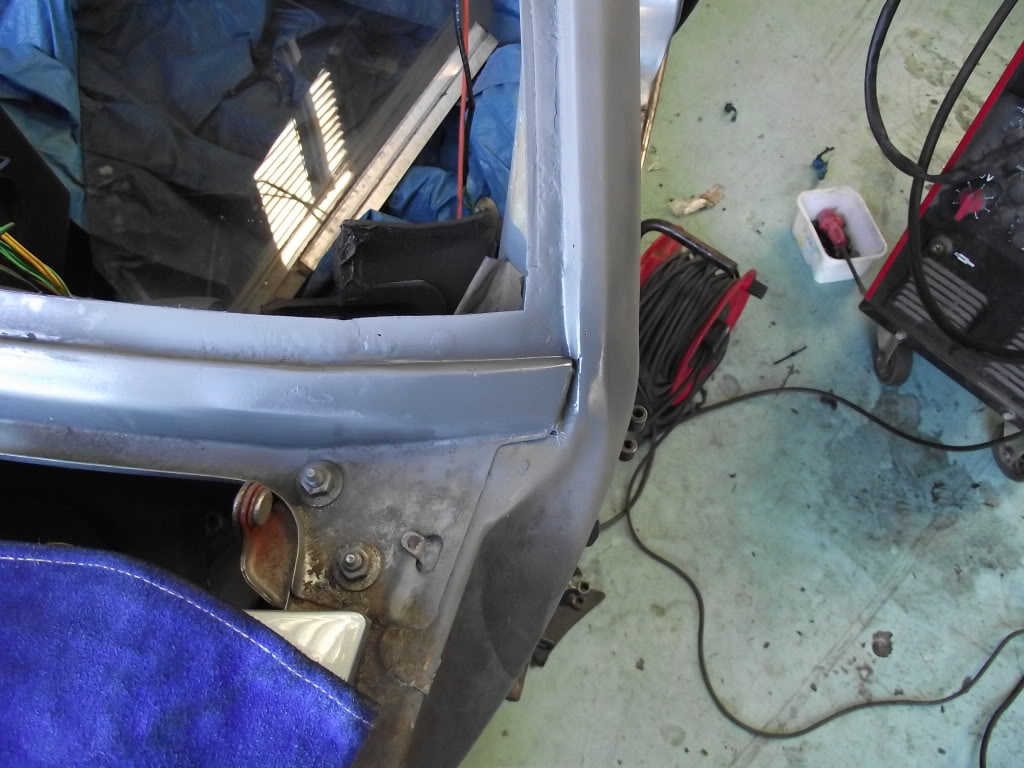

More tinkering today. Nothing major, just last minute bits and bobs before it goes to the bodyshop:
The A-pillar is now a mix of old thick plate and new stuff we've put in. It's not ideal, but it's solid and from the outside at least it'll look good enough.
We've just got to weld the check-strap bracket back on now. It's a fairly tricky thing, because it's been butchered in the past and can't be refitted in the correct way. I've decided the only way to attach it and make it look good is do the prettiest weld I've ever done along the top of it and leave the grinder alone.
Hmmm......let's see how that one pans out! #-o

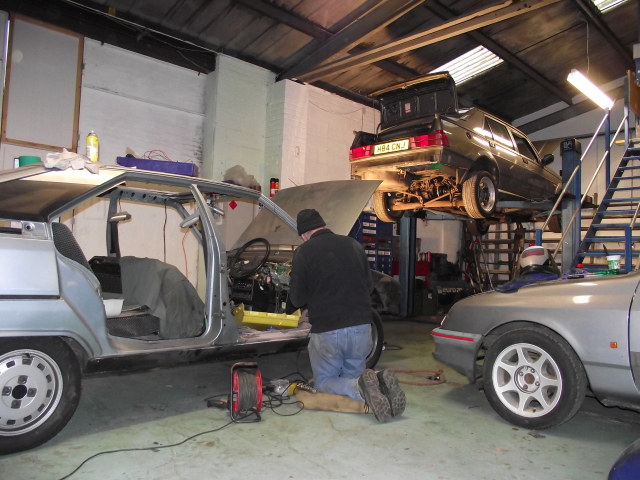

We've got a proper little retro corner going on now!
