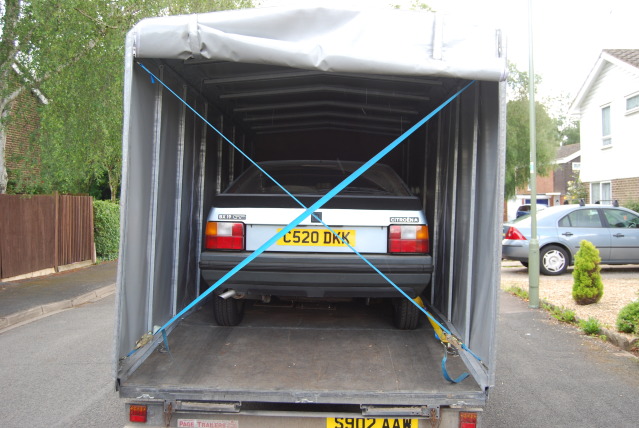

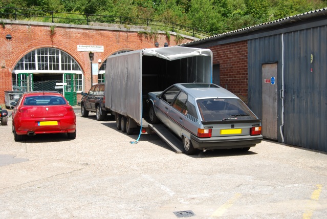

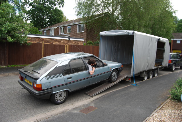

So, a couple of months ago I leave to go and collect the GT:

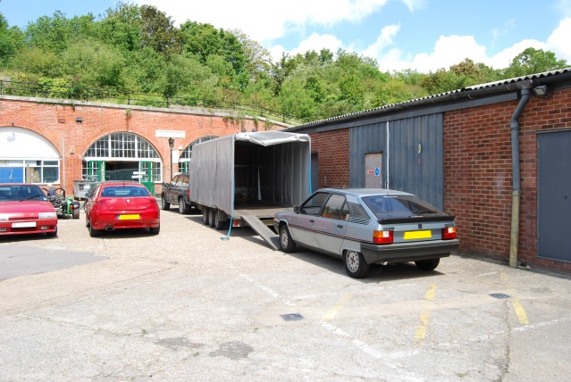

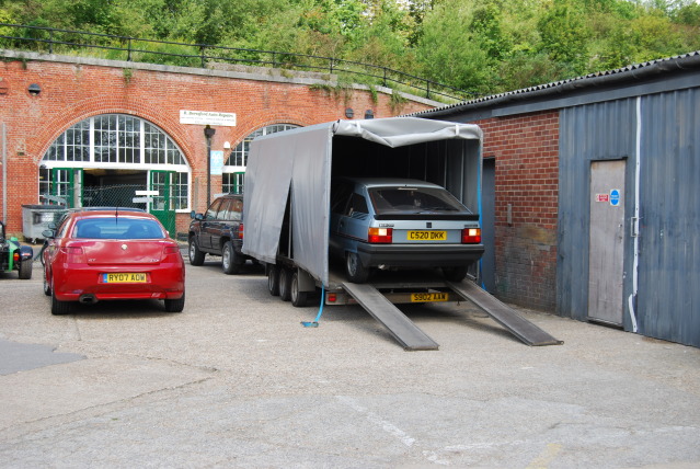

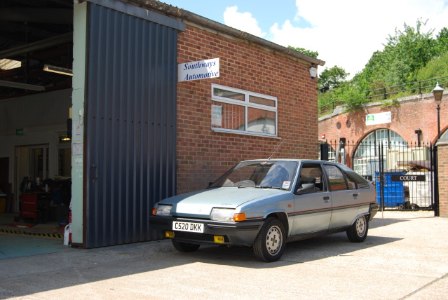

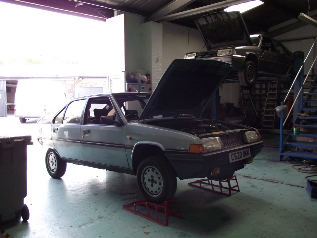

I arrive at the workshop and unload the GT.
It's arrived:

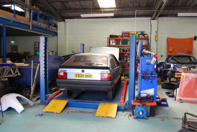

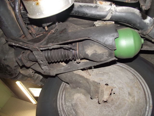

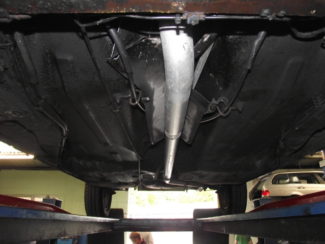

Over to the ramp for initial underbody inspections:
All good. Less rusty under here than my red 16v!

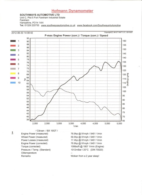

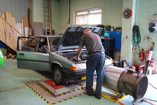

Engine will potentially be rebuilt, as it's being removed. So first the engine is checked for health on the dyno:
It phails, miserably:
However, although the figures are shash, the graph indicates that actually, there are no major mechanical weaknesses with the engine. Old fuel is one of the most likely candidates for the eraticness at higher revs, with the carb also needing a rebuild. A strong compression test is also good news, so for now the engine isn't going to be stripped and rebuilt, although it's still coming out to paint engine bay, change cambelt and clutch:

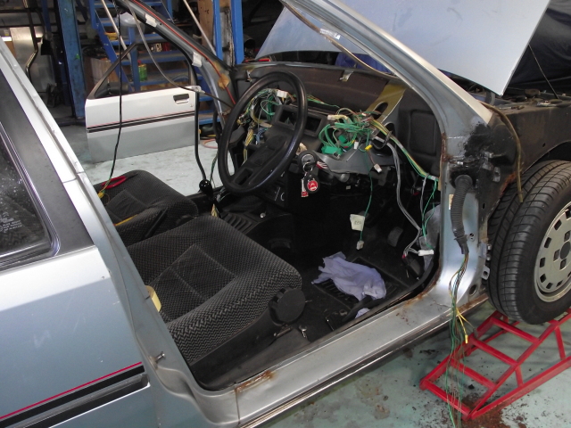

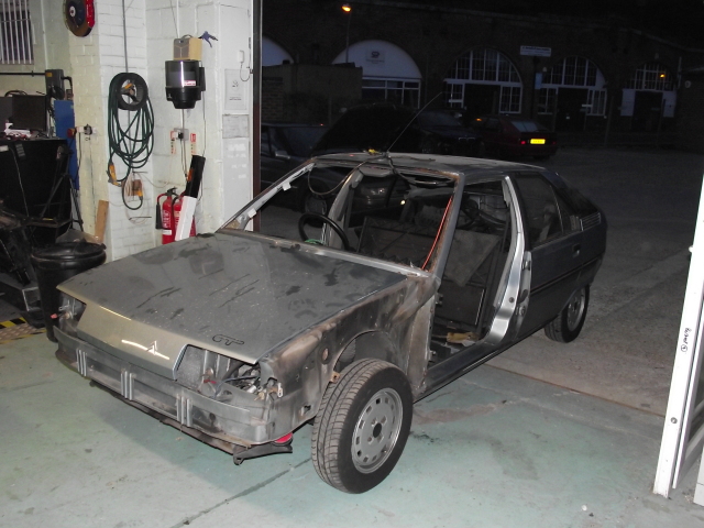

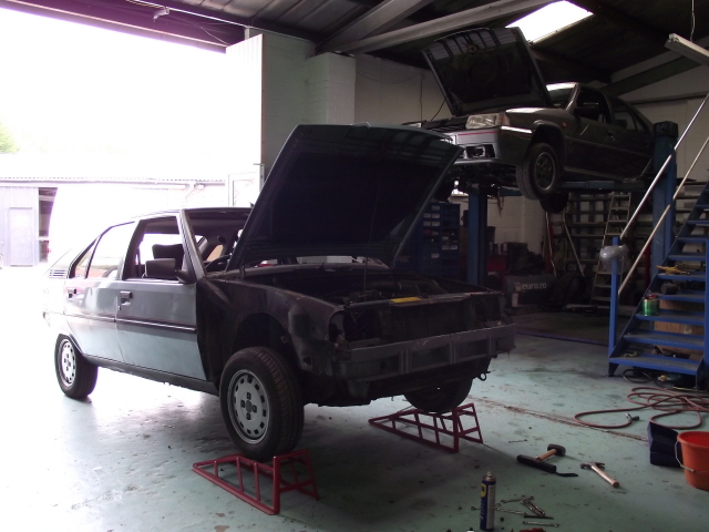

So I start stripping it down in preperation for the full respray it's getting:

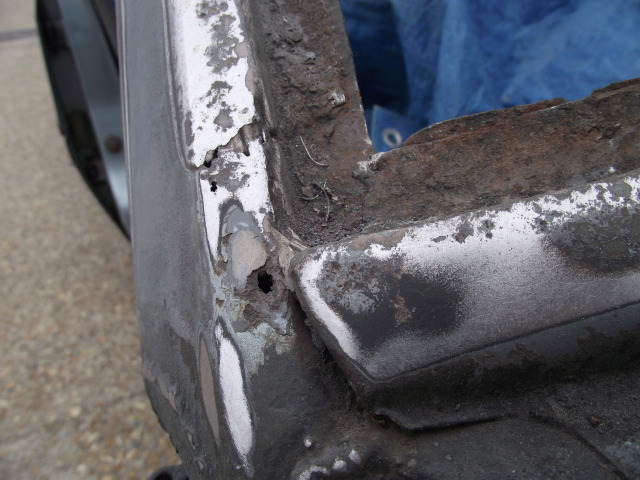

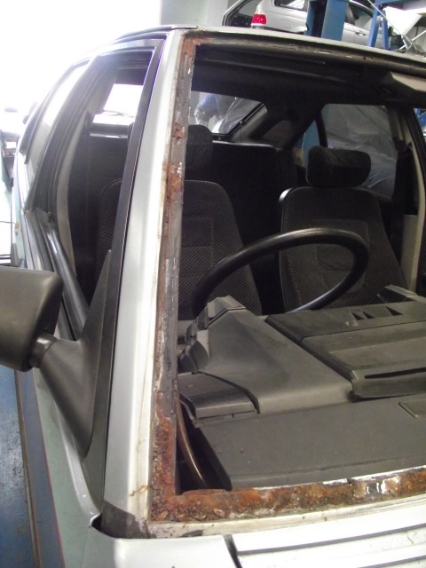

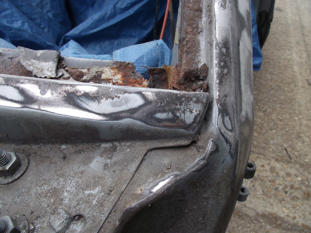

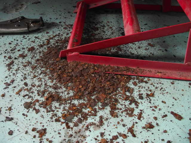

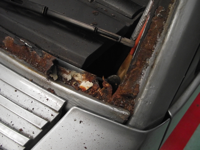

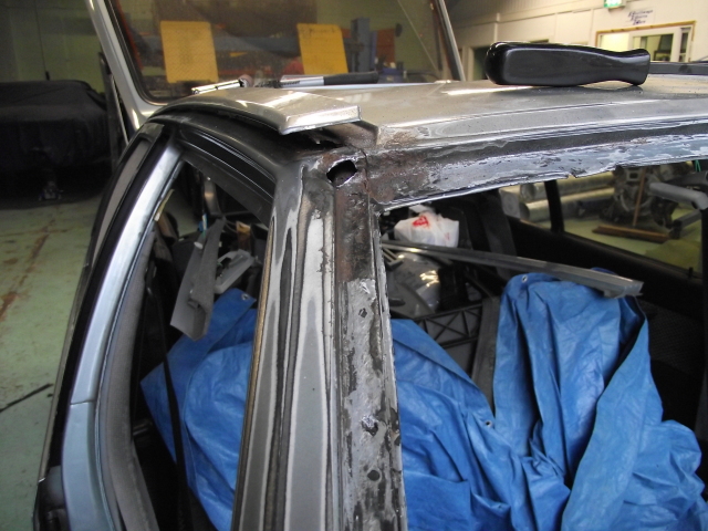

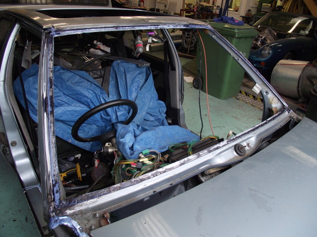

I knew the A-pillars were an issue. Just not by how much:
Full of filler by the look of it!

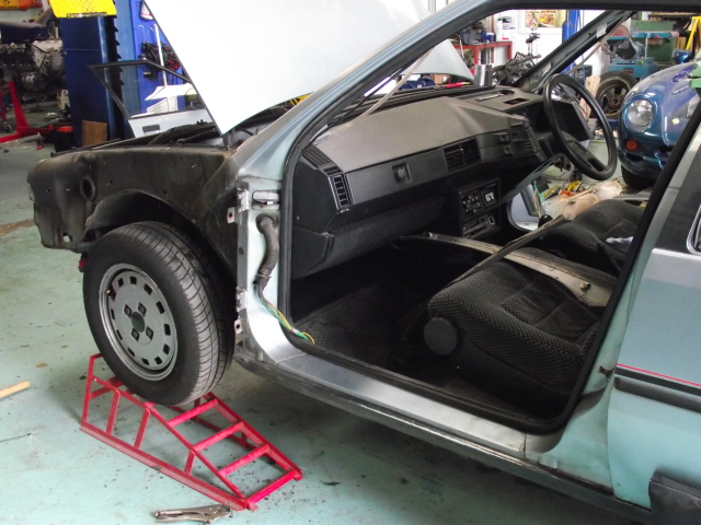

Work continues to strip the GT down:

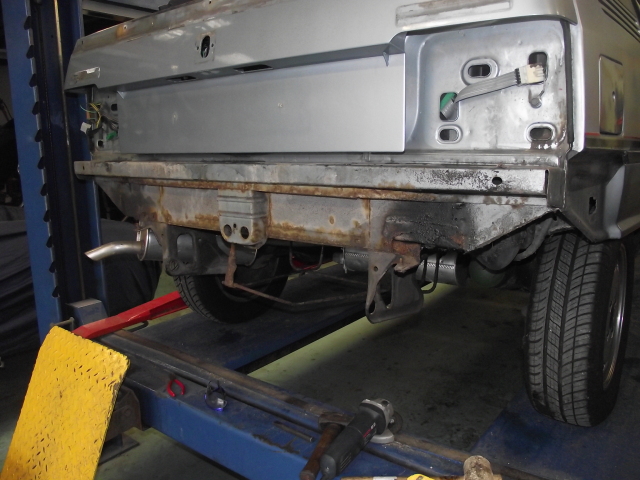

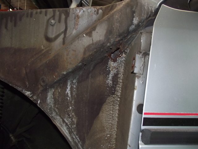

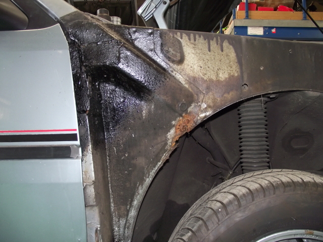

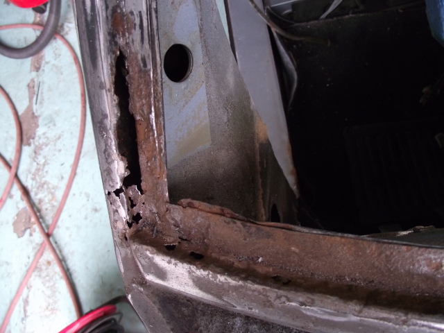

A little bit of rot and some crap repair work, but nothing major found:

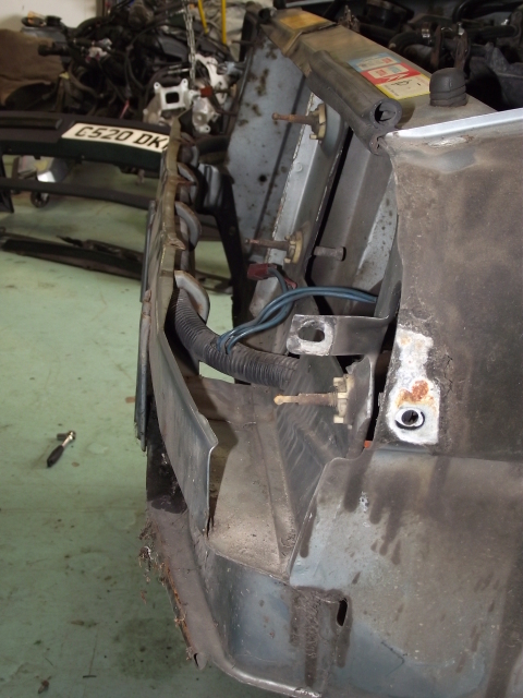

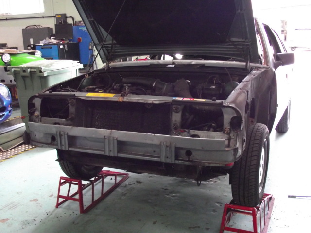

Reason for front bumper looking like a broken nose found:

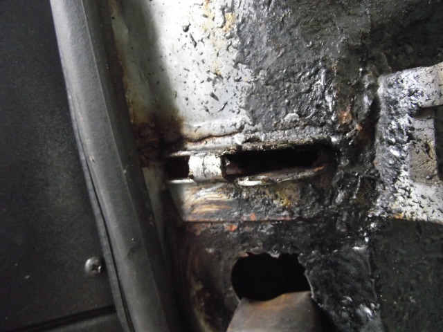

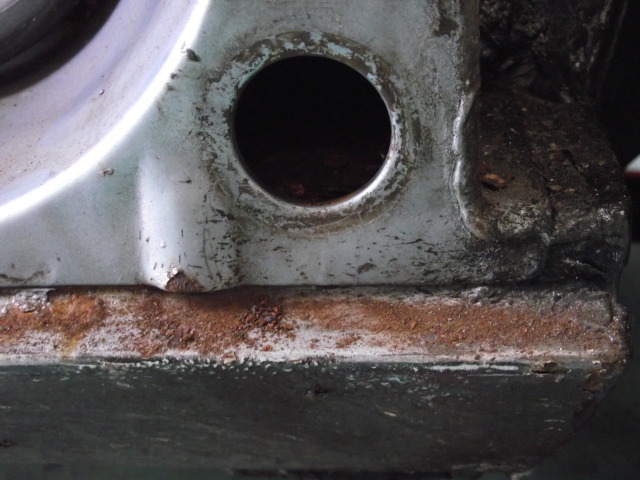

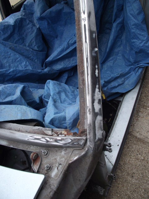

Some of the inner A-pillar:

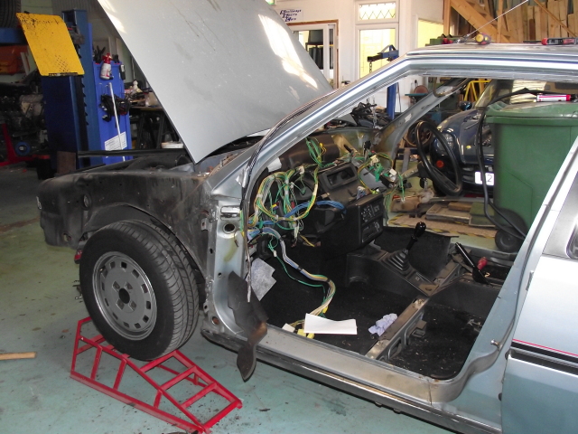

Bastard cable!

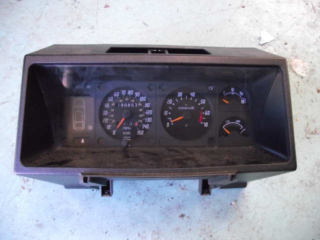

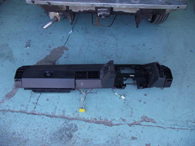

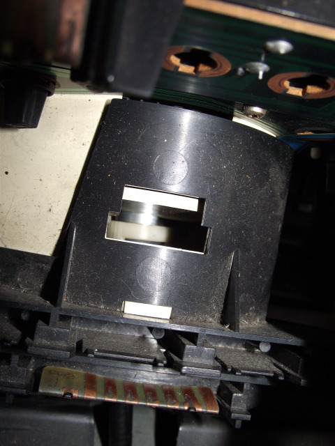

Mk1 dash SO much easier to remove than mk2!

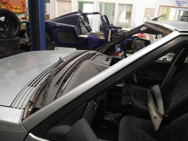

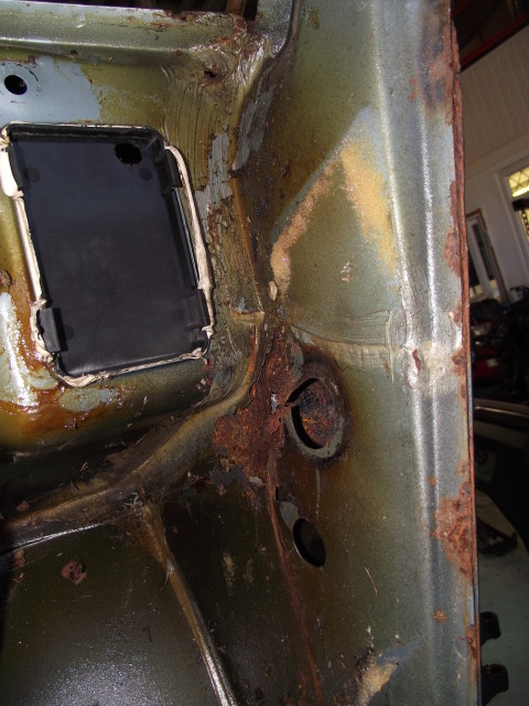

Tinworm found behind dash:
I'll probably have to cut a big hole there to repair the A-pillar from inside.

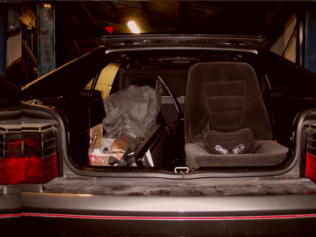

Grey 16v makes good storage area:

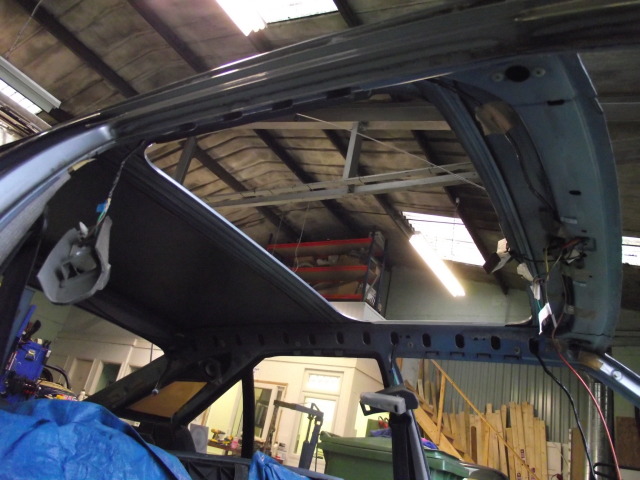

Headlining needs a clean!

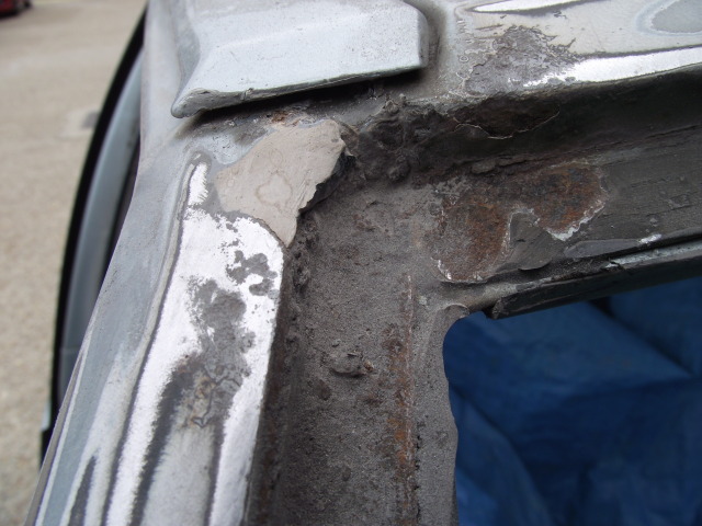

Work begins on repairs to the A-pillars. The amount of filler I'm expecting to find is unknown!
Some there:
Some was there:
And there....
Kurust applied and workshop deserted! Work will recommence tomorrow!

Surely this thread should come with a health warning? - :shock: at those A-pillars

..that_ Looking at what you found there, I'm dreading pulling the windscreen out of Timex 8-[

What kind of job was it to get the headlining out BTW, the DTR one is grubby and the sunroof on my GT only tilts.
When you repaint it you will be amazed how much bluer bleu romantique is, as it seems to be quite prone to fading badly!

Tim Leech wrote:Well done Kitch/Bazza, thats a familiar sight!!, nice to see tanother Mk1 a rebuild now.
Headlining is easy, just remember to open the sunroof and undo the two small screws first!
