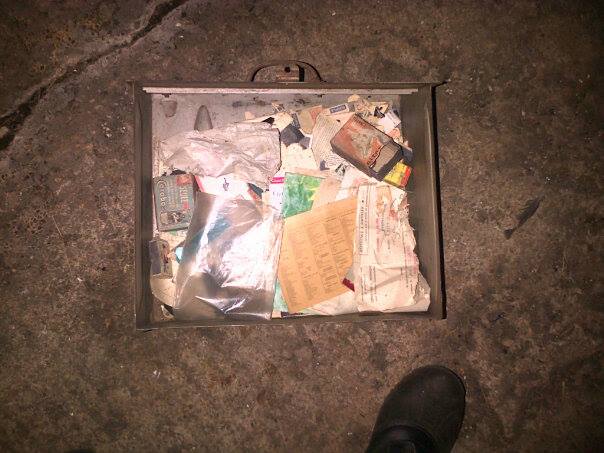

Had a quick look round the pick up, and found these treasures in the cab draw. These included a couple of late 60's brouchures for Fiat 124 and Peugeot 204 (I think), a load of punch time cards, a couple of invoices and a load of leaflets from a vinyard. I suspect the Vinyard was a previous owner, and it looks like this truck came out of service around 1970.
There was also the remains of this sticker on the draw - I'm tryingto find out what the rest looks like as it may help with axle weights etc.

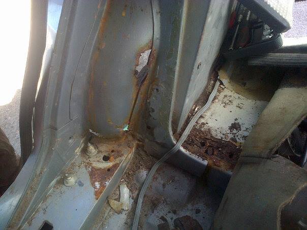

I then removed the cab floor - this all clamps in, and gives fantastic access or working on the truck

As expected, I found some rust:
I cut away the rot at the top of the screen to find more rust underneath

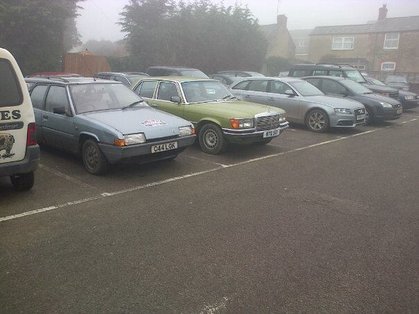

Finally, a quick pic of Timex when I found an even older car to park next to in town:

As the drive shafts would take a day to arrive, I decided to look at the driver's rear arch - this has taken more than a day though!
This bit was easy to spot!
Cut out to reveal more rusty metal
Removed the rear wheel to gain access to the other side and got a surprise!
The bit I'm working on at the time from underneath - all trimmed back
1st piece back in
2nd piece in and closed off
And this repair completed
