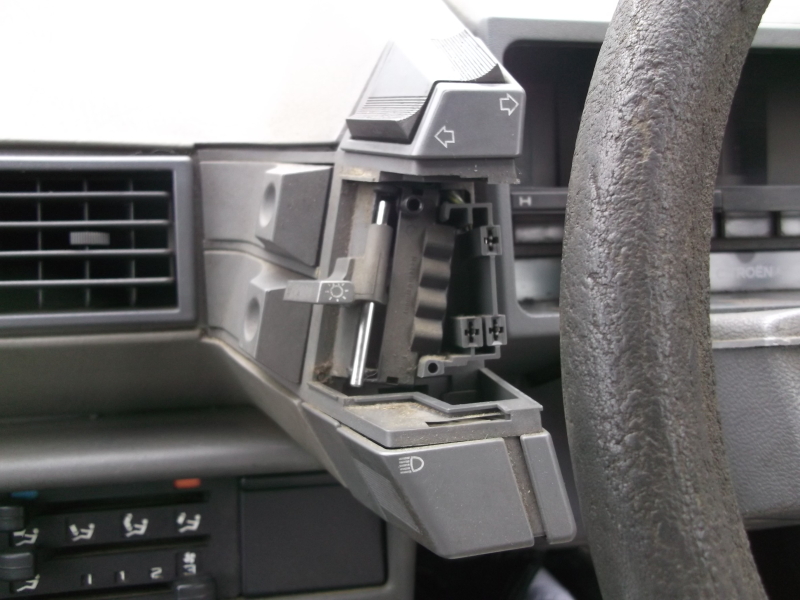

next checked out the headlamp switch, to find this:
The slider rod had come adrift, and some of the contacts in the lever had come adrift. I managed to strip it down and relocate the contacts etc.
Once assembled, it all worked as it should

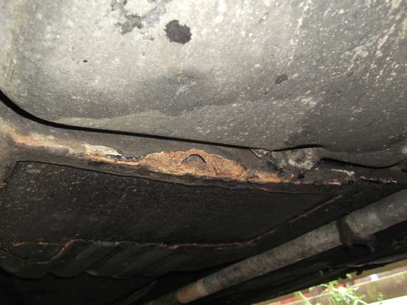

Immediate welding repairs are both front inner wings below the washer bottles, the front of the passenger sill, the rear passenger footwell, and the rear crossmember:

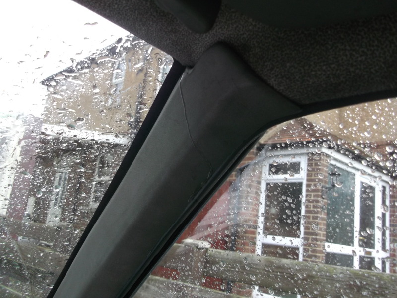

It then started raining, so I hopped in the car and started checking stuff in the Haynes book, until water started dripping on my knee from here:

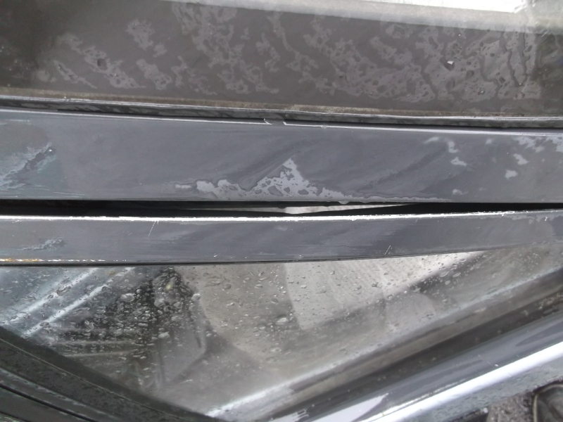

Checking the rest of the car, the front passenger door seal is shot, but the rear passenger door leak is a different issue:
